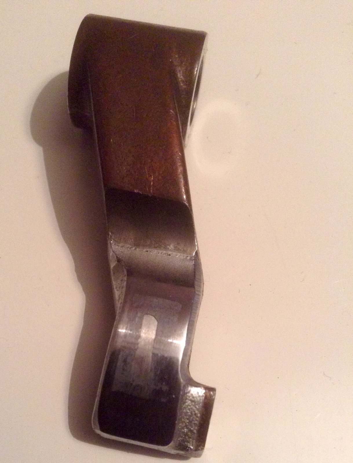

  7. ^ would love to see an image or two of that rocker Carr - particularly the worn area(s). This is nothing to do with a they do wear/they don't wear debate, it's just that it's an area I have a massive interest in.

  17. Hi how much does it cost to get them re chromed, I've got about 5 that need doing.
    Cheers
  18. Cost per rocker last year was around £37.50 from Newman Cams. I should make it clear that it doesn't involve re-chroming but instead face is built up with stellite which is far more stable and long lasting.​
  19. Ah ok thanks So do they grind off all the old chrome?
  20. Here's a pic showing both original and Newman rockers, in both cases (left, right) the Newman rocker is the one on the right;
    As you can see the Newman rockers are a bit wider but fit fine and can't flake, so as long as the brazing holds (never heard of any failures) they should indeed be 'bullet proof'.
