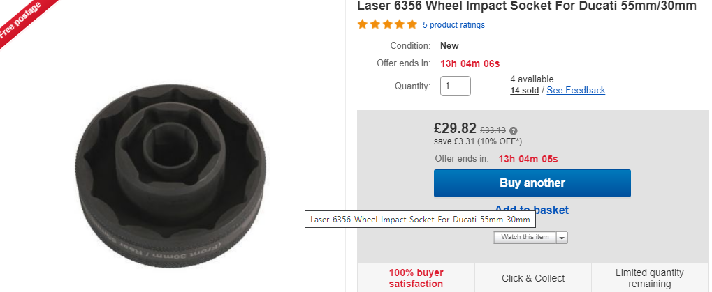

  1. Hi , I am thinking of buying the Clarke impact wrench which I know ;lots on the forum recommend. I am currently using a scaffolding pole at the end of a 55mm socket to remove the rear axle nut. The socket is chrome vanadium and has never slipped. Would I need to buy an impact socket (black type) or has anyone used the Clarke on a chrome socket with success ?
  2. I’d go impact socket. Can be found on fleabay for £15-20
  3. Go for an impact socket. They make them for a reason.

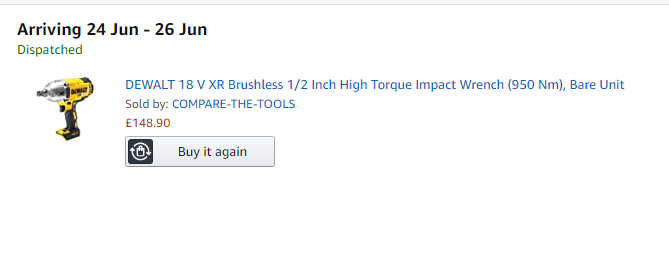

    In the end I went with an Impact Socket.
    Also went for the much more expensive De Walt Impact wrench, but that's just personal preference. I'm sure the Clark will be good enough.

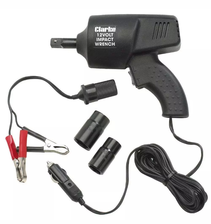

  6. If your going to buy a Impact wrench, spend more money and buy a decent one, i have a clarke one and it utter crap. There is no torque in the thing at all. Took it back and was told it was fine.

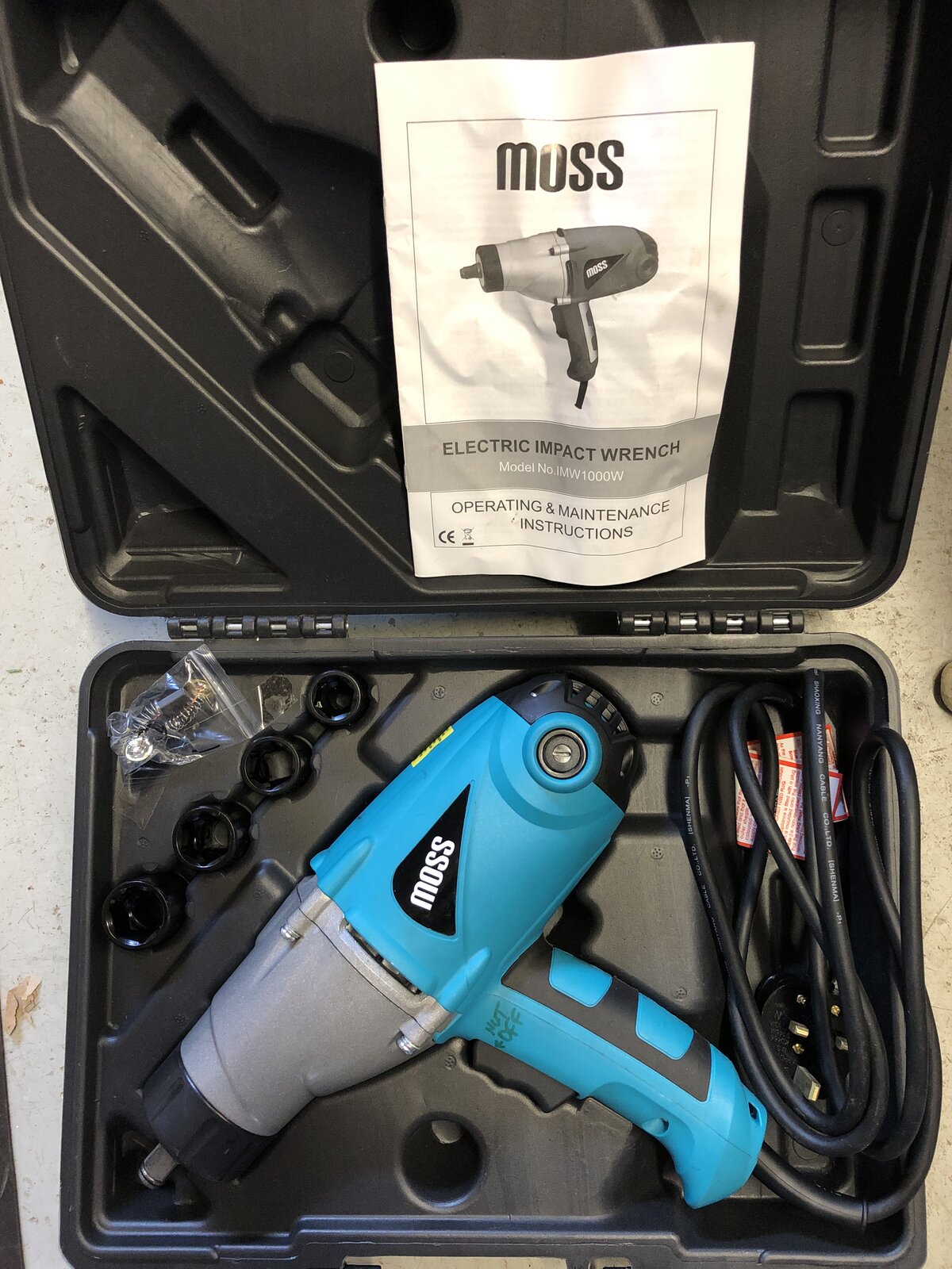

  13. I bought one of these relatively cheapo ones but mine is badged Imdifa and all the instructions are in French.
    I had no trouble loosening the rear wheel nut with it. It's impressively powerful (300Nm claimed) and I'm constantly on the lookout for tight nuts to undo. It's my second favourite tool. I only use impact sockets.

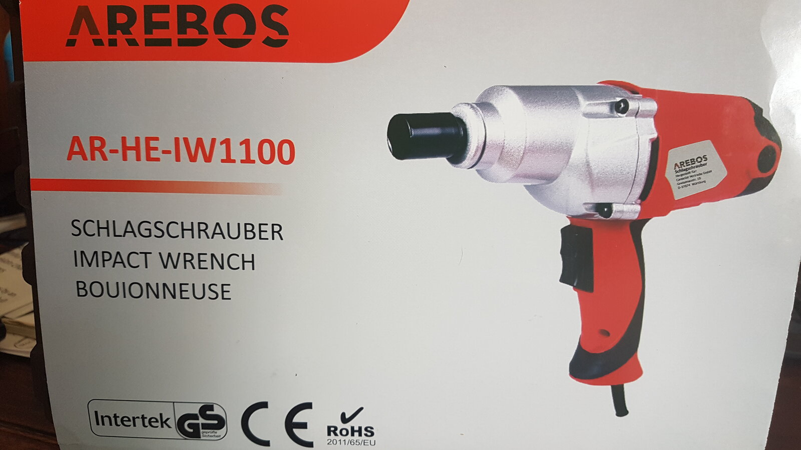

  17. Just got this, Germanic clone, rated 1100W and 550NM, used once to check ability to remove 55mm nuts and worked flawless. Only cost me 40 knicker had a voucher from e of the bay.
