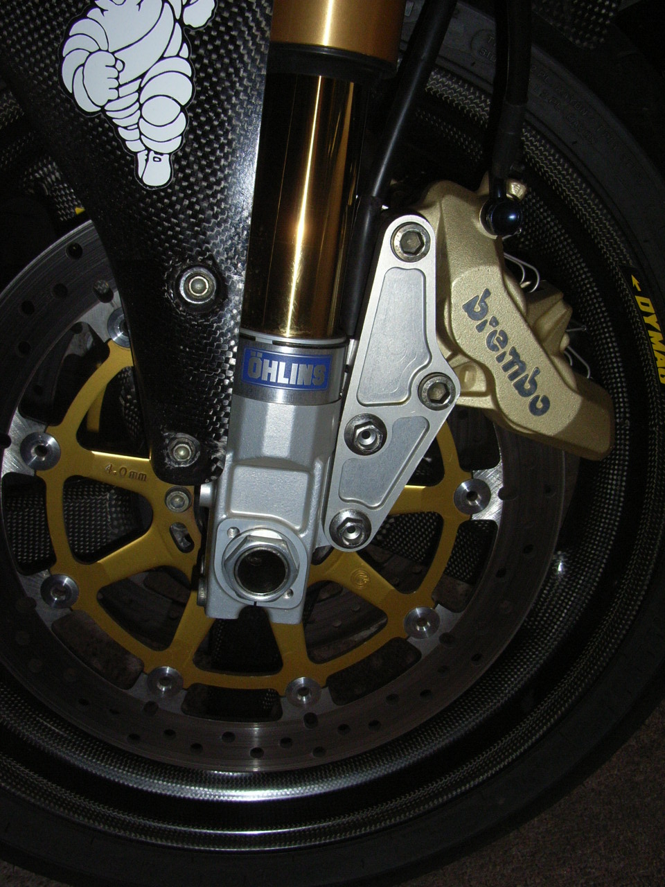

  8. Best thing ive found for the whole bike especially removing stubborn crap around swingarm and brake calipers is SDOC 100 Bike cleaner gel.The only other cleaner I buy is for the chain and that's it.
    Have you considered the 4pad calipers ,good upgrade for the money.
