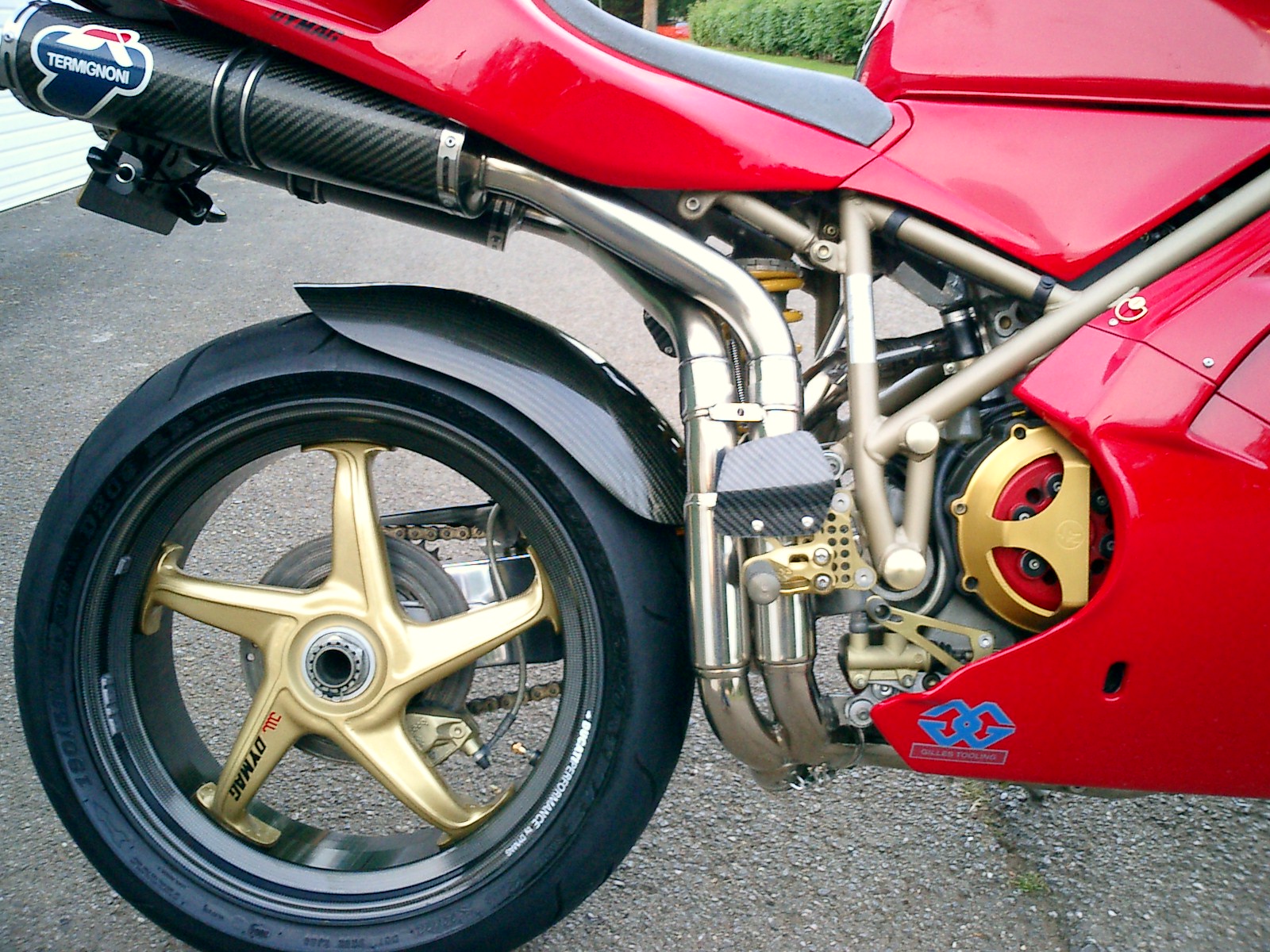

  9. It should to Mel, but the only way to get a shiny finish is lots of elbow grease. The chemical process removes the brown tranish, but then you would need to use a polishing wheel, and/or lots of tedium hand polishing.
    I use a buffing wheel on an adaptor on my bench grinder, which makes a very nice job of it. Probably takes about half an hour to do.
    However, if you use a polishing wheel on a bench grinder, you don't need to use a chemical pickling process, because the polishing wheel takes off all the tarnish anyway.

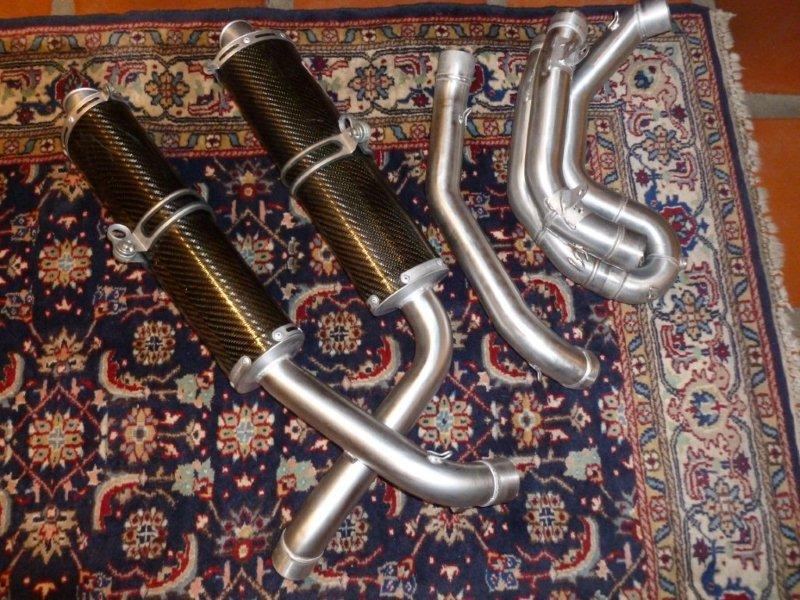

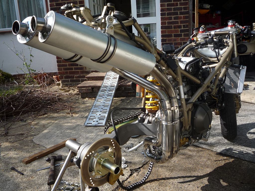

    Took me about an hour and a half to do my pipes a couple of years back using a mop and compound on an electric drill. Very easy quite quick and relatively cheap to do.
  16. From the ramp Hugh, looks like you did the rebuild in the hall!
  17. Not quite, mostly in the living room where a lot of my work gets done and where several of my bikes live when not in use.
