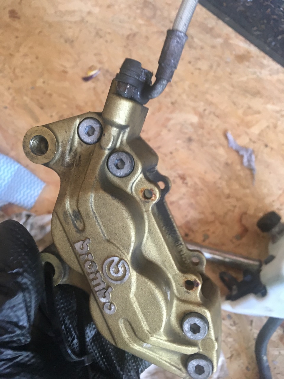

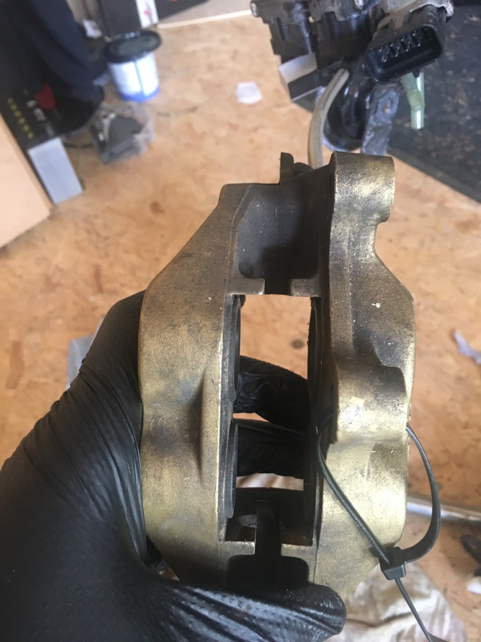

I used a commercial heavy duty floor cleaner/degreaser (called Lift100 or something, left over from a previous life) and applied it direct with a toothbrush, agitated it, then started dipping the toothbrush in a jar of water and scrubbed it some more, finally sprayed it off with clean water from a hand spray (repurposed household cleaner bottle) and wiped dry. Mine came up OK. Admittedly they actually weren't to bad to start with. I was tempted to use WD40 or paraffin which I reckon would shift the muck but you'd have to make sure it was all removed.
personally i would just hand em over to the powder coater and get em refinished in black for about 30 quid a calliper. then keep on top of the cleaning.
You might try gunk, and use a dremmel with nylon brush attachment (eBay) to get the crap off once its soaked in for ten minutes or so. Shouldn't be a big problem, mine weren't!
I remember freely using trichloroethylene to degrease components when at work. Others used it while smoking..
If it's baked on brake dust you are referring to.....then Bilt Hamber Auto Wheels....may need a few hits but there's no wheel I've had which has not been completely decontaminated with this stuff....it will turn purple indicated it is dissolving the ferrous metal particles...
