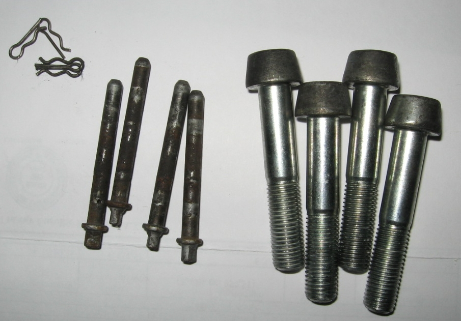

    I have just completed cleaning my front brakes and I have the procedure recorded in video. The main reason for it was the quite extreme vibrations I had when braking. I believe that nobody took the time in the past to do a good cleaning. So I hoped that the vibrations would go away by making the pistons in the calipers work as they should. Unfortunately I haven't tested the bike in high speeds (I've only done 3-4kms in town. It's pouring for two days now). So I'm yet to witness the results of my efforts. Nevertheless, I'd like to share the experience for those of you that want to do something similar and don't know where to start. The idea was to do as much cleaning as possible without disassembling the calipers and the pistons. I didn't want to spend two months old RBF 660 fluid nor the time I've devoted in bleeding the system (it is rock solid now). In the videos I explain pretty much everything I did.
    You may see the appearance of the pads to be a little "glazed". I didn't feel it needs attention so I didn't even sand them, since I didn't have any problem with the "bite" of my brakes. However, you could argue that they will perform even better if I did.
    You can also see the result of the cleaning of the retaining pins (before and after pictures of the cleaning with a Dremel wire brush). I also cleaned the button rivets on the rotors following the procedure I've seen on other videos and using only brake cleaner (not oil as some people suggest).
