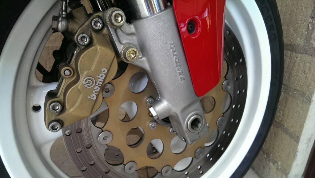

    It's great for cleaning fork leg bottoms too but make sure you mask off the chrome sliders. I haven't got a close up pic to hand but you should be able to zoom in.

  9. Thanks. Hopefully here's a better pic. They're looking grubby now as I've done a few miles since the rebuild
