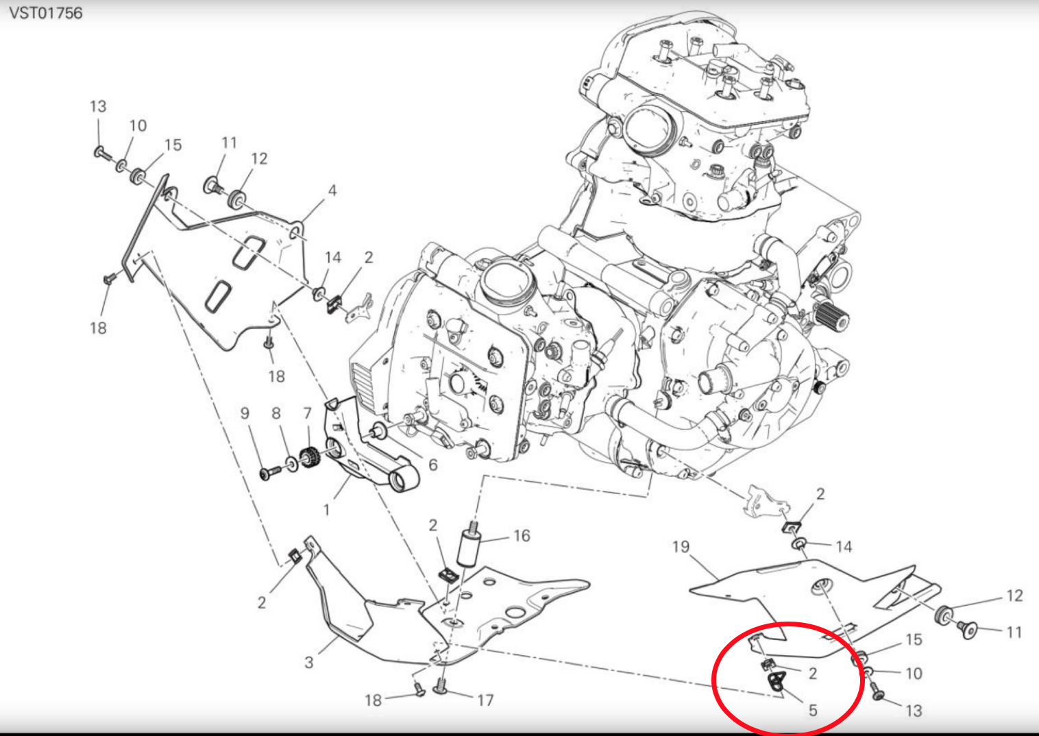

  9. Is it this one in the picture (5). It's listed as a "cable guide" :thinkingface:

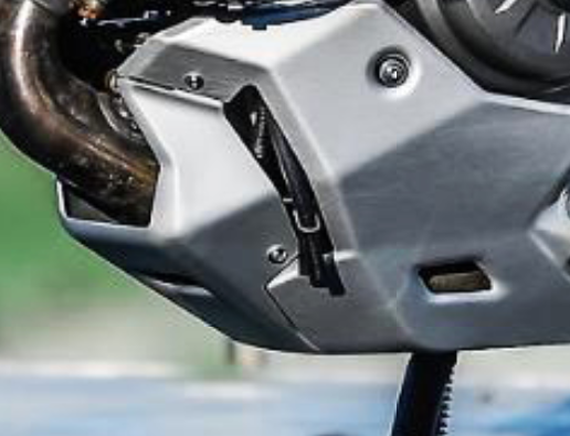

    Roberano shows it best. It is that bolt, but between the inner belly pan peice and the outer, with a fastner clip
  11. Ahh, I'd ruled out that cable guide since it didn't look like the right shape when I zoomed in. Thanks very much @Robarano
    And thanks @JH_1986 for the decent close up pic. It's strange as the engle of that clip, unless mine got bend, doesn't seem like it'd go to that bolt in the diagram.
    I'm hoping I can re-fix it by just taking off the right hand side bit of that guard. Hopefully it'll all become clearer when I get home.
  12. That's how I thought it wold be located, from the inside. :) :upyeah:
    Useful pic.
