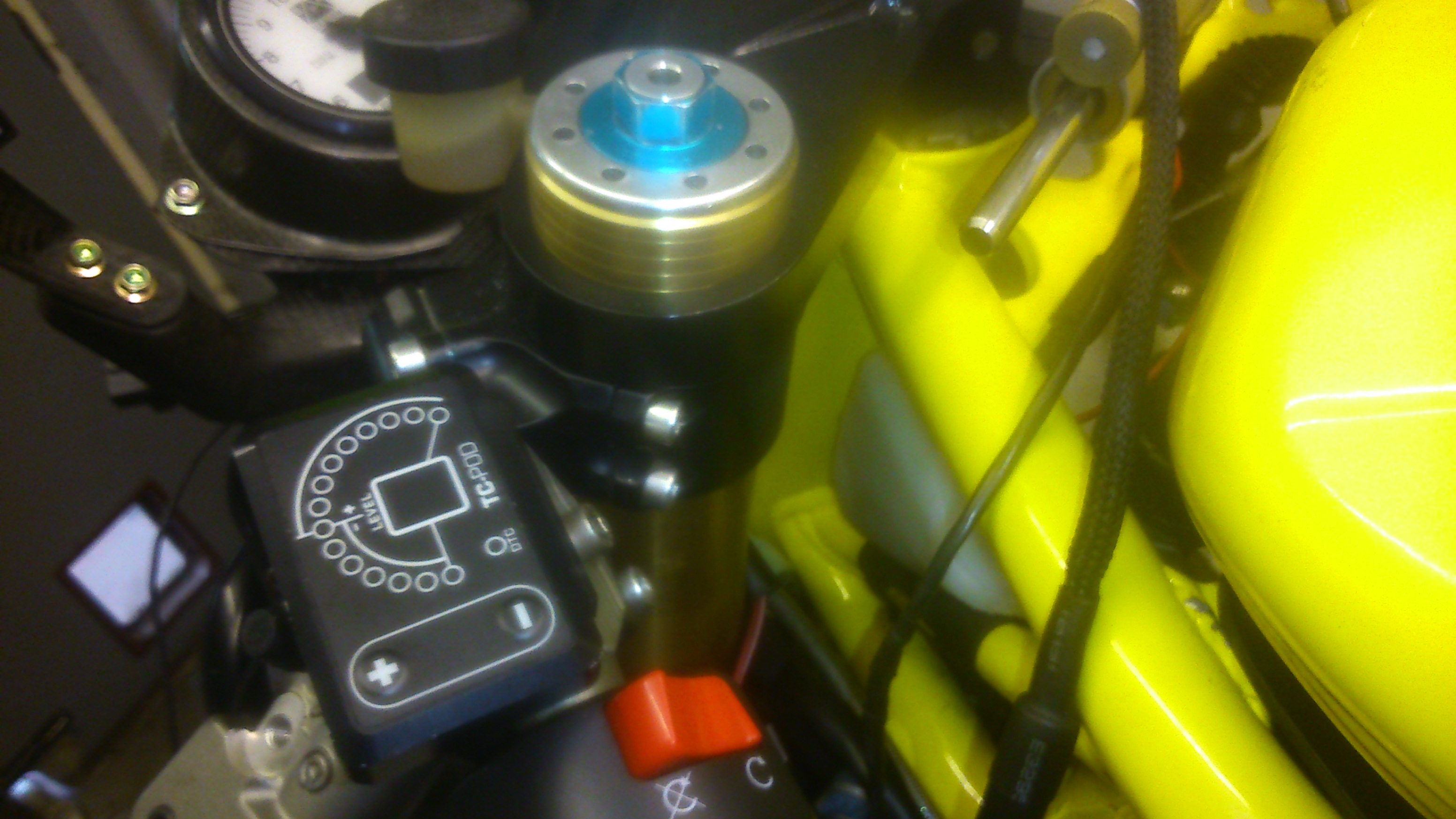

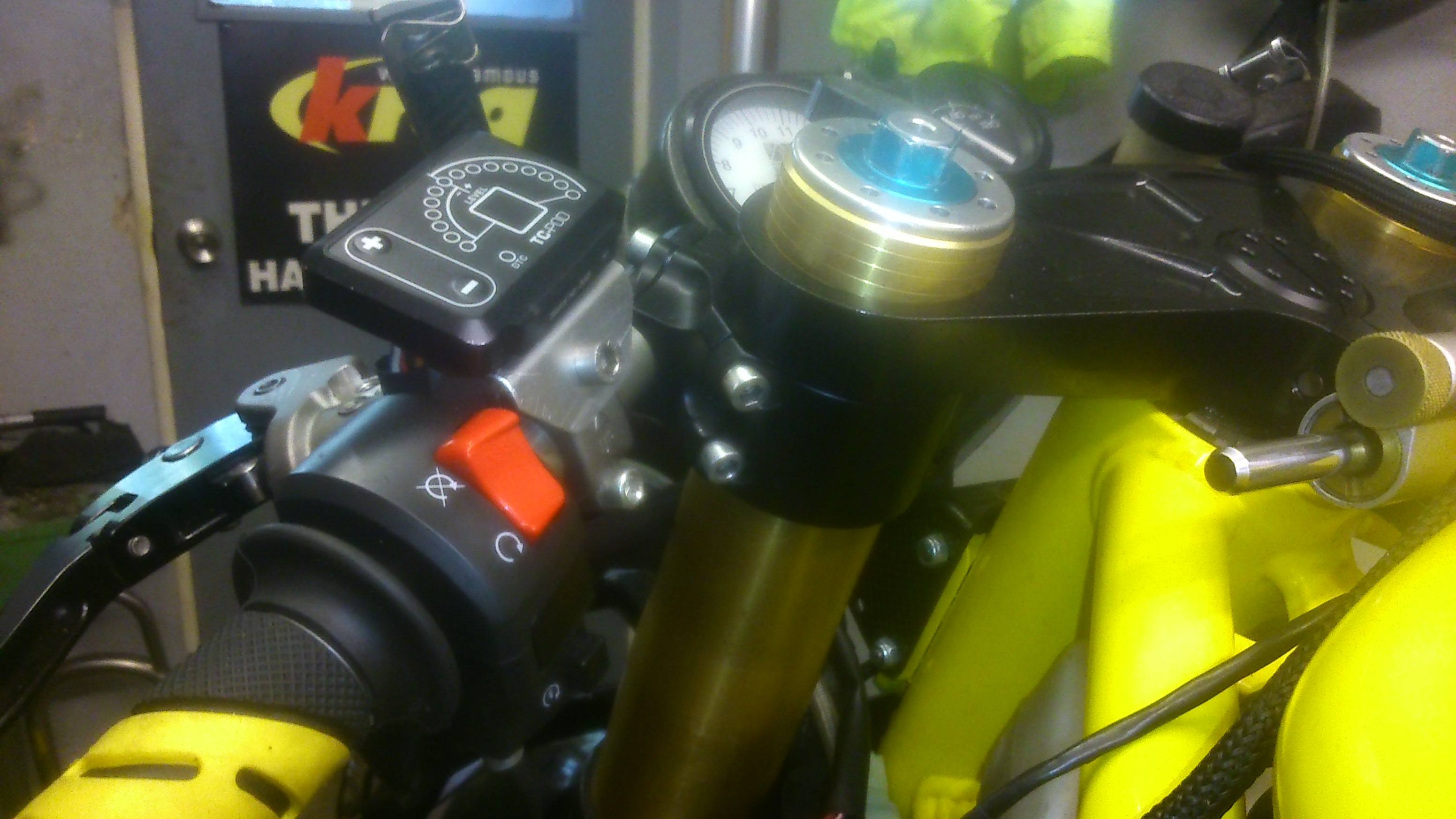

  14. Have woodcraft ones... that's the prob! They looked the dogs, but after fitting the front fairing and sitting on the bike it seems they hit the frame on full lock and if adjusted forward to where they miss it (by 2mm) its not a great position at all and the controls scrape the fairing and hit the clocks!

  15. Hmmm -something not right. On full lock there should be a gap about fist width between bar and tank.
  16. Just looked at your build thread - you have the clipons on the wrong side !!!!!!!!! That why they are fouling. Take them off and swap over and turn them over. all will be fine then
  17. The bars clear the tank no prob, its the clip on itself (the bulbous bit where the bolts go in) that hits the frame just below the front of the tank before it hits the stop. i can rotate them further forward to gain minimal clearance of the frame but it then fouls the fairing/clocks well before full lock.
    • Nuke Post Nuke Post x 1
  18. if they where reversed that bars would be the wrong way up no? I think i know what you mean!!! i'd need to push the bars through as well... I think bike isn't handy but that could well make sense
