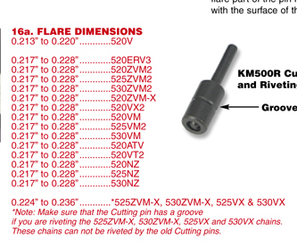

    I have had to do some in depth research with DID chains and I found a small section (somewhere, which I will post if I can relocate it) which DID give the diameter range each of their chains' soft link has to achieve to be correctly riveted.......
    So......if funky didn't fit the chain, and it is found to be wrongly riveted, has he got any recourse over who fitted it? I doubt it......but it may be worth exploring.............BAck when I have found it.........unless someone has it already to hand.

  18. Here are the DID rivet link flair dimensions....
    BTW, DID state do not use a brush to clean the chain as it can damage the O rings.........
    ...........so how are are you expected to clean the crap out between the plates?
    AL
