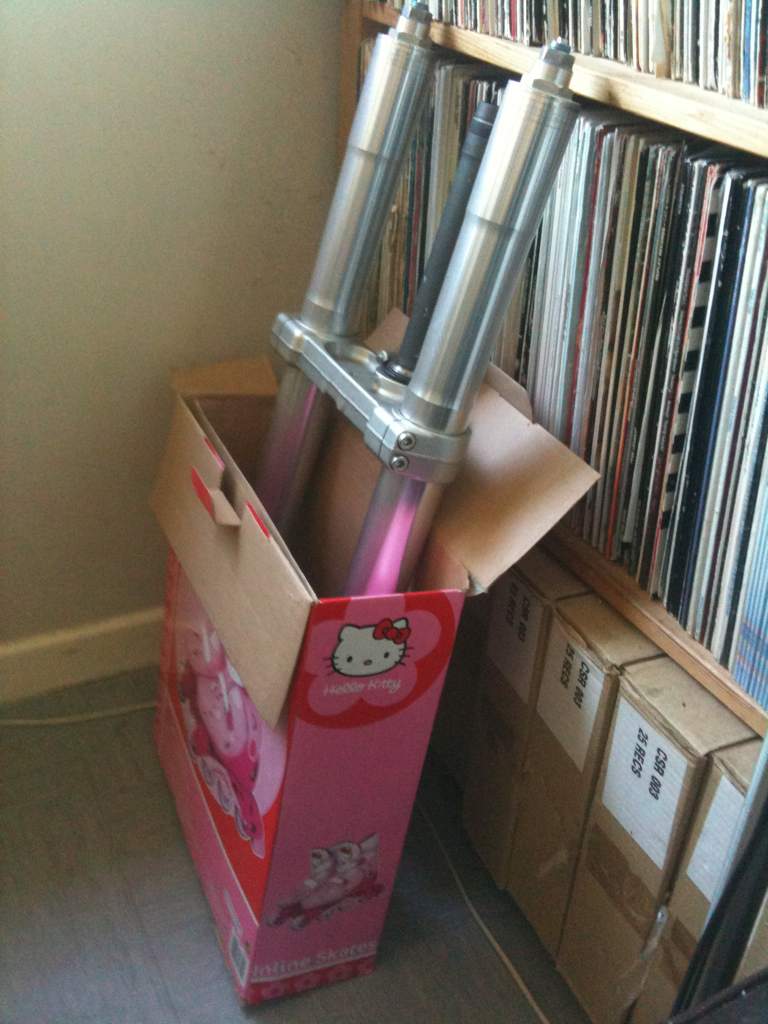

  15. I'm in tue process of finding out what my 749 clunk is, although I think mine is either the wheel bearing, head bearings or fork bushes.
    I've bought some Hello Kitty forks just in case it is the bushes.
