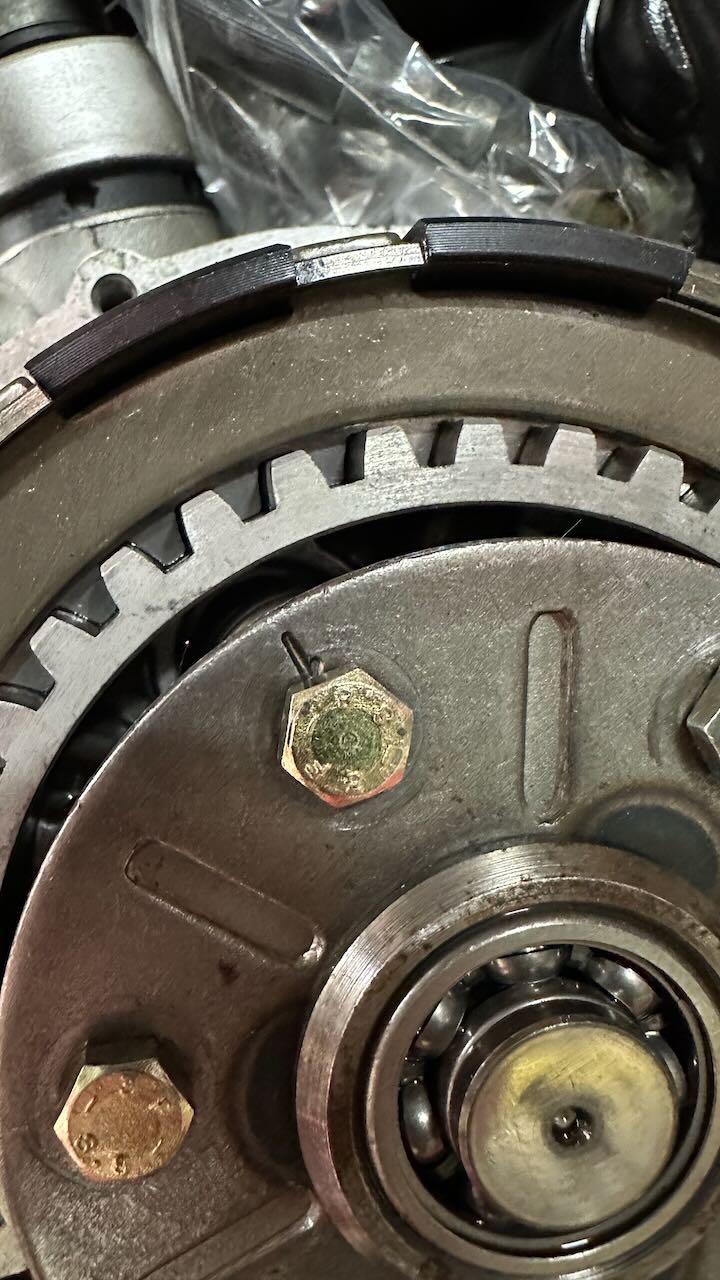

  1. I snapped three bolts, thinking I was torquing them up.
    I'm super annoyed with myself. What is the torque setting for these? I had my wrench set at 32Nm.

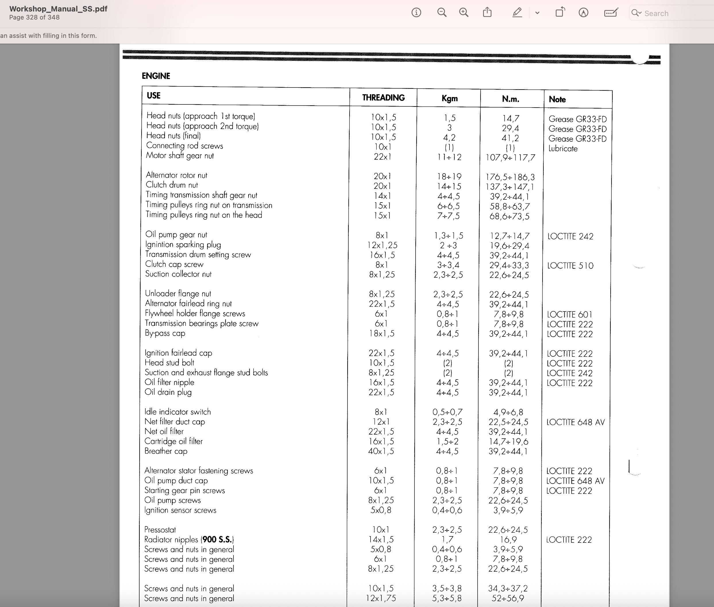

  2. I think I got the wrong torque setting out of the Haynes manual.

  6. They look like M6? Probably no more than 10 nm.
  7. I think you did, gurth. Didn’t you think it was a tad high after the first one snapped?
  8. I thought it was the torque wench clicking. It’s only after I finished and stood back did a head drop off.
  9. Eeeek… o_O
