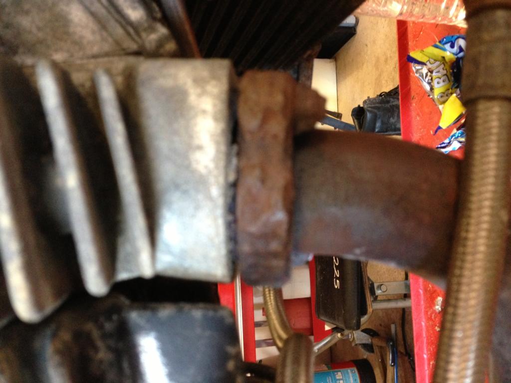

  7. Went to Gtec and they advised using a used 1098 slave (which they kindly supplied for £10 as new). Now however my lower cylinder feckin exhaust studs and bolts appear to have been eaten by a rust monster grrr. Delaying my winter strip (Nuts aren't even 13mm anymore and just bare a passing resemblance to a half eaten dark toffee)
    Stud removers ordered
