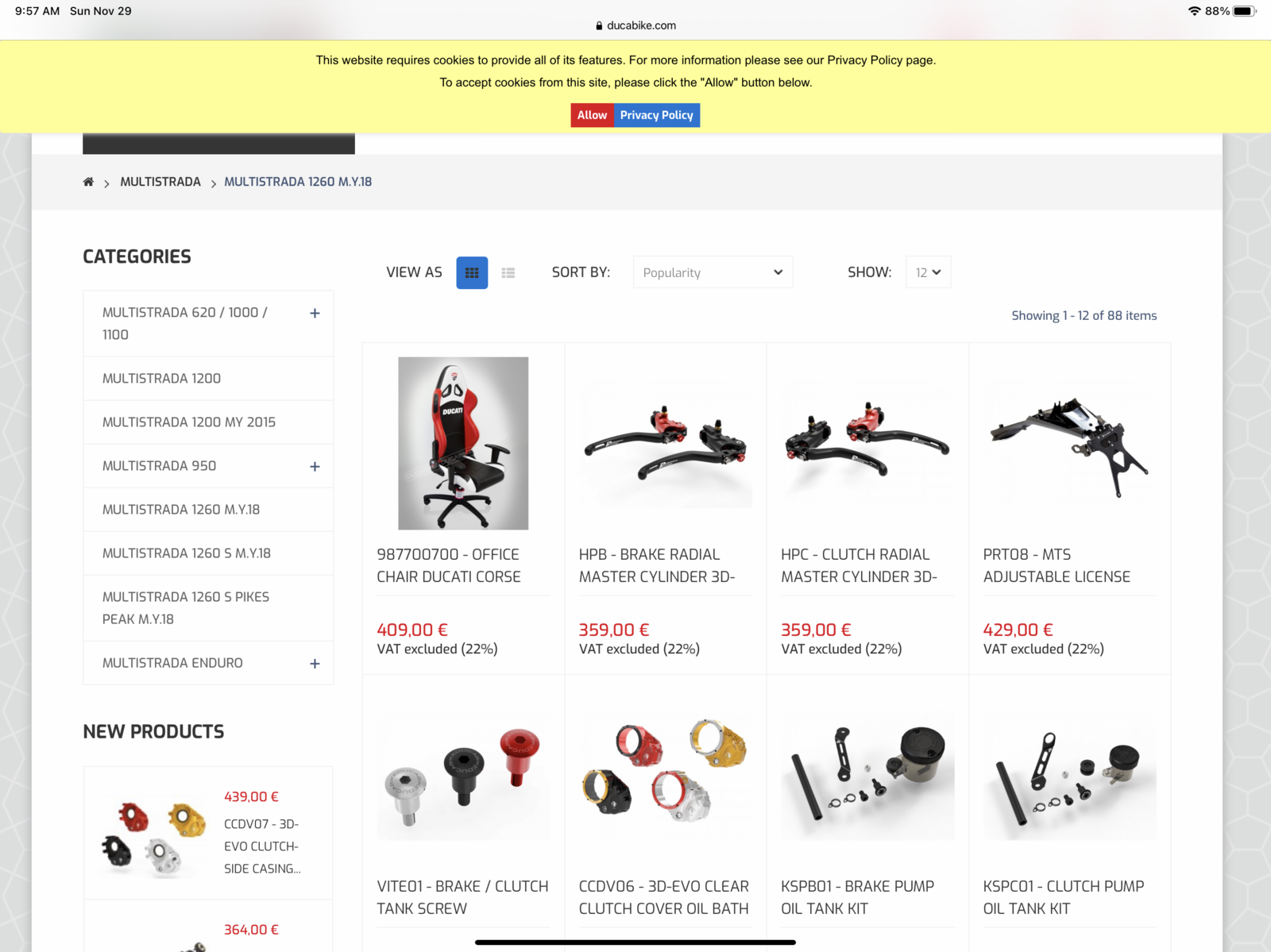

  6. Same cover 1200 or 1260?
    The site only seems to list the 1200.
  7. I see it when I look for 1260 parts. Here’s a screenshot, it’s in the middle at the bottom, part CCDV06.
