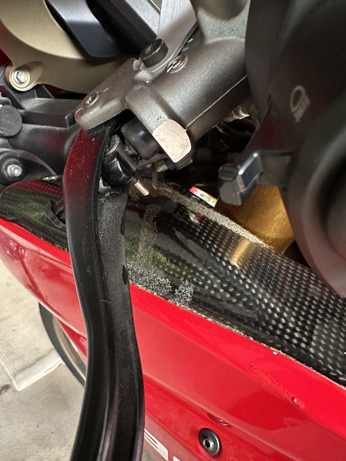

  5. Turns out it’s leaking somewhere at the master cylinder. Made a right mess of the carbon fiber clear coat ☹️
  6. Oh dear, not good.
    On a positive note…no need to buy an Oberon!
  7. that's a real shame, no obvious leak on the floor but a clear one next to the reservoir. I hope it's only the top lacquer that's affected.
  8. there is a rebuild kit for the clutch pump.
