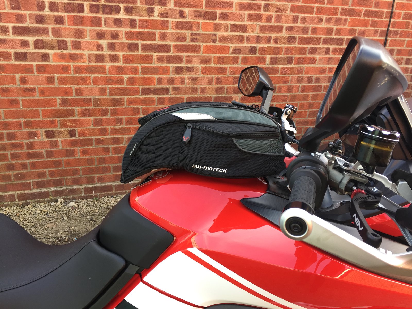

  7. I swear by ASV's these are the long ones but they do short ones.
