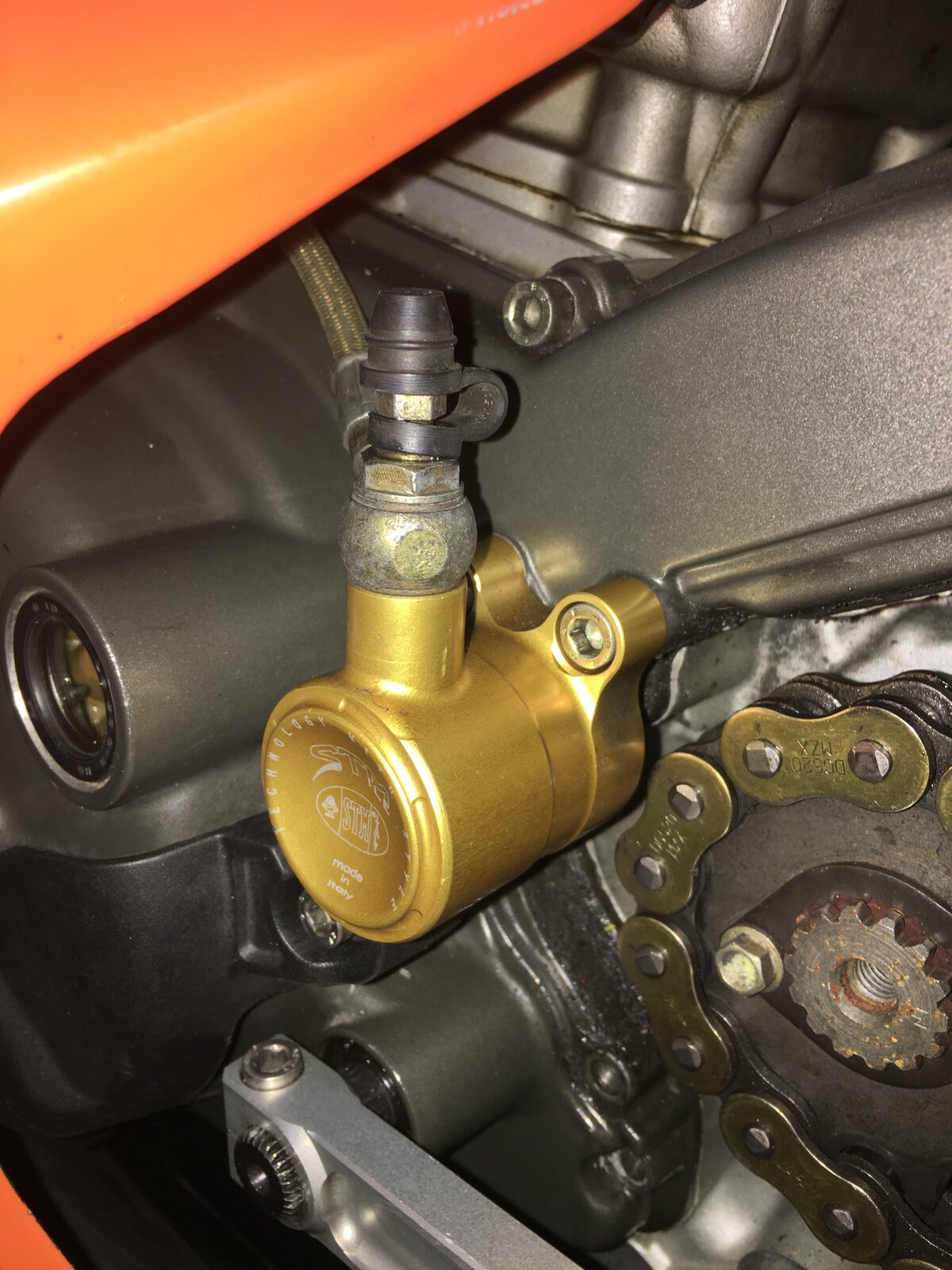

  1. OK, so a pal of mine has rebuilt a 748R. He noticed on purchase that the clutch lever fun point was at average hand span distance away from the bar, but figured that since he was fitting a sparkling new adjustable (different spring options) Ducabike slipper that in the end all would end up fine.
    Well it ain't, the lever still needs to travel nearly it's full reach before you get any joy. Mainly a problem in 1st, 2nd both up and down. Tried an adjustable aftermarket job but no use.
    I'm thinking slave cylinder (???) and so he's thinking about getting a Ducabike or Oberon job to fix the problem.
    Any advice appreciated and yeah I know clutches on the 748 ain't friendly at the best of times but this one is a @#$*^%$ !! :)
  2. IMO, Oberon is the go to aftermarket replacement slave cylinder. I have one on my 748R. Andy
  3. You agree with my diagnosis then? o_O
  4. Most likely, yes. Andy
