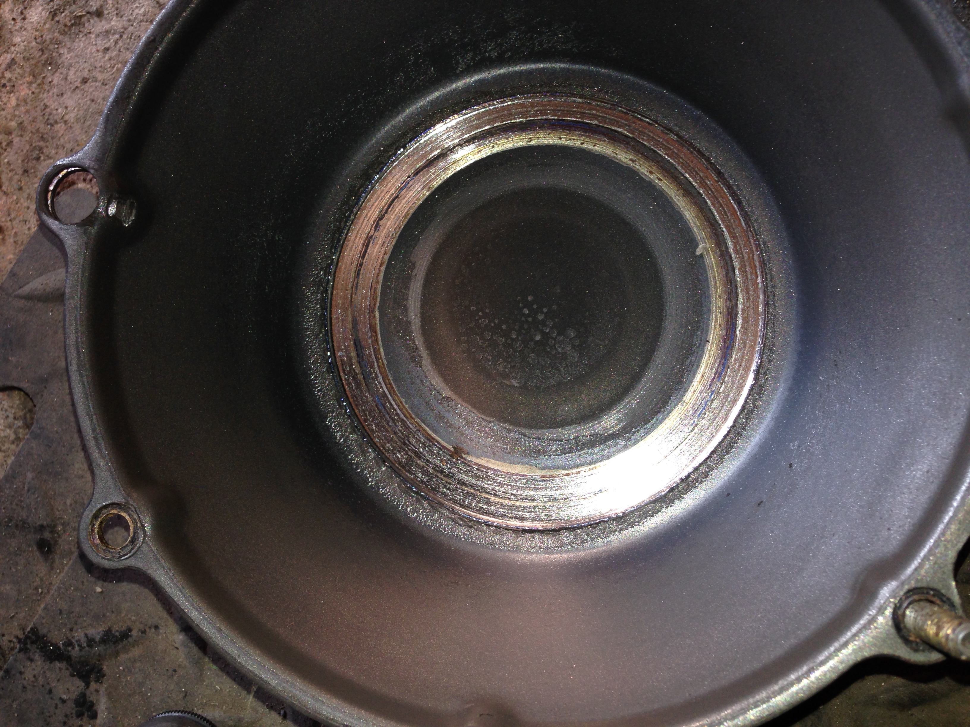

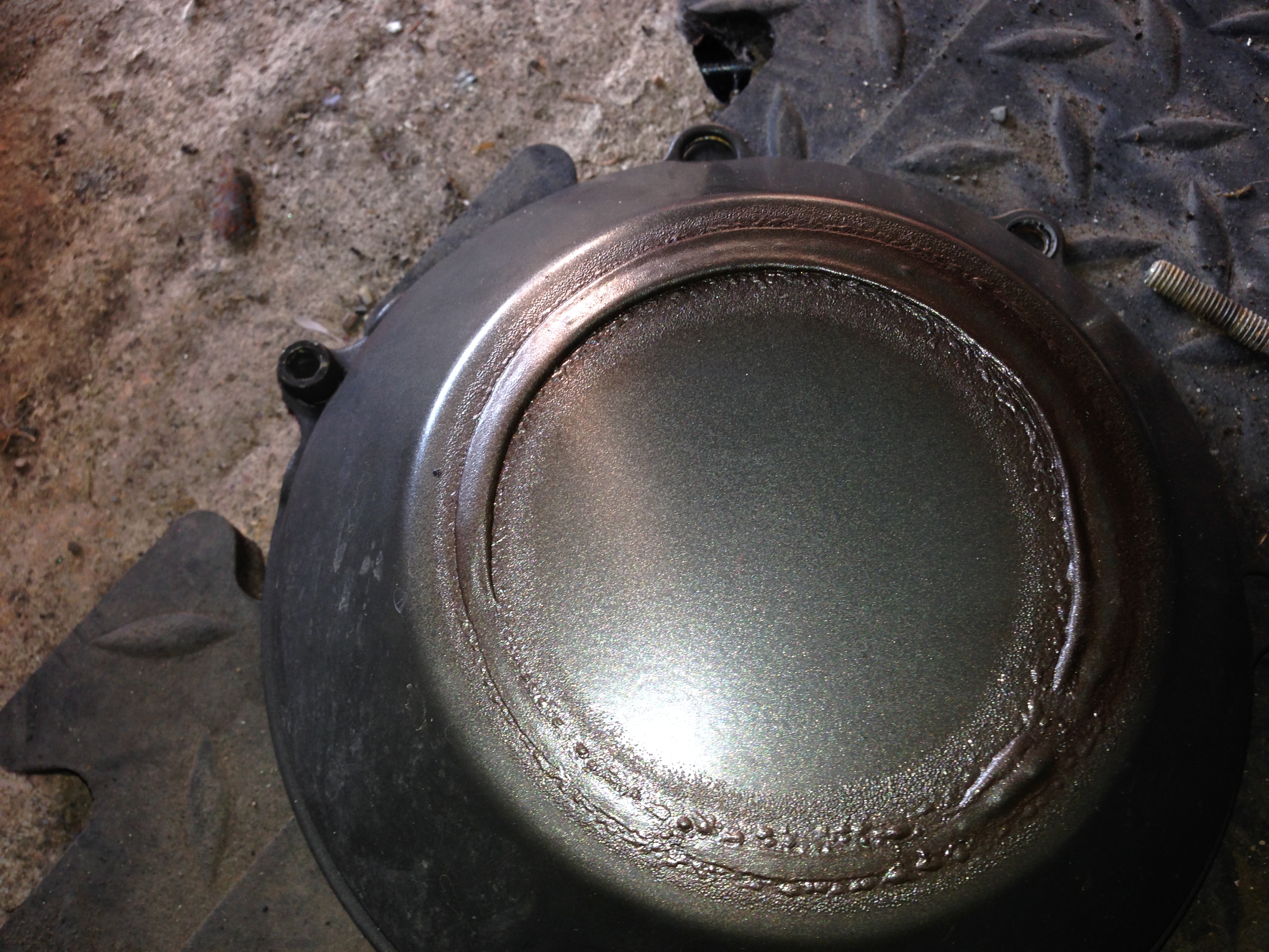

  1. after just doing the header tank for the second time in two months, coming back from a ride, and the bike wouldnt go into nutral and was making a funny noise. manage to limp it home to see the clutch cover burnt. Took cover off, and some plates were not in the basket and it seemed that the springs had been rubbing the inside of the cover. I was told years ago, by a ducati mechanic, that he used to prize out the needle roller bearing on the pushrod, as they always seize. I suspect that this is what has happened to me. I know i will have to drop the oil and take off the left hand crank cover, but is there anything i should look out for or can i just smack it out toward the slave side and how do i make sure that i have got all of the bearing out??
  2. The symptoms you describe sounds like the hub nut is loose and causing the hub/plates etc. to work out into the cover.

    I had a new clutch fitted by a Ducati dealer after a crash some years ago and the hub nut came undone on the first rideout after less than 50 miles (obviously wasn't torqued). Resulted in the hub/plates/springs etc working out into the clutch cover, initially I lost the ability to disengage the clutch but as I was close to home I carried on, trying to get back. Finally the cover (Carbon Fibre) gave out and the entire hub assembly was ejected into the side fairing and the rubber cush drives fell onto the road.

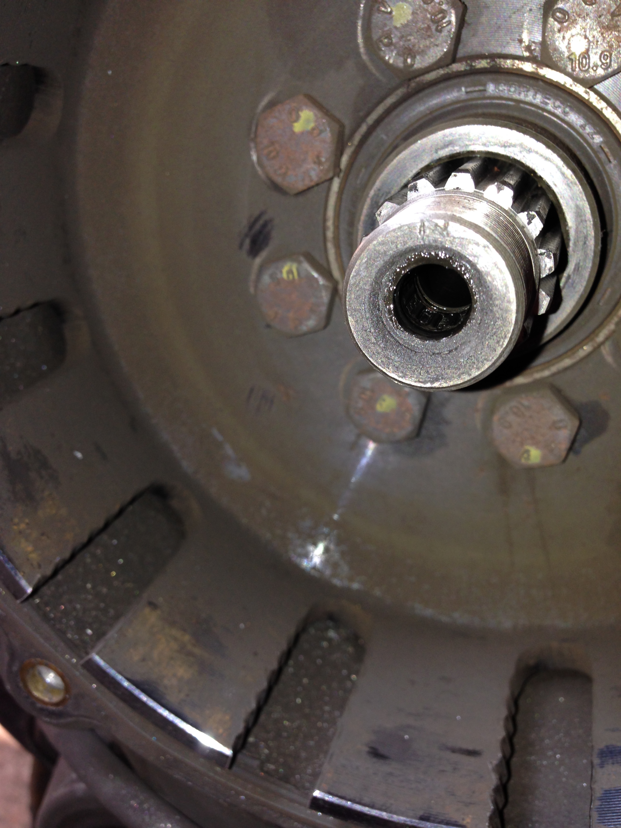

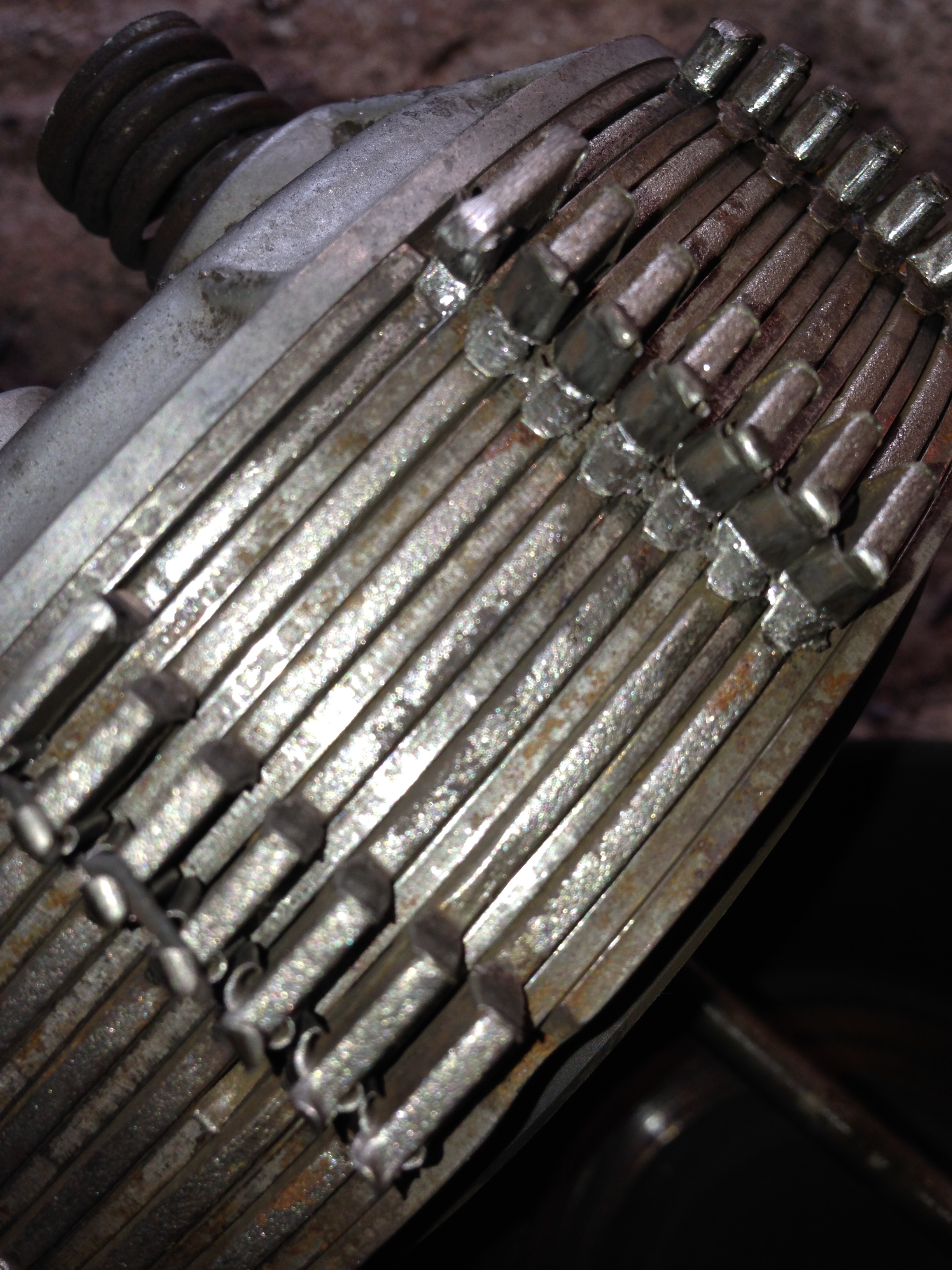

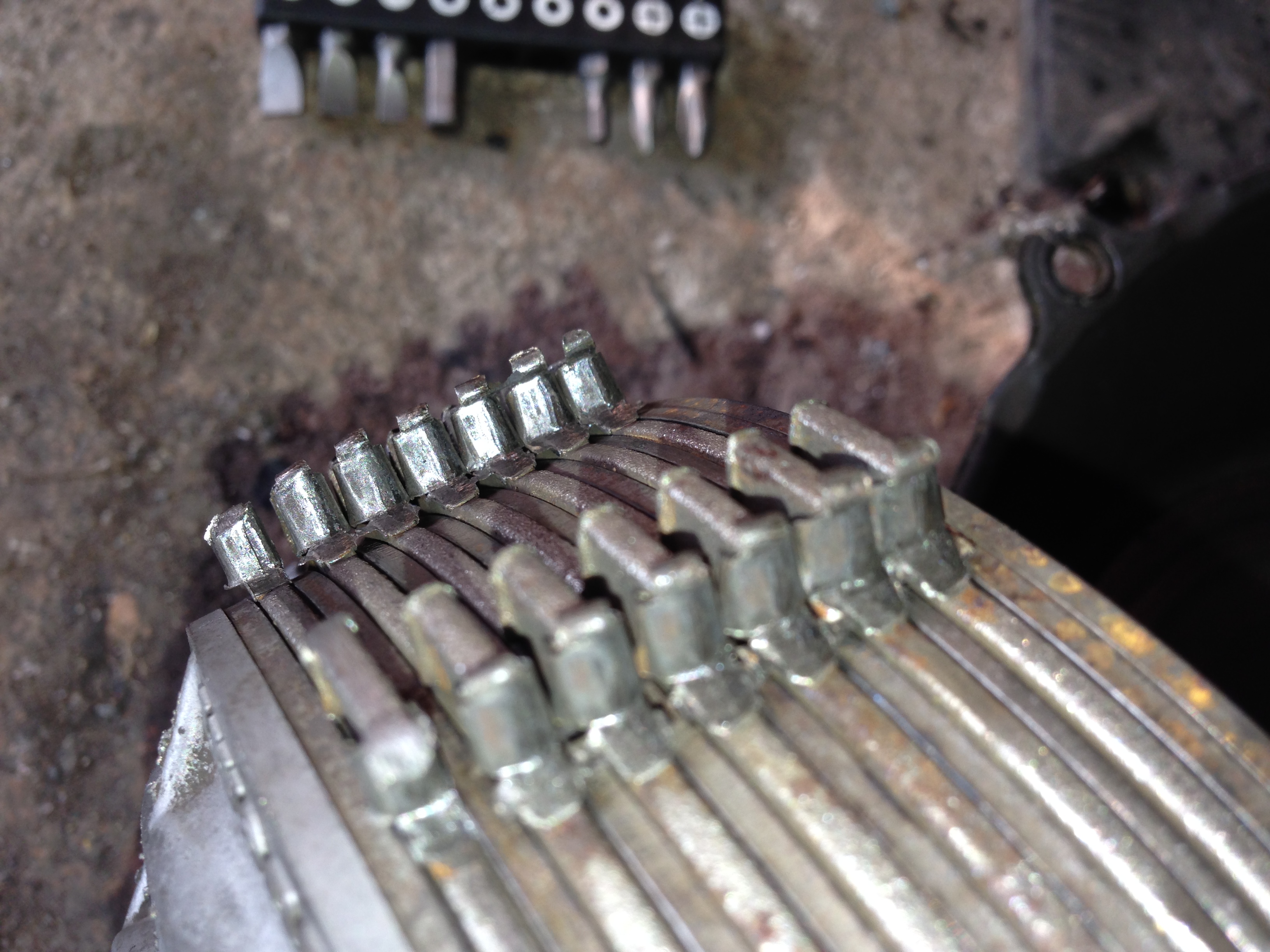

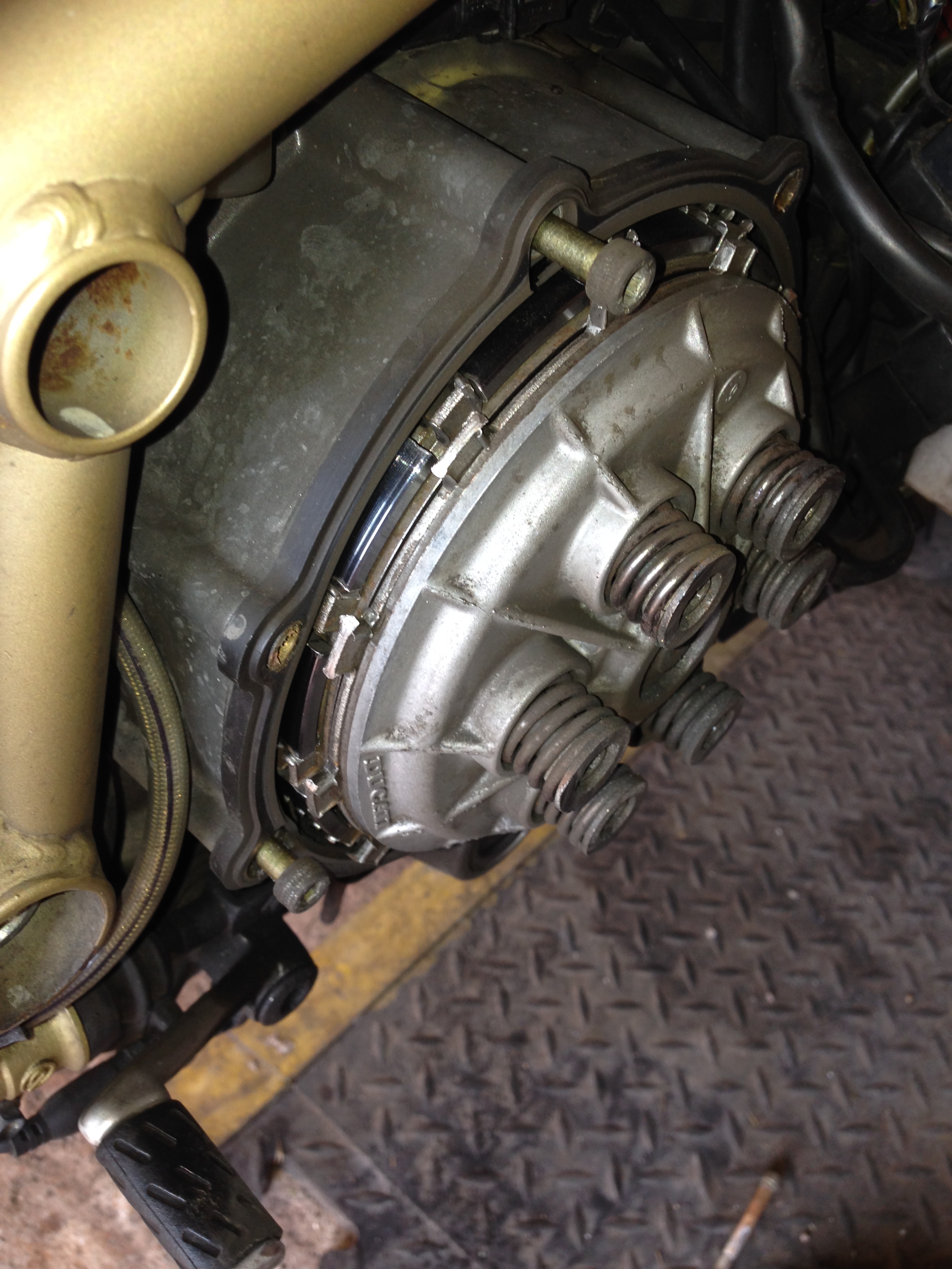

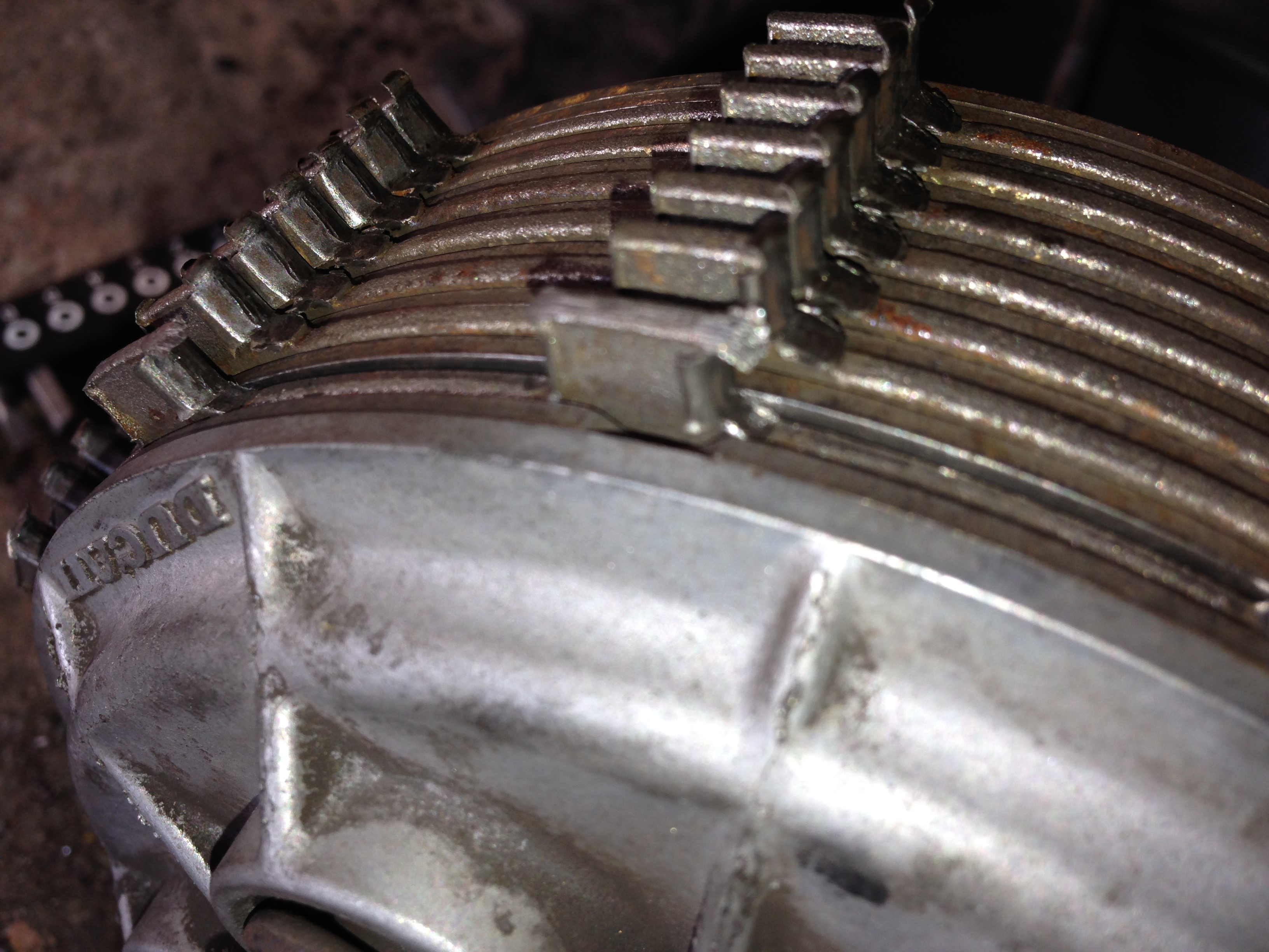

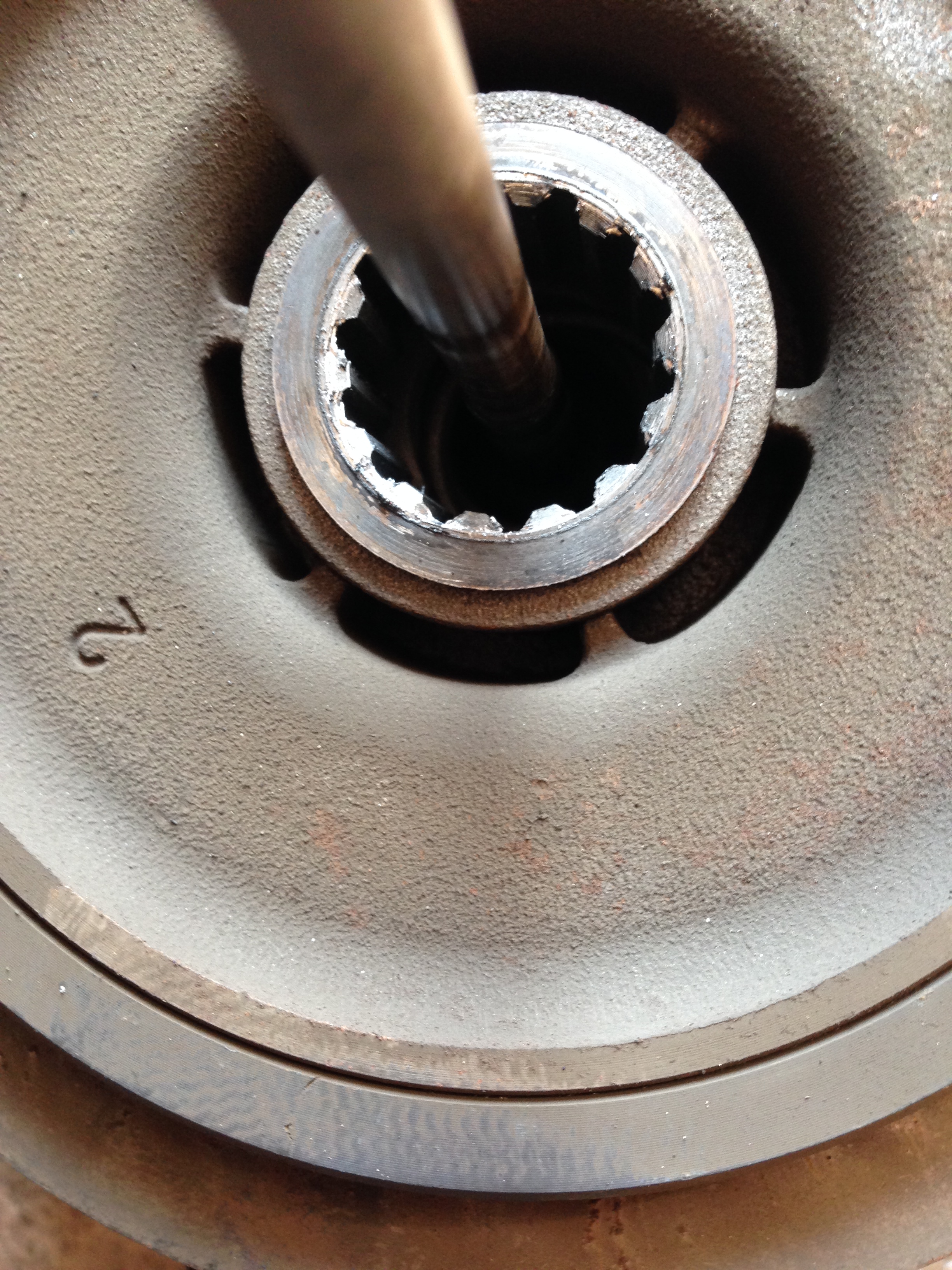

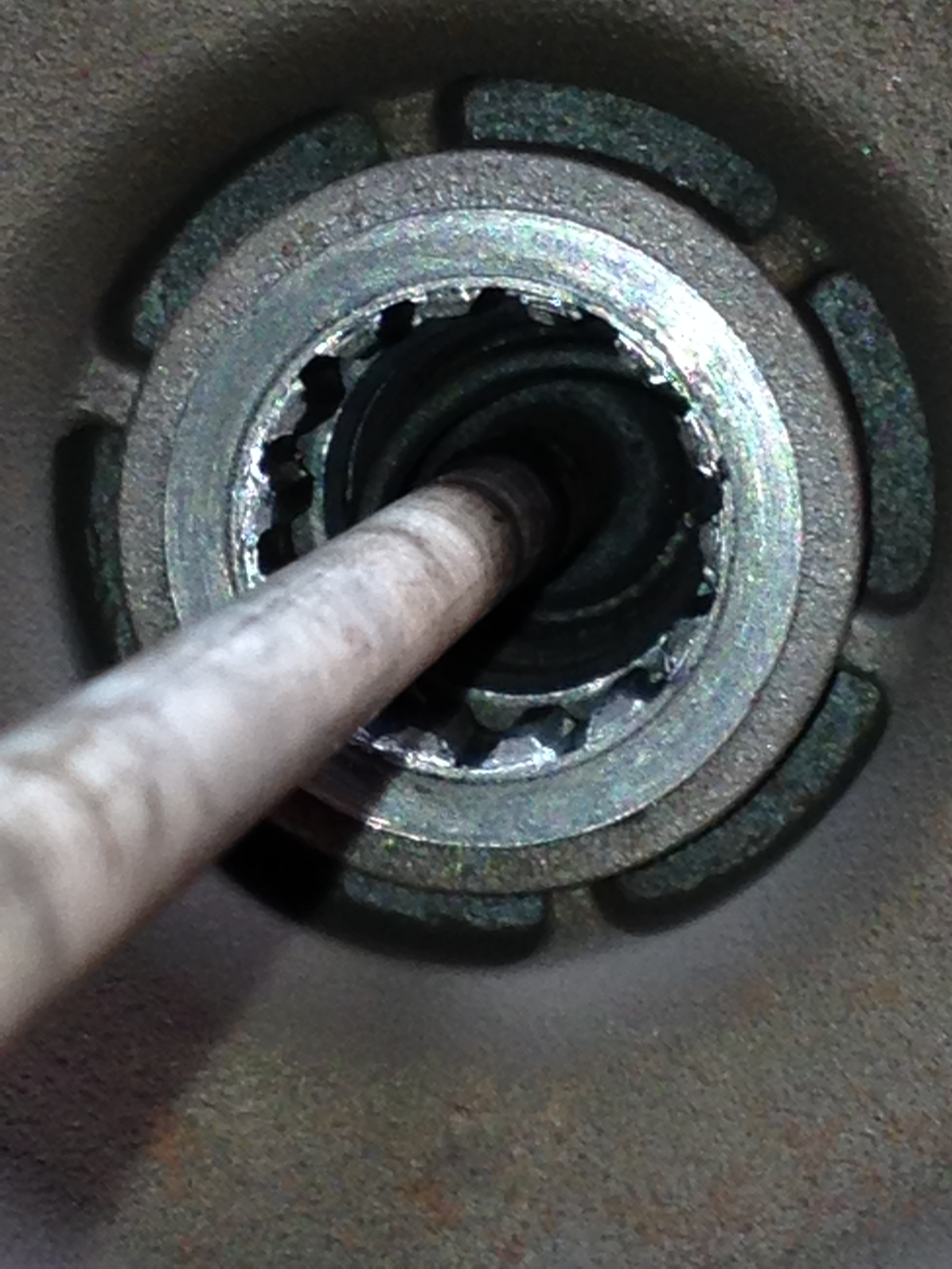

  5. Fucking bike!! you were right. Nut has come off. Went to strip it and one of the spring retaining bolts has rounded off. The first one I tried. This bike is now starting to piss me off. It lasted for two days after changing the reg/rect, sealing the tank and upgrading the cracked plastic sender nut with one of FE's alloy ones, before spitting the chain off. This time it only lasted less than a day.!! I have never heard of this problem??? oh yeah. And of course the header tank again. Clutch doesn't look to cleaver either.

  7. :eek: Not good, at least when it happened to me it was a new clutch and all under warranty.
    Can't see if the hub's salvageable (at least the posts aren't broken off) but the rest doesn't look too hot...

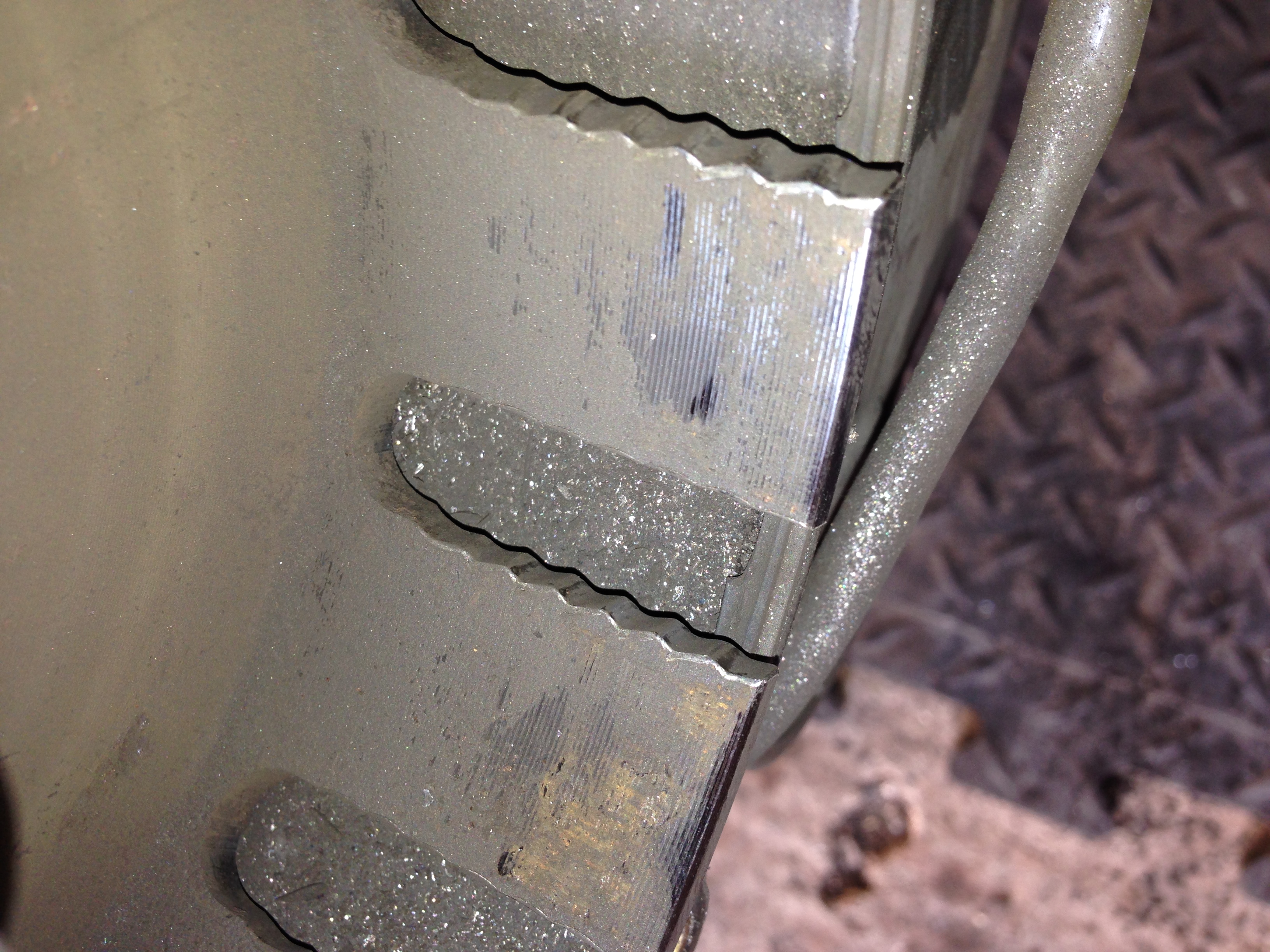

  8. The outer drum looks quite worn, might be worth replacing it with an alloy one and using alloy friction plates, or buy a slipper clutch as has been suggested, although that might turn out to be the dearer option.
