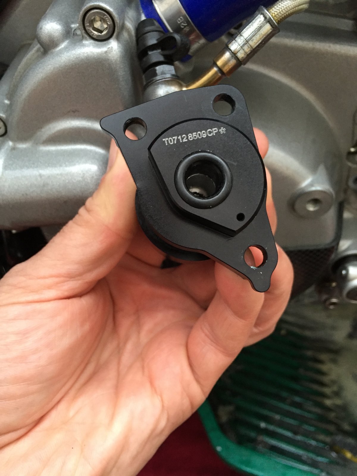

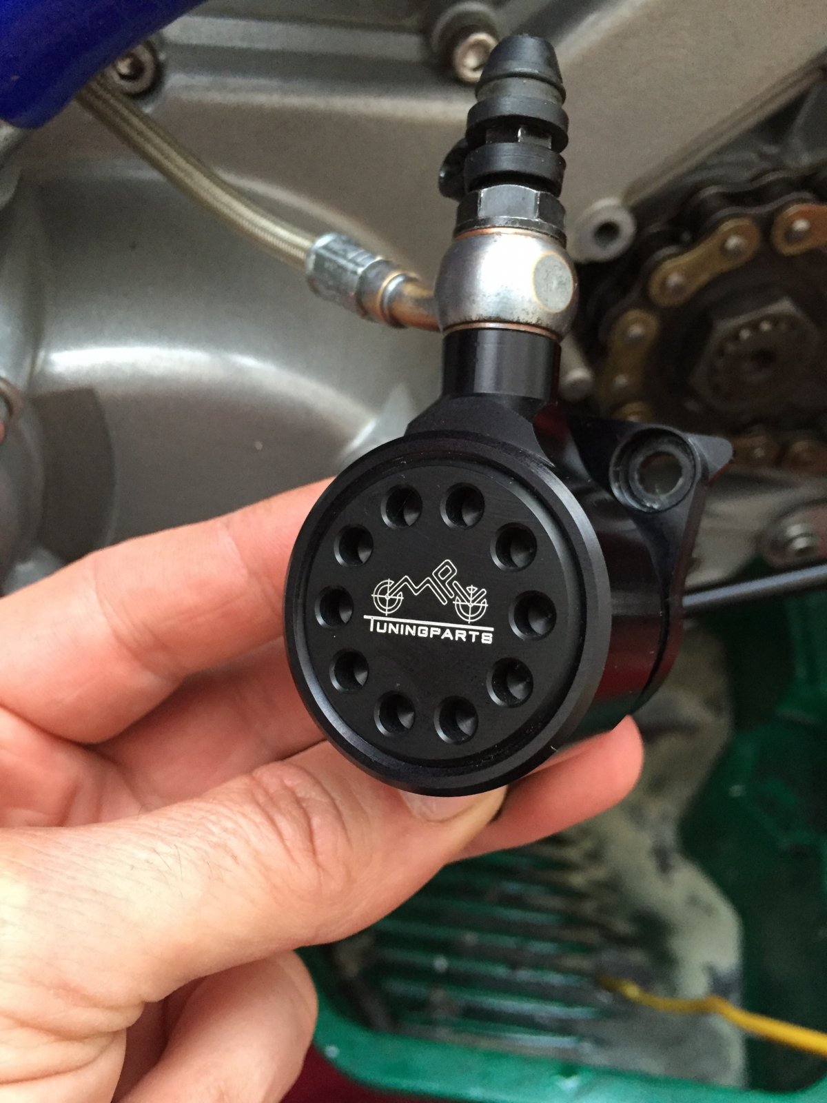

  1. I've had my first breakdown ever on my 749 today after almost 10 years of trouble free riding. About 3/4 mile from home the clutch emptied itself of fluid and the leaver came back to the bar and it stalled as I tried to pull up. The culprit I believe is the slave cylinder as fluid was weaping from the underside. It's an after market MPL tuning one which I've had on the bike for about 5 or so years. I've taken it off this evening expecting the little o ring to be in bits but it looks fine to me. It was very mucky with fluid so I guess it has been weaping for a bit but I hadn't noticed, although while out for a ride last weekend I had a lot of trouble finding neutral so I guess it's connected? Anyway when I pull on the clutch leaver fluid comes out of the little hole on the back of the slave should it come out of there? I wouldn't have thought it shouldn't as I can't see how the small hole is sealed by just being fastened to the engine casing. Anyone know if this is knackered from the inside which is why there is fluid coming out of the small hole? image.jpeg

  3. I have the OEM one somewhere packed with other parts in the loft so will get that re fitted for now. What's the small hole on the MPL one for anyway and why is fluid escaping from it? Is it a seal inside gone? I've emailed MPL to see what they say.

  5. Turns out the small hole on the rear of the slave is a breather hole so shouldn't have fluid coming out of it, which suggests an internal seal failure. I've contacted MPL Tunning who can supply a new seal kit for €15 but I'd need a special tool to gain access or I can return to them and for €49 Thay will repair and send back to me, so looks like I'll be returning it to them for a repair which is half the price of a new one.
  6. The special tool they are on about is for unscrewing the front of the cylinder.If you are competent with a few tools I'm sure you could codge something together.
  7. Yes but I'd probably end up scratching it, so decided to send it to them.
