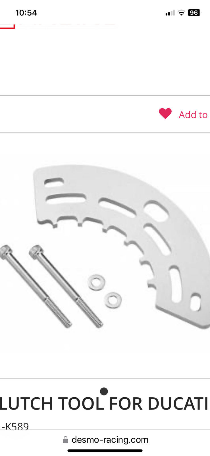

  6. I got one like this free with a clutch basket. Screenshot_20240404-155723~2.png
    It holds both the basket and the hub secure enough to do up the bolts and the big nut to spec without putting load through any other parts of the engine and box.
  7. That does the same and I may have to buy one of these instead, some nylon ones can strip when doing the big nut so I have heard.

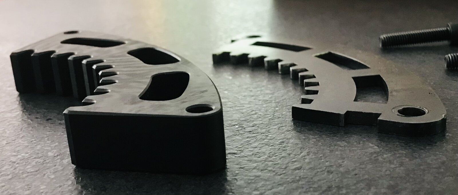

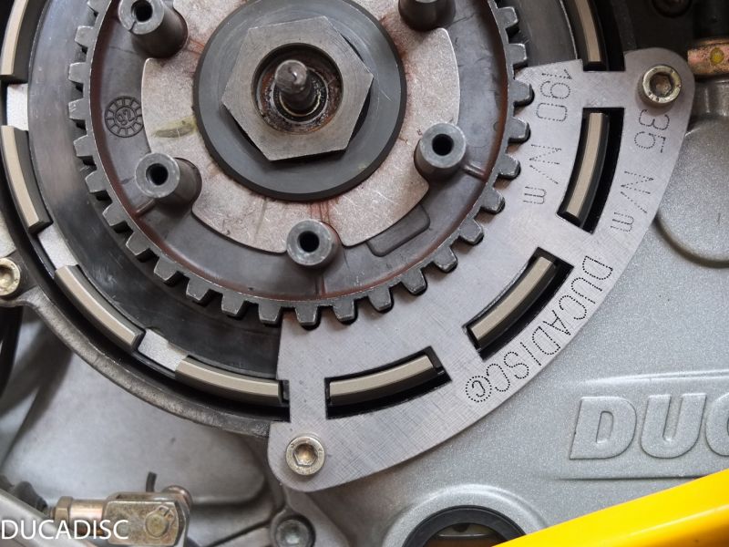

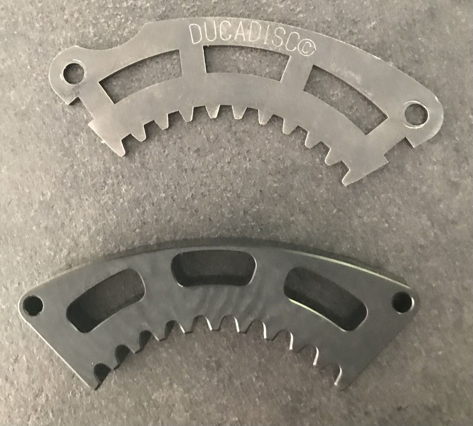

  13. I’ve got two of those in my tool box: one very thick made of plastic (nylon?) which I have never used so far, and another one made of metal, much heavier in hand, strong, which I got when I ordered a new clutch kit (basket + hub) from Ducadisc. It’s the one I use every time I need to remove hub and basket. Super handy and easy to use! And it’s only 24€ + shipping. Good value, not « cheap ».
    http://ducadisc.com/fr/produits/les-outils-pour-l-embrayage/l'outil-de-blocage-12-dents/
    FB0DF2F1-2E97-4004-A6F5-4D6BC9FD4A7E.jpeg 10017F8E-E860-412F-B3AA-095FC064FAFF.jpeg B2CB5D73-086D-4EC4-966E-F5CEAD792EDB.jpeg
  14. That looks good quality! Mine is a bit of a Faff to get it all lined up.

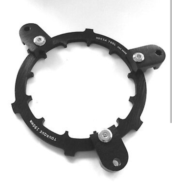

  15. Yes that’s the type I was fancying just order the full round nylon lazer one for £14 , see how it. Goes if rubbish will get one of these

  16. I had one like that, first time I used it, it snapped like a carrot.
    Best to use the old school long-handled metal versions IMO.
