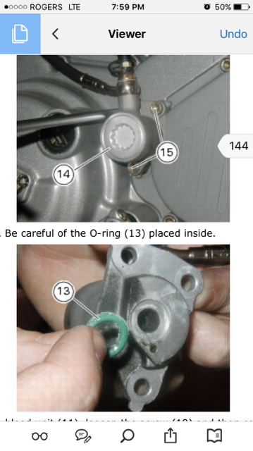

Hi all, My 2007 Monster 695 is leaking oil from the clutch transmission unit. I removed it to check the o-ring and everything seemed fine however the bottom screw looked strange. I noticed that the threading from the inside where the bolt goes is now molded to the screw. The bottom screw does not tighten anymore because there's no thread left. Anyone had a problem like this before ? Sent from my iPhone using Tapatalk
Leaking slave cylinder is a perpetual Ducati issue as are over-tightened bolts which strip threads. Cure is to completely strip the slave cylinder e.g. actually rake the pistin out and don't just look at the seal, you often can't tell anything from just doing that. What your looking for is any crap, sludge and scoring it may have caused to the actual cylinder itself as the piston pushed in and out. Chain lube and the grit it attracts, make for a great scouring compound that gives the seals a really hard time. However, regardless of any scoring, change BOTH inner and outer deals anyway. They only cost a few quid. With regards to the bolt, which is obviously the main issue here, carefully Helicoiling the outer case is the way forward. Kits are about £15 on Ebay.
Thanks I'm looking at the coil kits. Btw you mean inner and outer SEALS, right which are the O-rings on the piston and the back of the clutch transmission unit ? Sent from my iPhone using Tapatalk
The thread is completely gone. The bolt turns freely. I'm lucky it didn't fall off Sent from my iPhone using Tapatalk
There is an o-ring around the actual piston and another that fits inside the hollow and of the pistin. The latter has a small hole in the face, into which the clutch push rod fits. This seal just pulls out of the end of the piston. Oh and if the rubber boot that goes over the top of the piston and push rod assembly is split or perished, replace that too. It exists to help keep crap out of the seals in the first place. Not very effectively obviously!

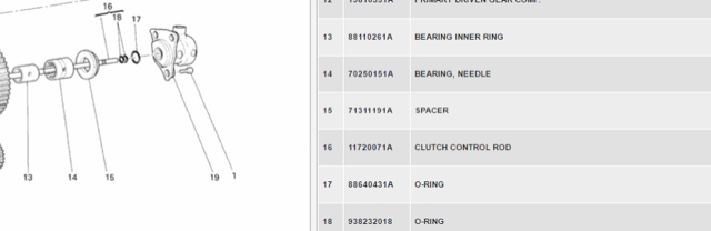

Thanks everyone. I replaced the o rings pictured #17 & #18 and had to fit a coil insert for the bolt. All is good. No more leak. Cost $30. Saved me from replacing the left cover. Sent from my iPhone using Tapatalk
