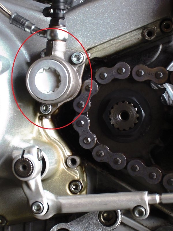

  2. Have you bled it at the slave cylinder too?
  3. This is a 999 one but they're all pretty much of a muchness, yours will be in the same place
    Bleed it in the traditional way of pipe from bleed valve to bottle of fluid, loosen valve pull clutch lever & hold, tighten valve, release clutch lever, loosen valve and repeat...repeat....repeat no more air bubbles job done :upyeah: Make sure you keep the reservoir topped up
  4. Dot 4
    Brake fluid
  5. If the slave does not bleed properly take it off and bleed it "uphill" by holding it in a higher mounting position. Sometimes on the odd occasion you can get a bit of air still trapped in the line.
  6. It's pretty easy as I replaced my slave last week. Since the reservoir on the handlebar is so small, each time you bleed check it so you don't run out and introduce new air in the system. Brake fluid is corrosive so clean up well on any bike surface. I put a rag underneath both ends.
