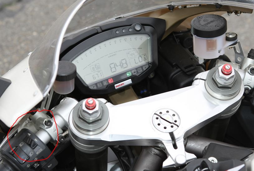

So I lost one of my spare coded keys for my 848 and I need to get another done. I took it in to the workshop and they told me that in order to reprogram it the mode button needs to work, which mine isn't. When you press the mode button down you get through the different distance counters, but when you press it up nothing happens. I therefore have two questions to anybody who might know i) can I get the spare key coded independently of the bike and just with the code from the code card ii) any ideas why the mode button would work when pressing down but not when pressing up? Thanks

Is the mode switch U/S? If it is you could disconnect the wires into it and wire in a centre off rocker switch. IP65 Centre Off Rocker Switch | Maplin The mode switch works by sending either a +ve or -ve signal to the dash. I'll work out the wire colours and post them later. If you're near West Yorks then I could clone your current key to a blank.

you really need the mode switch to work so that you can work the dash correctly and reset things like the clock and trip. If I remember correctly pressing up sends +12v and down sends -ve. These signals go via the Grey (Gr) wire of the mode switch to pin 16 on the dash. Toggling between + and - allows things to be set. To clone the key you need a key blank with a virgin T5 transponder Ducati Blank Uncut Key with transponder chip | eBay Timpsons can help cutting and cloning the key.
As for your mode button, if you have a screwdriver and a volt meter I can go through a few checks. I'm better at doing stuff than explaining how to do it, and I'm better at explaining than writing about it so all I'll say to start with is check the switch gear plug going to the loom. It may me corroded or have a loose pin.

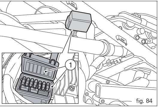

The "A" mode button, the horn, headlamp flash, the brake lights and the lap timer all are all supplied by the same circuit. If the brake lights aren't working either check fuse no 3, it's a 15A. If the brake lights work the problem may be a broken connection to the switch. There should be 12V on the red/blue wire of the switch connector.

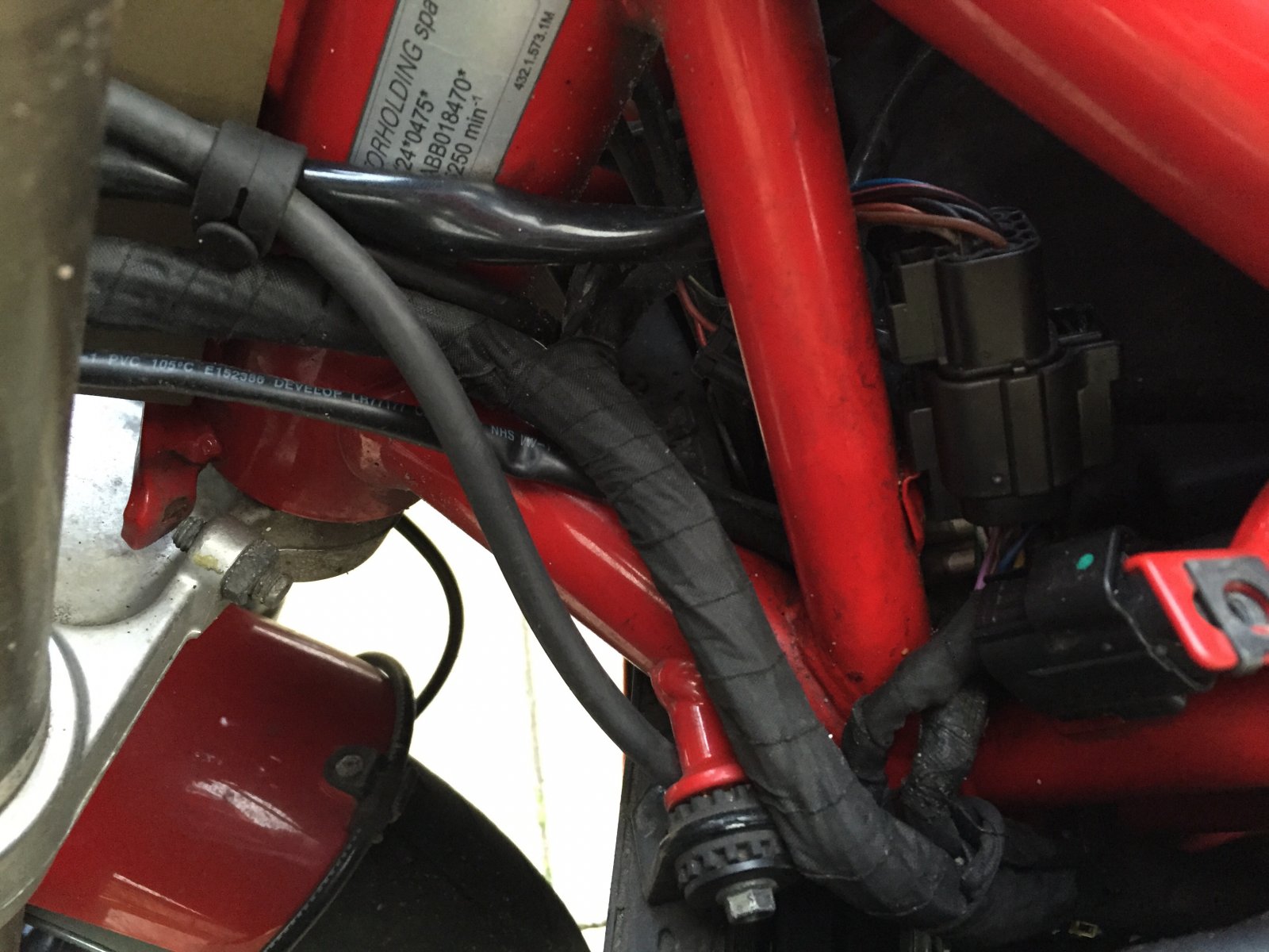

So the break light isn't working so I assume it is the fuse. I've never delved into the electrics, so if you can help me out I'd appreciate it. I've removed the black panel underneath the left handlebar and can see the loom that comes from the mode/light etc. where do I find the fuse and if I need to replace it do I have to disconnect the battery? Thanks
