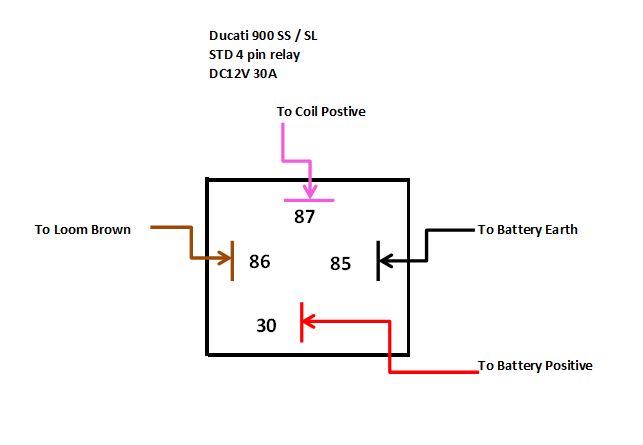

  1. I've read that supplying a 12 v supply direct from the battery (via a relay ) improves coil output.
    Has anyone done this and is it a worthwhile mod ?
    I've knocked up a wiring diagram for the relay , just dont want to bother doing it if its not worth it.
  2. Simon it cannot do any harm
    beefier earth leads solve most issues
    the relay idea you are suggesting works wonders for headlamps
    Steve B
  3. I have got beefier leads for all the battery and starter motor leads .
