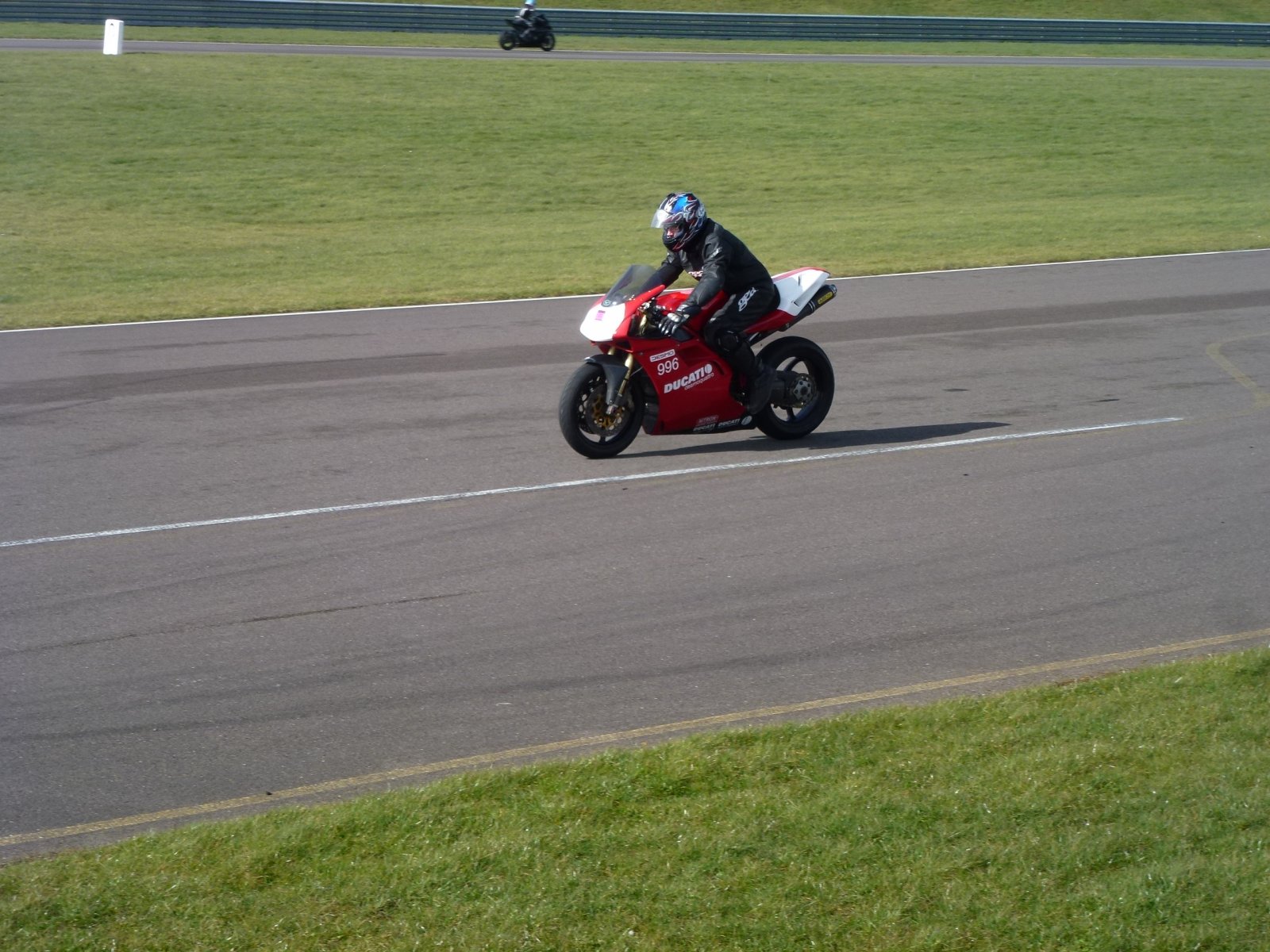

  1. Firstly let me say i am no spring chicken (62yrs almost) which might explain this request. I have a 996 trackbike but my old neck and back problems are preventing me from fully enjoying the experience on track P1010339.JPG due to the extreme 'head down/arse up' riding position. I am having problems seeing the track,or rather the part of the track i am aiming for after the turn. i thought it was just my Arai helmet catching on the collar of my leathers preventing me from lifting my head up high enough to see properly at turns but i am now thinking i could benefit from raising up the bars by changing the clip-ons or even some sort of bar/yoke conversion?

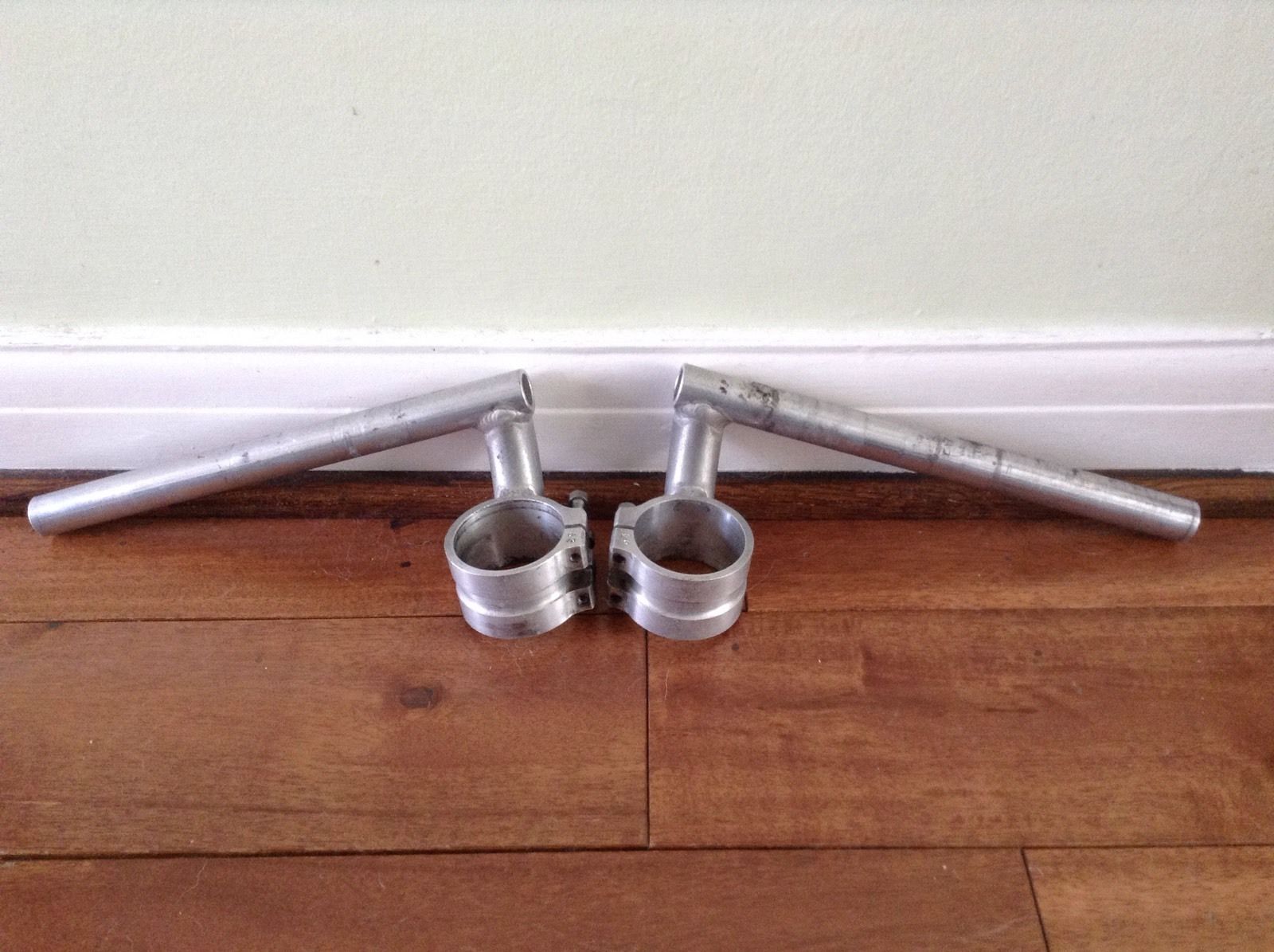

  2. Give bike torque racing a call mate, they do wood craft clip ons sure they do a riser kit as well.
  3. Fast by Ferracci do bar risers, they used to just do the bar clamps themselves, which were decently priced but now they only offer the whole handlebar setup. Most bar risers raise the angle\height by 25mm or thereabouts but that does make a big difference.

    Today i lowered the rear end by 1" by shortening the 'tie-rod' thingy as i have always thought it was jacked up too high at the rear end. i am waiting for some used bar risers to arrive (53mm) and will need to see if i can get the cables etc to fit without buying longer ones. i also have the potential problem of fouling the fairing with the higher bars but will just have to test and adapt to suit when i install them.

  9. I have Cyclecat adjustable bars although you can't raise much more than 25mm anyway as they will foul the fairing and the angle is also adjustable but the biggest benefit for me is that the actual bars are longer and sitting with my arms more apart is not only more comfortable but also makes everything easier IMO.
    I did have to get a longer throttle cable though, I found that the cable from an ST4 (IIRC) is perfect, being the same design but around 2" longer.
