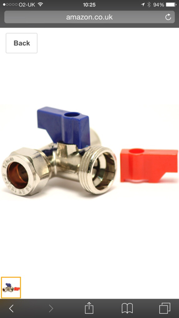

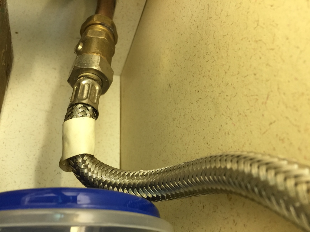

  1. Got a dishwasher coming tomorrow and can't see a spare cold outlet in the kitchen but our cold and hot taps appear to be screwable connections to which I assume I can run a T-junction from the cold tap. Below are pics of the cold tap pipe and the kind of intended T-Junction.
    Would that all work or am I talking crazy talk. Cold pressure seems absolutely fine so can't see any issues there.
  2. To connect the new tap and retain the service valve you show would require cutting the copper pipe and connecting in-line or alternatively you could undo the existing connector but you would need another nut,olive and a short piece of pipe to make fit.
    Looking at your picture if you can cut the pipe an inch below the union and insert the new tap inline would be the easiest.
    Steve
    The existing valve is a service valve, that could be removed and the washing machine tap put in its place.

  3. I thought I could 'replace' the middle section in the top pic, with the item in the bottom pic. The middle section in the top pic is threaded both ends, same as item in bottom pic?!?

    The service valve allows work on the tap or replacing the tap to be carried out without cutting the water off completely.

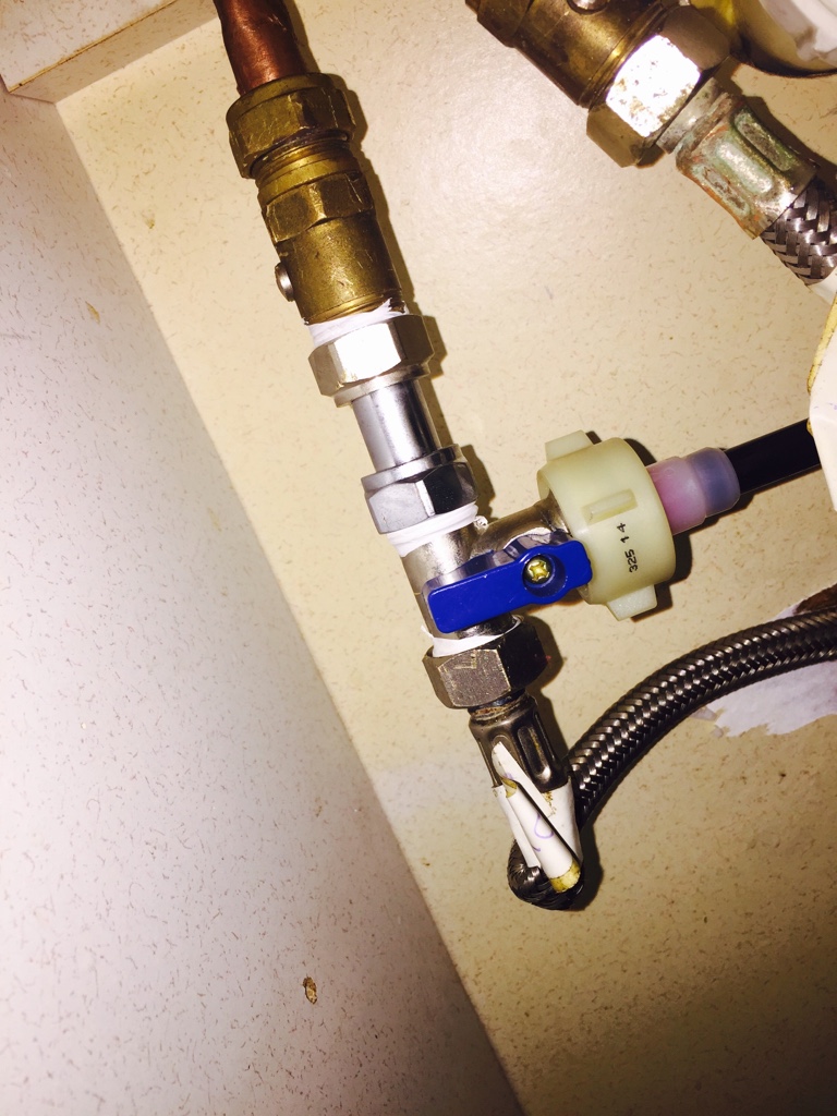

    That took longer than it should have. Isolation valve wouldn't budge but found some 15mm chrome pipe (bling, bling) in the garage so went out and got some olives, nuts and a pipe cutter.
    No drips, but a metal bit just fell out of the T valve so the cutoff for the dishwasher doesn't actually work anymore. Couldn't bear to make another trip out to return it so will just use the isolation valve if I ever need to disconnect it.
    Beer time [emoji106]
