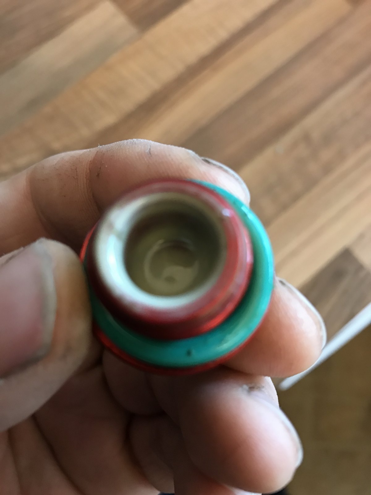

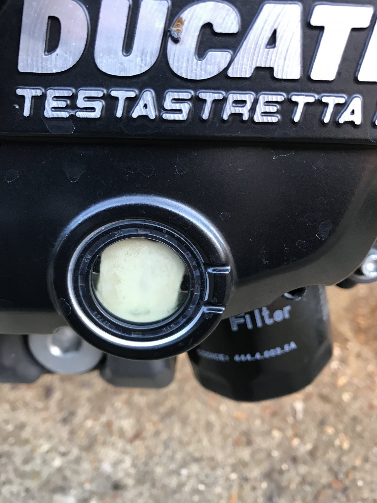

  1. been using my bike everyday over the last few weeks, i leave in the dark and come home in the dark and it's got shitty as hell so thought i'd give it a wash down this morning and check it over etc. I've had it running IMG_2187.JPG IMG_2186 copy.jpg up to temperature but the in the sight glass and filler cap this is all i get. now with my history of jumping up and down at ducati and the dealer over something that ended up being my own fault, what do you guys think?

  4. How long a journeys have you been doing? Enough to get up to temp when riding? It might be worth dropping the oil and putting some new in just to make sure there's no moisture in there?
  5. Roughly 12 miles each way.
  6. Don't know about Ducati's, but I've experienced that on all my bikes at one point or another.
    Always been due to frequent short mileage journeys during winter. My mechanic recommended changing the oil every 2k miles to counter it.
  7. I've heard as long as you can get it up to and above 85degrees that should help with the evaporation of the moisture? Maybe try getting a longer run in so the engine gets nice and hot, bit of a mission in this weather though!
  8. Yeah, a longer idle beforehand can also help. Doesn't make you popular with the neighbours though!
  9. Back in the day I used to tape/cover up the oil cooler on my old GS650 Katana in the winter. This meant the bike warmed up quicker and oil was not emulsified as the moisture was driven off.
  10. I've also heard tale or removing the filler cap when getting home to let the moisture out. Just make sure not to ride off the next day without replacing it!

  17. I've got the oil and filter here anyway as the dealer filled her with same spec but cheaper oil at the last service and i was going to put shell advance in. sod's law I don't have a 12mm allen key at home so i'll pick one up from work in the morning. all drop the oil and report back on here. i'm pretty sure it's just condensation, but i've never seen it that bad on a bike before. as people have already mentioned, i only do about 12 miles each way and in these conditions on the roads i use it rarely gets over 50mph so it's not getting a chance to clear
  18. I have a multi 1000 and my first Ducati. When I first saw whiteness in my oil window I did have a little wtf moment. Then at the belt service I mentioned this to the specialist and he said yep, I bet you do a lot of short journeys? Sure enough I do but the same journeys I did with the blackbird before it.
    I did some digging and this is not an unknown Ducati issue. It's a mixture of riding the bike before it is up to temperature and short journeys. What I do now is when I get back, I centre stand the bike, take the oil filler cap off and put it on a piece of kitchen roll on the seat so I don't ride off without it.
    This seems to work and leaves only the finest of lines of white. I'm sure if I waited till it cooled down and then pushed a bit of kitchen roll in the oil filler hole it would remove the remaining damp.
    I am toying with partially/fully blanking off the oil cooler to help the bike in these colder months, to get upto temperature quicker.
    I do not see it as an issue but more like an annoying quirk, just like the fuel gauge :rolleyes:
