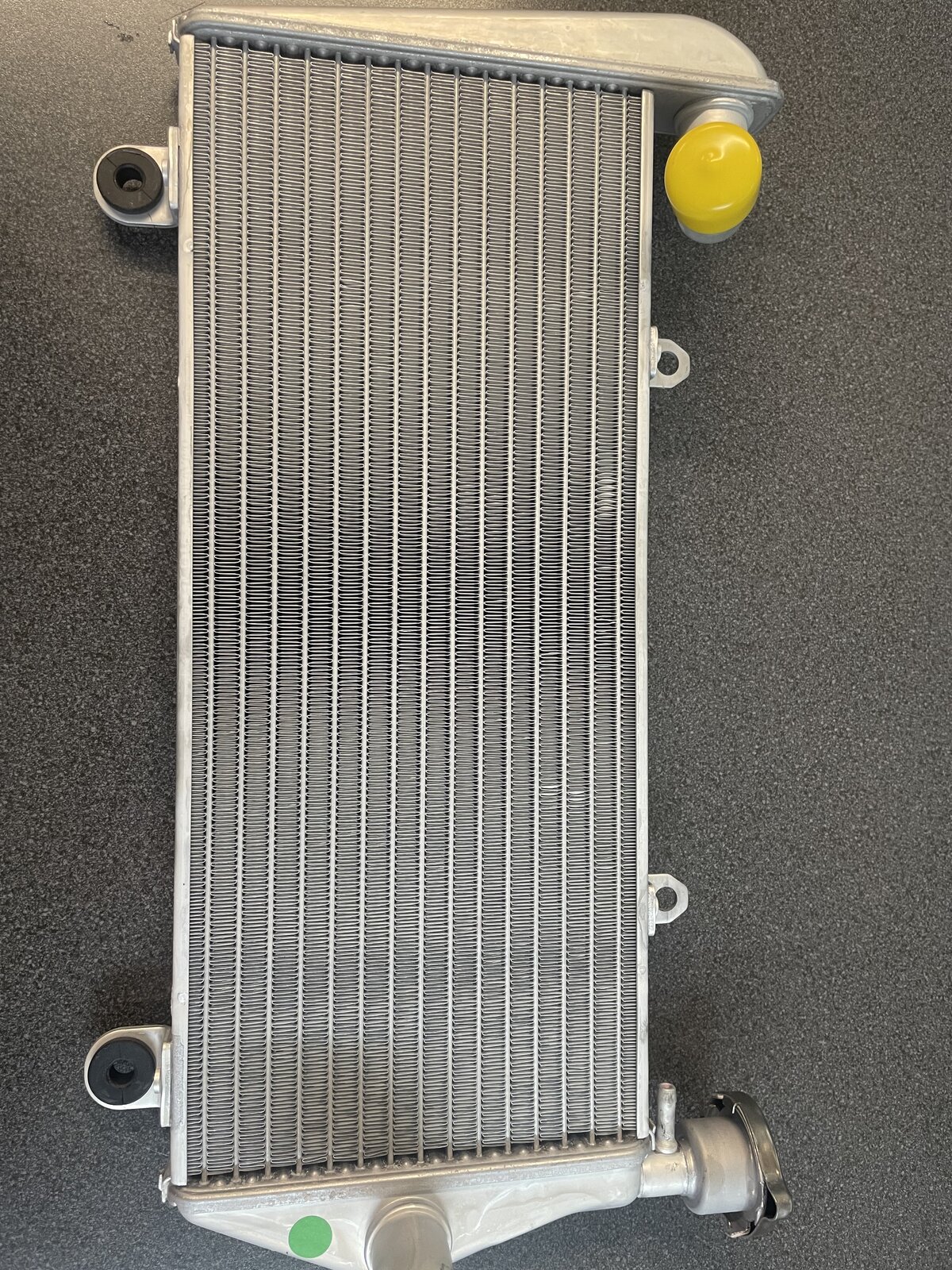

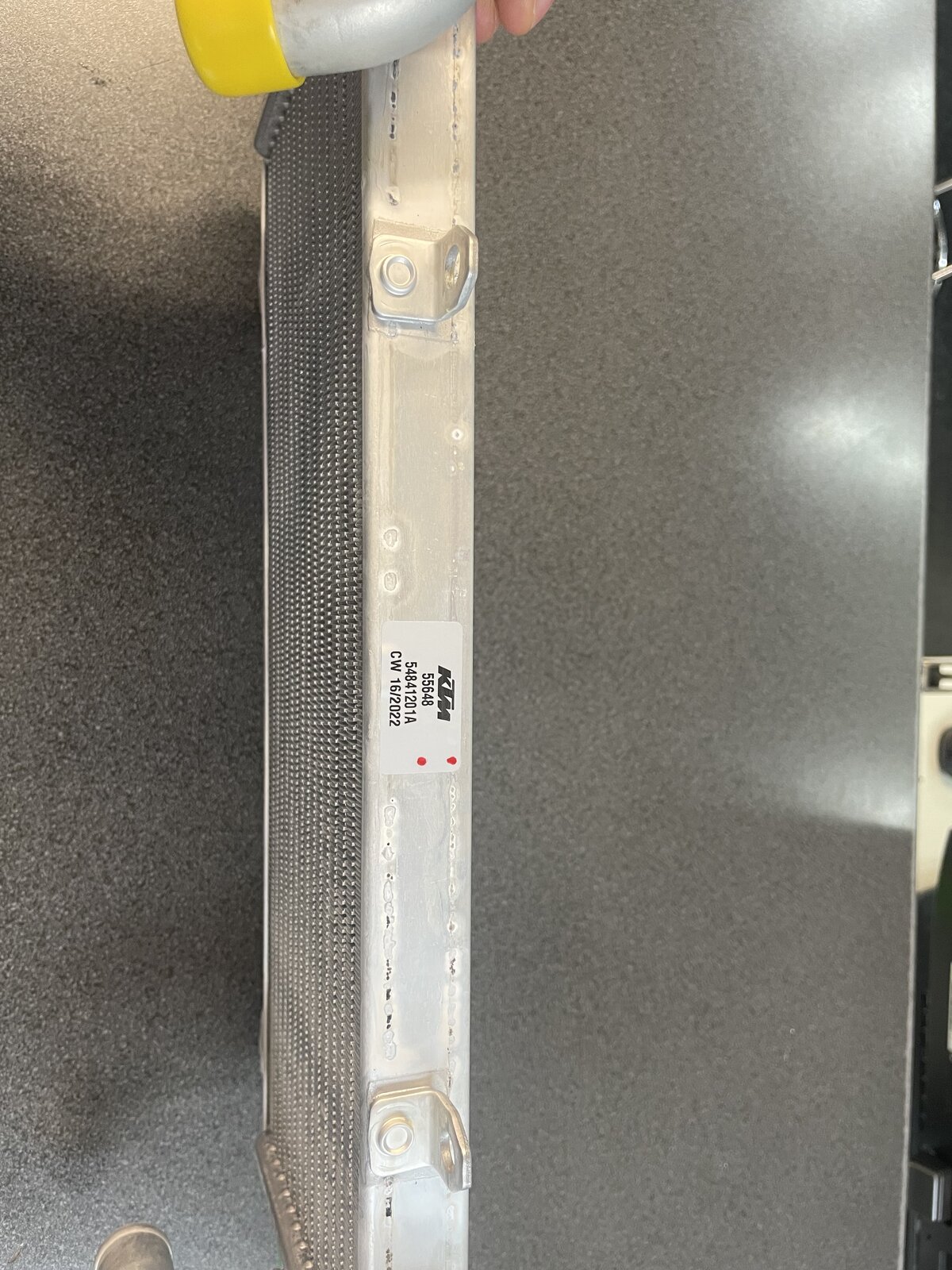

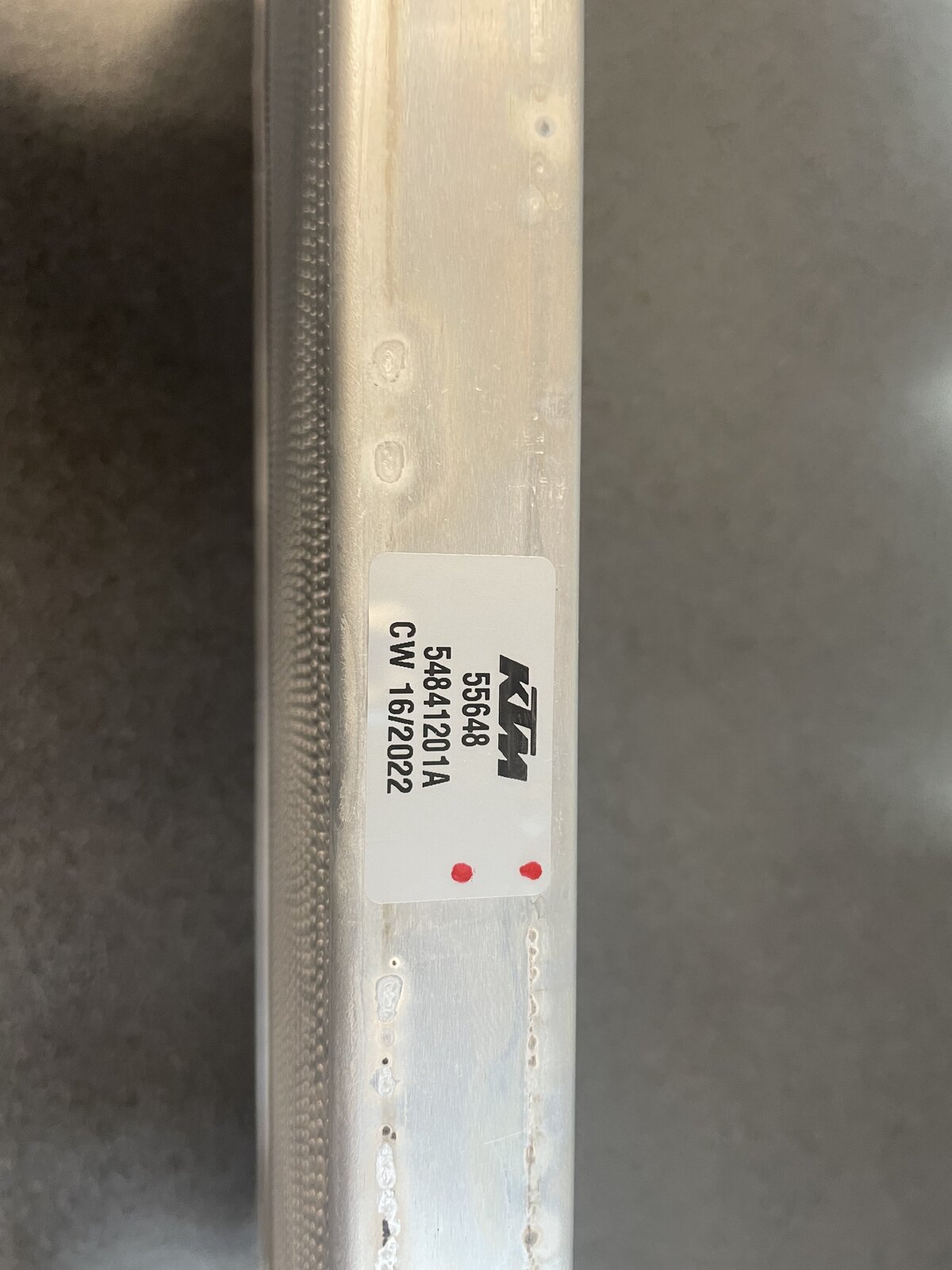

My new rad; curtesy of Craig from Moto Rapido. Brand new, off a V2 destined for racing so they had a few o/e ones going spare. Interesting that it has a KTM sticker on it & the part number works on the Ducati parts system
