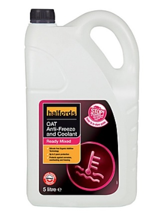

While I have my forks off for new seals I'm gonna change the coolant . I was in halfords looking for coolant but all they had was for cars , is this ok for bikes or can someone recommend something else , cheers http://www.halfords.ie/motoring/eng.../halfords-oat-ready-mixed-antifreeze-5-litres
Use caution as the chemicals can be different but if shopping in halfords I would be looking for one that states it is suitable for all aluminium engines and has a high temperature ceiling. The one you have posted has a temp range of up to 108 degrees which I would say is too low for a motorcycle as it would be starting to boil at the upper thermal working range. I use this which is rated to 133 degrees... Motul Motocool Expert 1 Litre Ready To Use Anti-Freeze / Coolant - Motorcycle | eBay

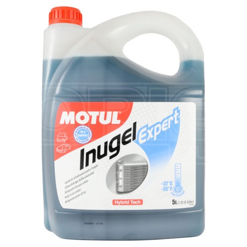

Got this from my local bike shop he said it will do but i just got home and it doesn't say anything about aluminium engines has anyone used this
Very few engines don't have at least aluminium cylinder heads these days and an aluminium/iron combination is even worse for galvanic corrosion. As far as know just about all antifreezes contain corrosion inhibitors nowadays. The data sheet is here - http://www.motul.com/system/product...original/Inugel_G13_Ultra_(GB).pdf?1369901902 It says it's suitable for ferrous and nonferrous components.
