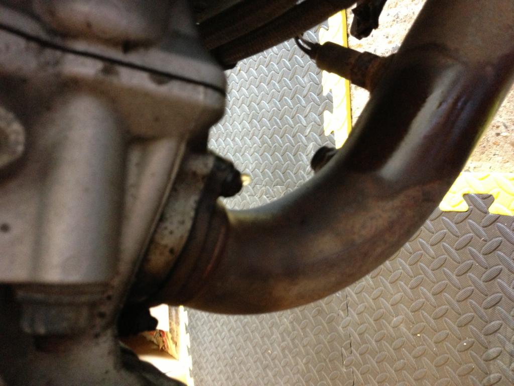

  1. Hi, hope someone can help me, I just purchased a mivv decat system and set aside this afternoon for some tinkering time, I took the belly pan off to discover what smells like coolant leaking from the exhaust manifold! I'm no mechanic but I know that's not a good thing!
    luckily the bike is under warranty and seastars have been great, offered to get the bike in on Monday morning and a loan bike if needed.
    Really hoping someone can tell me it's something else as I'm supposed to be taking the bike on a trip to the lakes on Tuesday! Any ideas??
  2. Best to get it checked out. It may be coolant from a leaking head gasket or a porous head casting but is more likely leakage from the hose from the water pump where it joins to the front cylinder. May just need the hose clamp tightening.
  3. Here's hoping, not looking good though, no signs of leakage any higher up
    Dont know why the photo is sideways either!

  4. Without wishing to be a doomsayer. The multis had a recall to change the coolant due to the old stuff causing corrosion and damaging the head sealant, lets hope yours is a simple case of something needing tightening.
  5. Those are the symptoms mine had - have the exhaust bolts gone really rusty? New heads all round is my guess?

  10. I'm pretty sure the only source of the leak is the exhaust manifold itself, there is no sign of damp anywhere else that I can see, and if the coolant is so corrosive that it eats away at the water channels, surely after 12000 miles the damage would already be done, why on earth didn't ducati change my coolant already?? (It's still the bluey colour, not the pink that I understand replaced it) in this case, I'm kind of hoping for new heads to be fitted as its something less to worry about for the next few years

  12. It's official now, heads are shot, Seastar have been great so far, bent over backwards to get me a gtr1400 so I can still make the most of my holiday, I actually quite like it, plenty powerful enough when you wind it on, but slow to pick up giving a nice relaxing feel after the frenetic multistrada, still will be glad to get my bike back, the wait begins!
