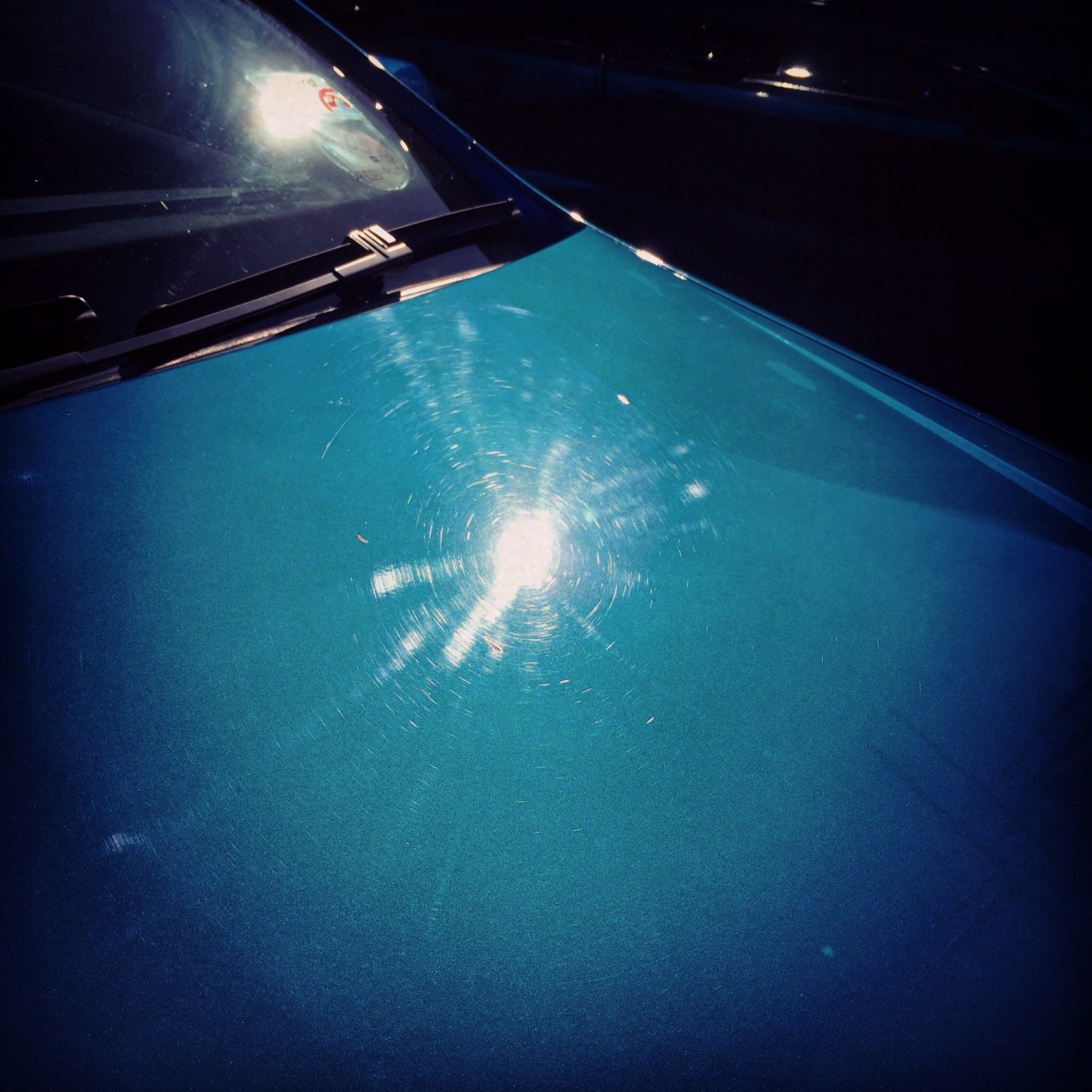

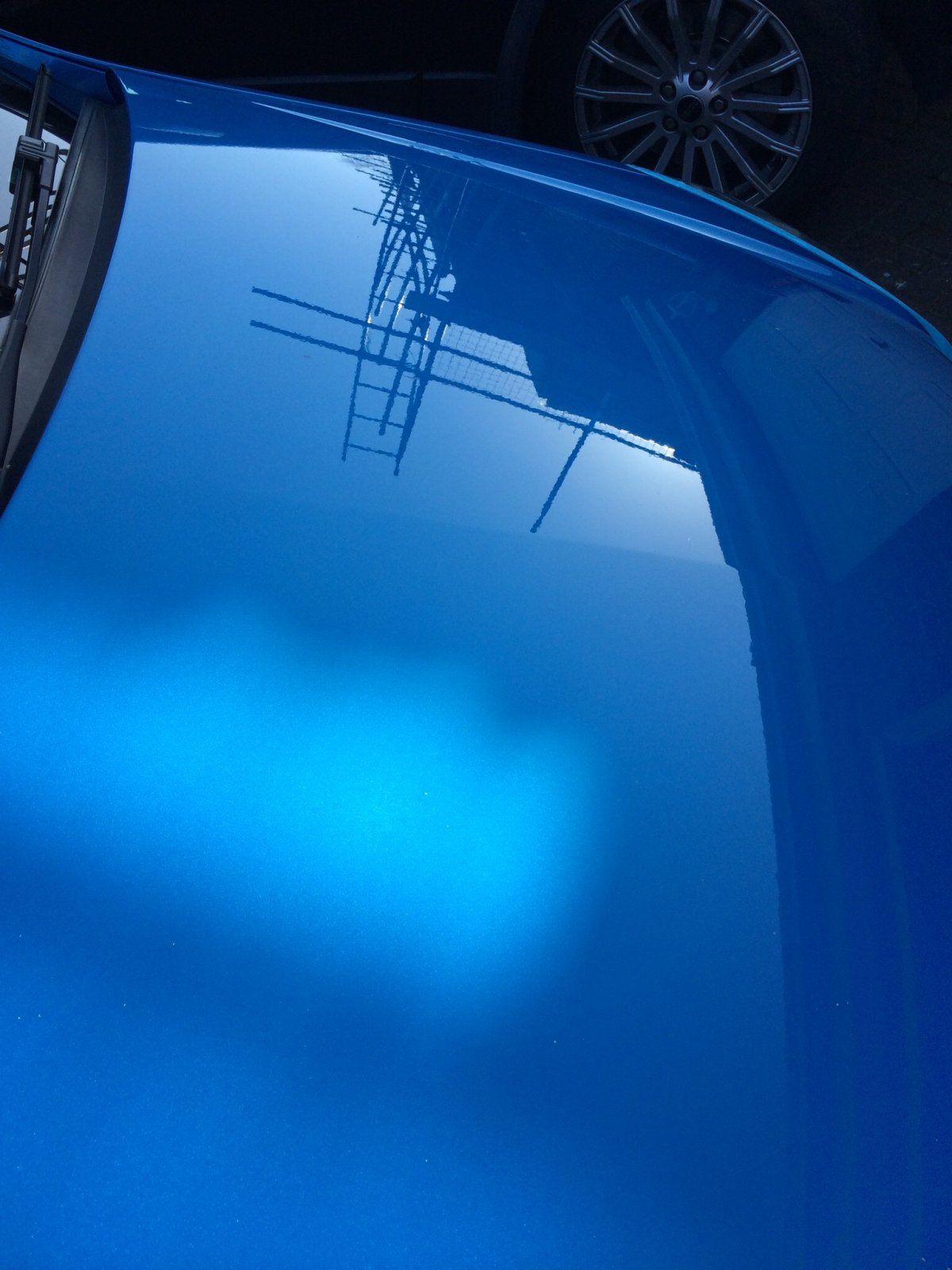

    That's a before and after using the g220 on my bonnet, the whole car was covered in swirls and in the light it looked awful.
  8. Deano84 what jollop were you using ?
  9. Ahh sorry, I used the menzerna sample kit I bought. Never used it before but had heard good things about it, it was around £30 I think for 4 250ml bottles.
    As it was in a sorry state I used the power finish on a hex logic cutting pad and the final finish on a polishing pad. Topped it off with a coat of collinite wax applied by hand.
