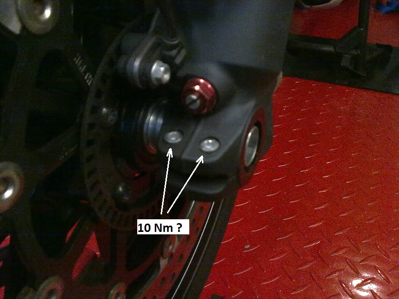

    new to the forum so be gentle with me if this has been delt with before elsewhere. Time for the first new tyre so I've had the wheel out & just wanted to check the correct torque setting for the 4 bolts holding the front spindle in (as shown in the photo). The only reference I've been able to find is described as "Marzocchi fork end terminal fixing screw" @ 10 Nm ? ,doesn't sound quite right to me ???? . cheers Image0214.jpg
  2. Sounds about right to me. Pinch bolts should pinch, not bite :upyeah:

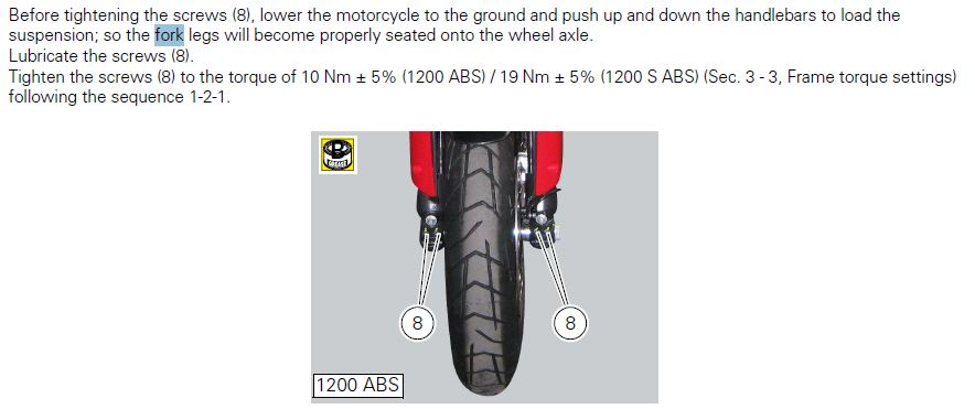

  4. Bob has quoted from
    Home
  5. cheers for that Bob, just what i wanted confirmation of the figures I'd got. Its little things like this that make these forums soo good, will get it done over the weekend then start on the back wheel (if I can undo the bloody nut ) :upyeah:
