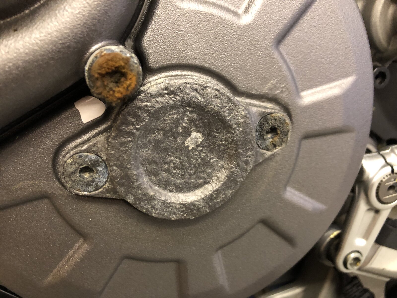

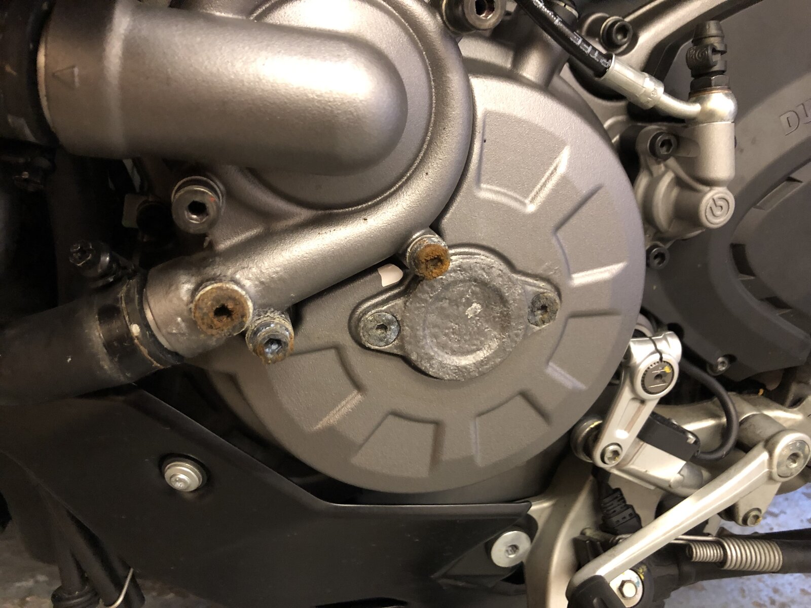

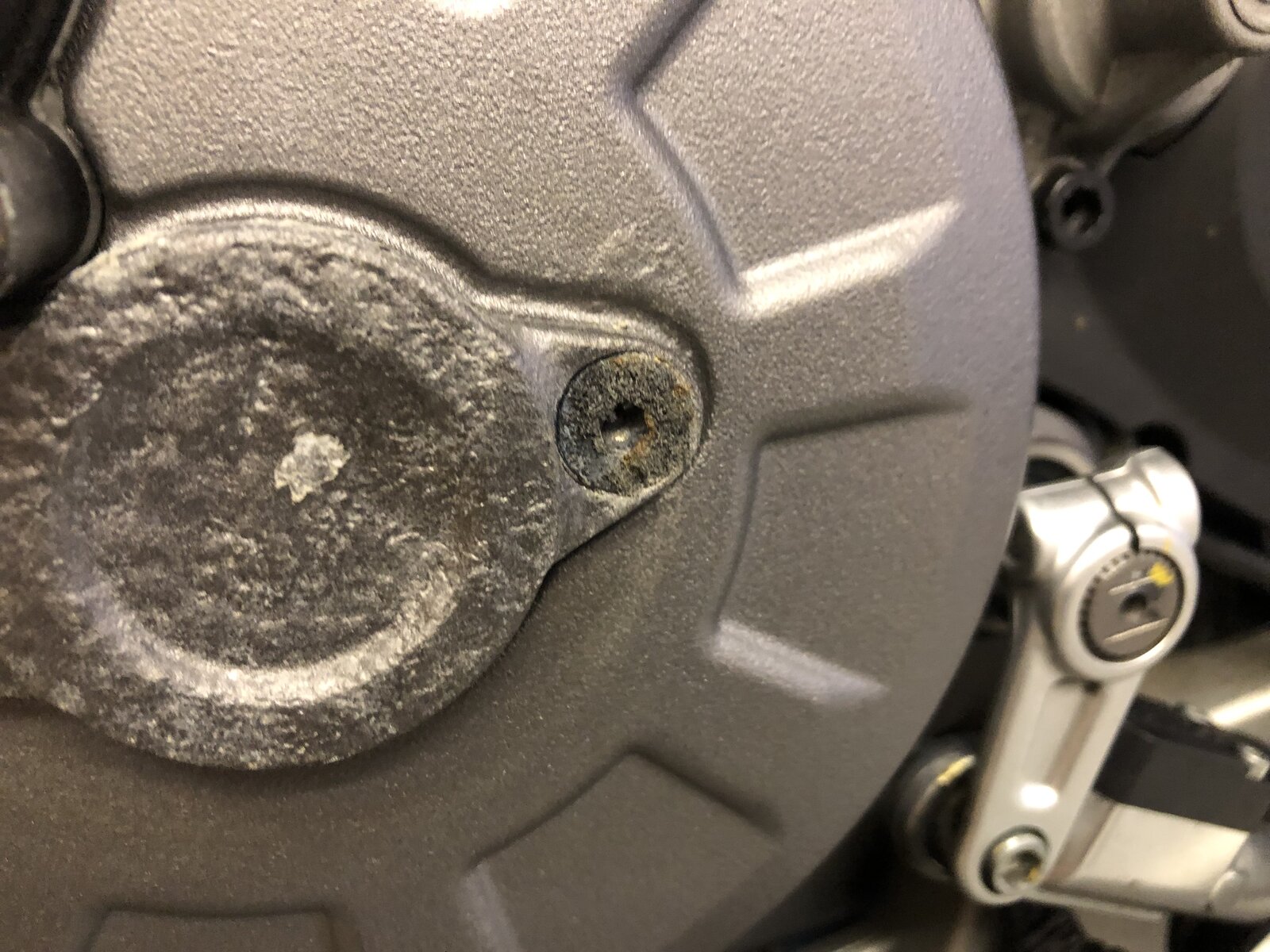

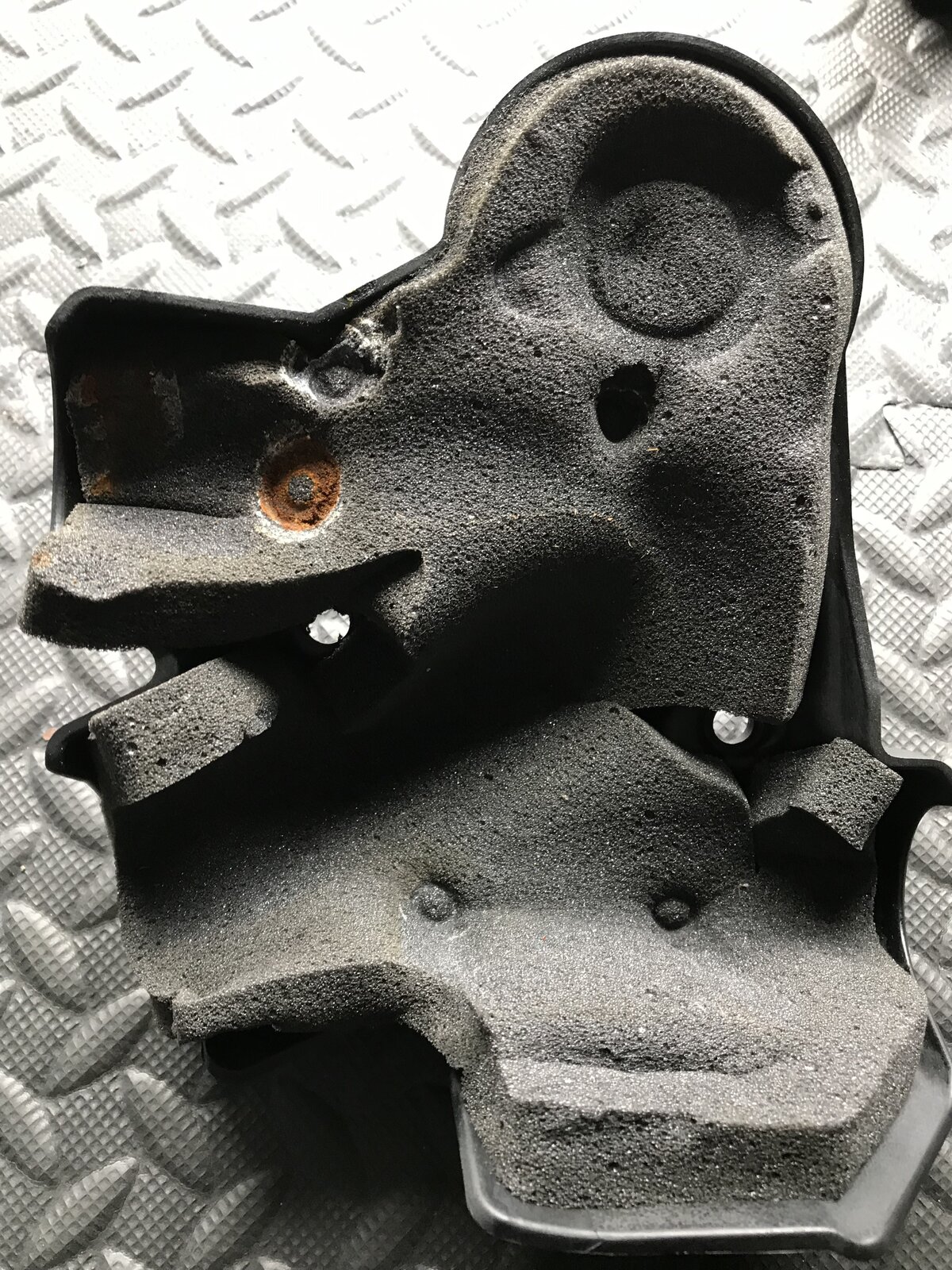

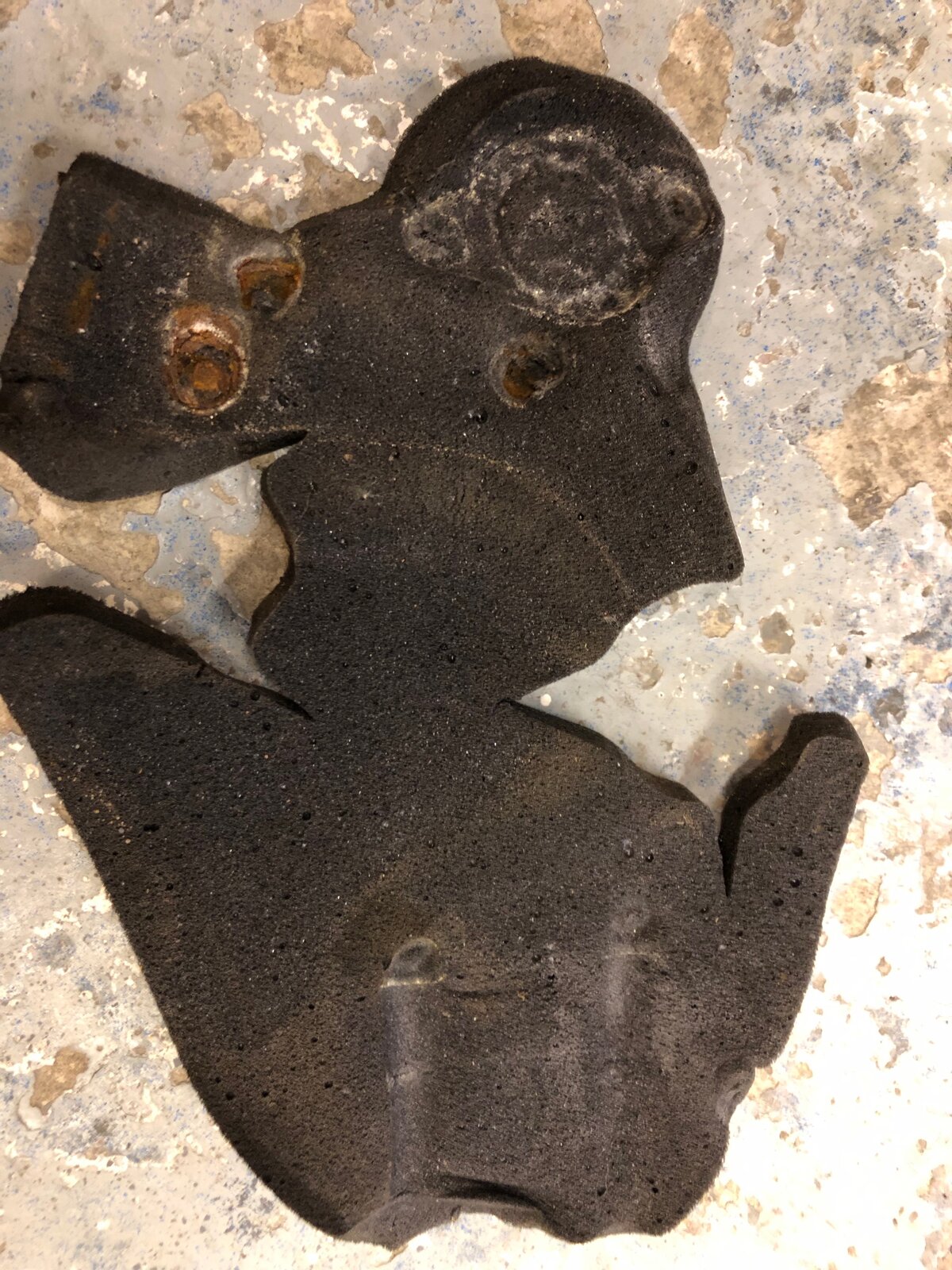

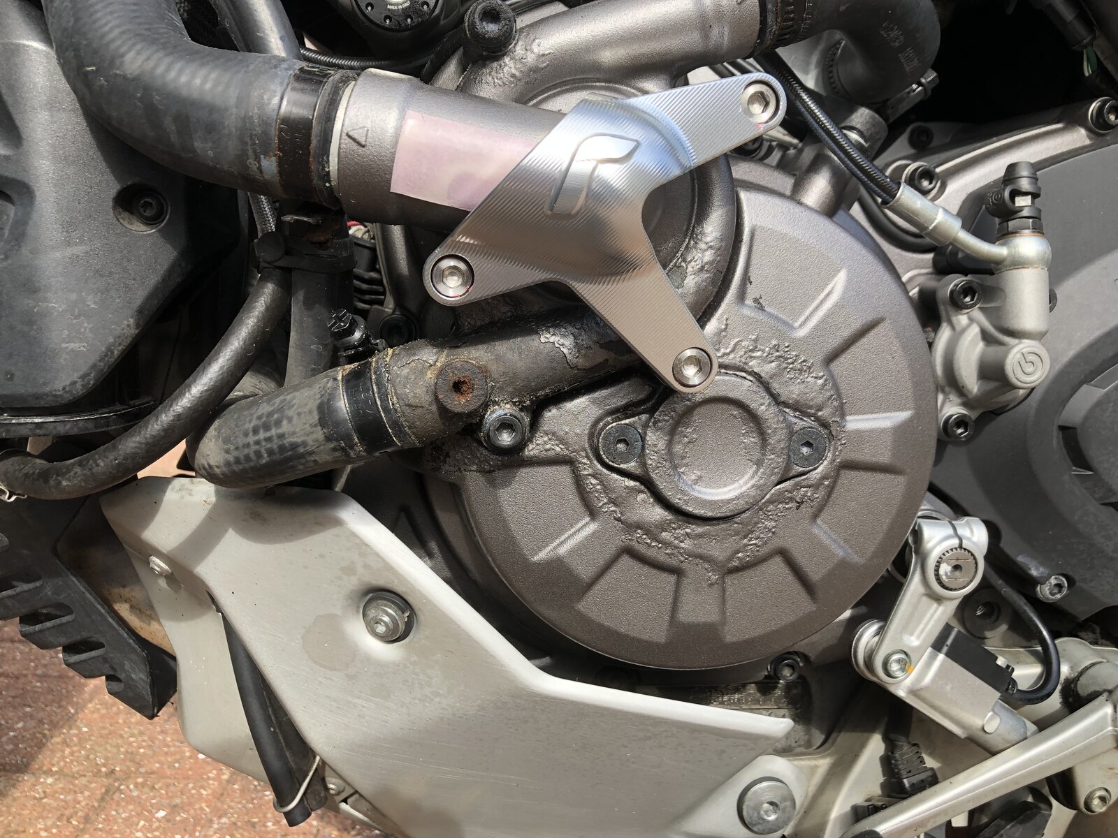

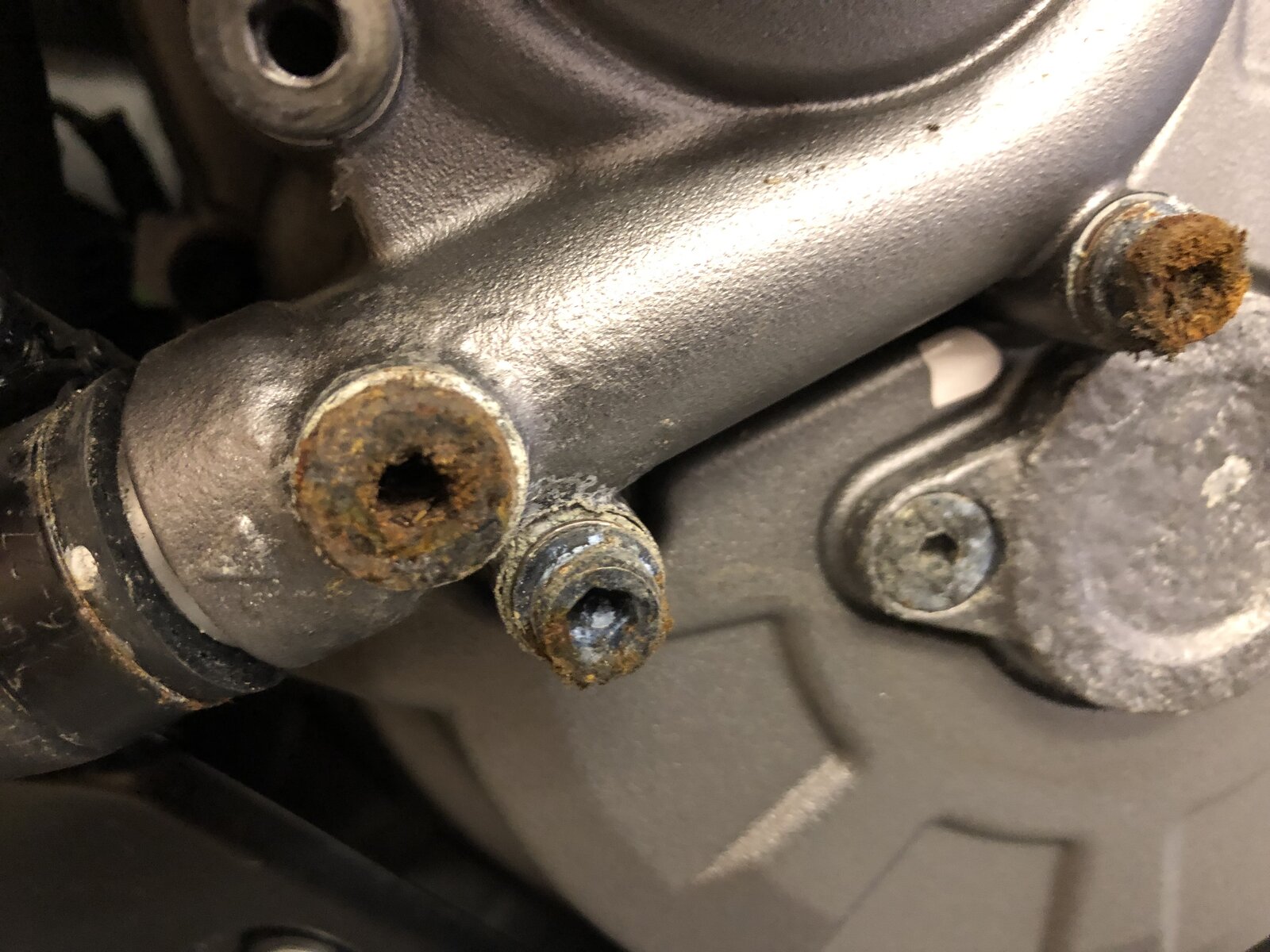

  1. I've just removed the cover from my water pump to fit a Rizoma guard, and uncovered an unbelievable amount of corrosion. This has been caused by water trapped in the foam underneath the cover. I can't see the point in this foam, it will offer no mechanical protection, can it be there for sound deadening of the pump ? Whatever the reason I would recommend that everyone has a look, this will be a warranty claim as the paint is actually peeling off.

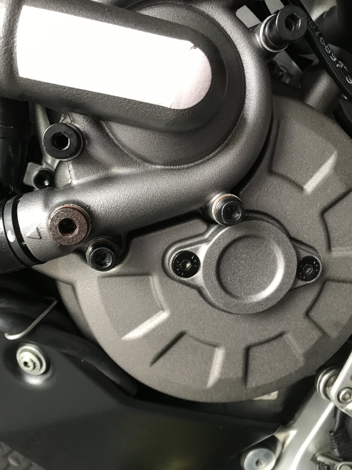

  2. Will be wipping the cover off mine tomorrow for a quick check, that looks terrible, will report back with a pic.
  3. All it takes is one small stone chip to put an unnoticed pin hole through the paint and that sort of corrosion is typical. I have experienced something very similar on both the clutch cover and the swing arm. Andy
  4. The plastic cover and foam are OE fitted to reduce engine noise (a very little!). Mine was removed before I took delivery and a Rizoma protector fitted. Without the cover there is no sign of corrosion after 20K miles and 18 months.
  5. Jeezuz! That looks shocking, how old is your bike, how many miles?
  6. 18 months, 8000 miles.

  8. It should hopefully get replaced under warranty.
    I'd then apply ACF-50 (or similar) to the areas under the foam, then re-assemble the foam piece
    I intend to check mine and follow that procedure
  9. Judging by those pics, its clearly not related to stone chips! I guess the foam and the cover have contributed to providing the ideal temperature and moisture to promote the corrosion.
    I have heard that the water based paints that are now a legal requirement, has led to this among many manufacturers. The better ones are using anodising rather than paint.
  10. Is the foam really necessary ?
  11. I think the foam probably constitutes the majority of the noise absorption. the plastic will be used as a (weak) noise reflection barrier.
    Id imagine it was put there to help the bike reach noise emission standards.
