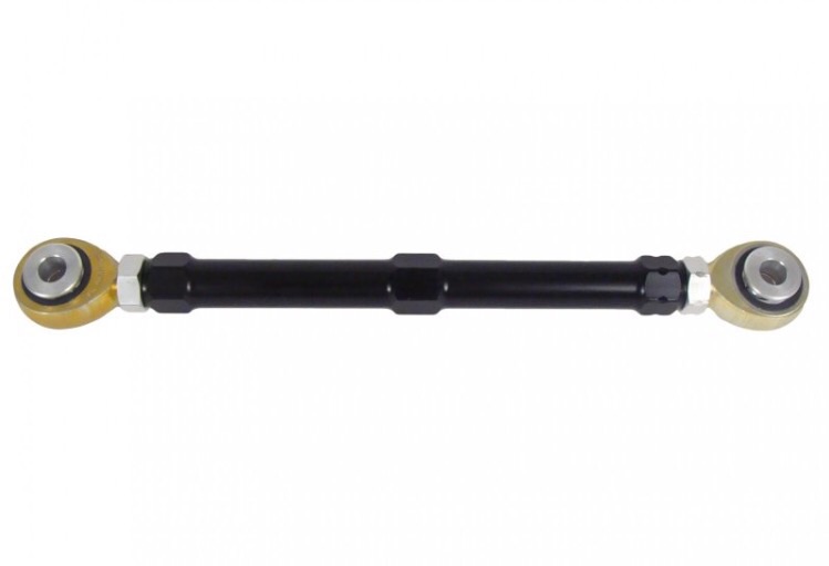

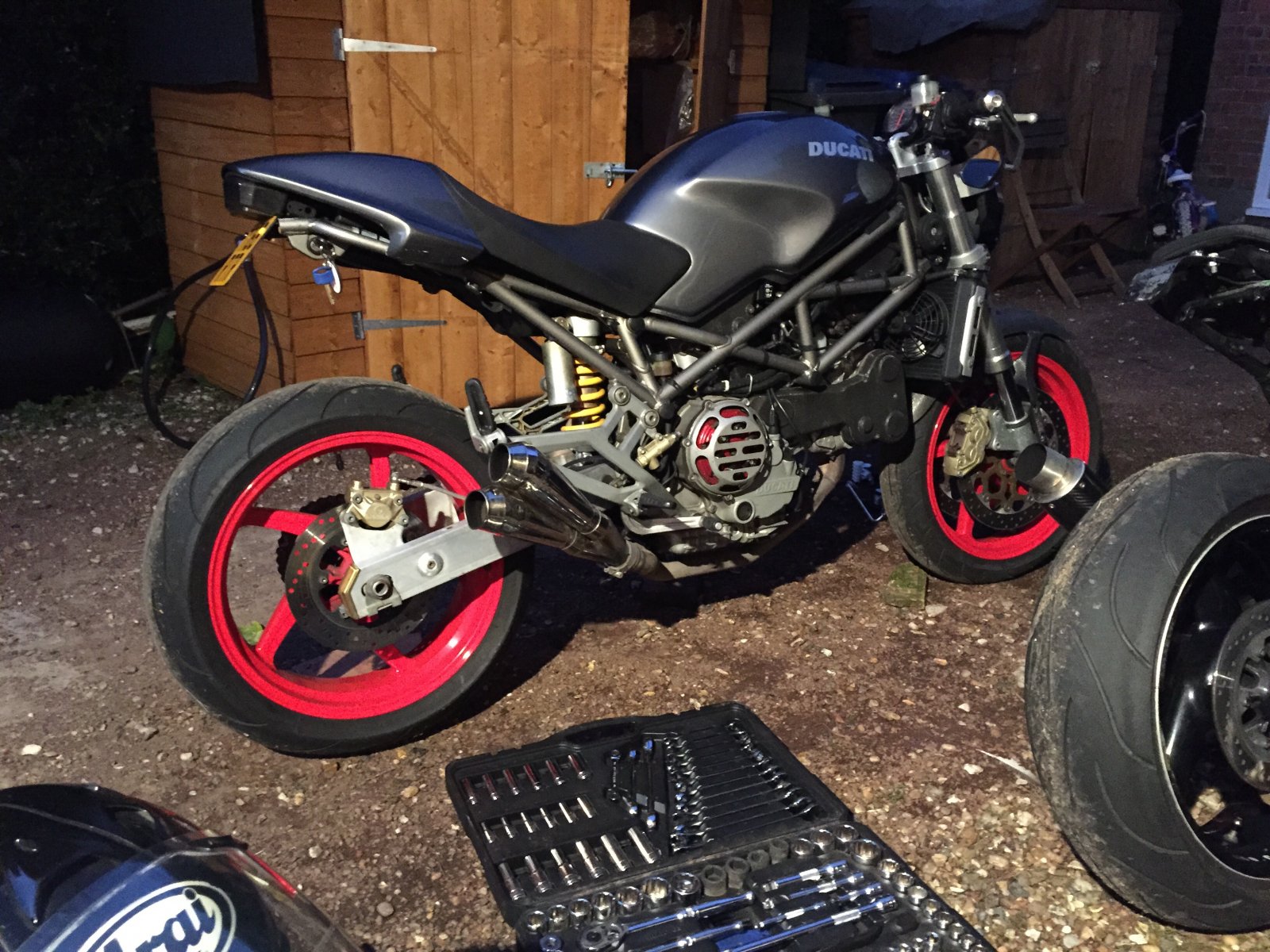

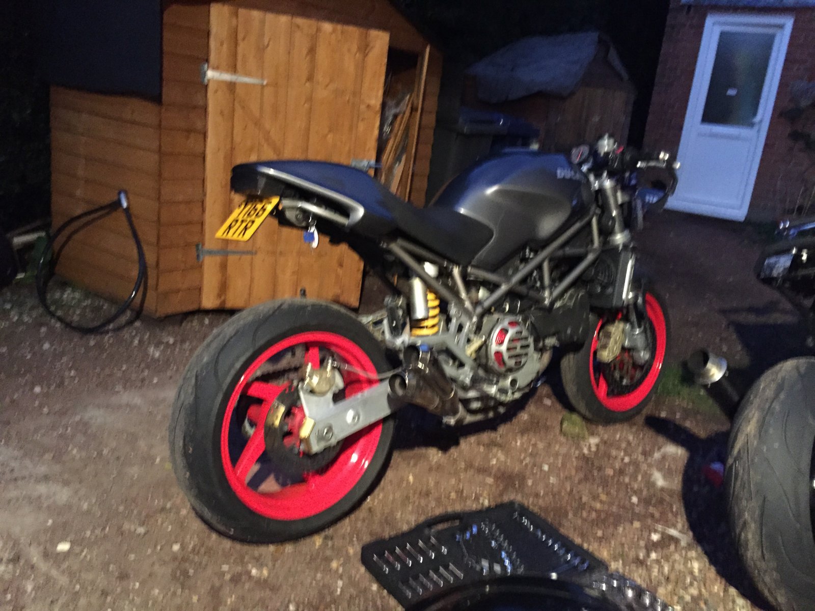

  1. It was a bit of a faff and I had a hard time getting the bottom bolt undone and balancing the bike on a couple of axle stands was a bit precarious but...... success. Seized ride height rod removed and replaced with a lovely new black one which offers more adjustability and actually does the job it's supposed to.
    I lengthened the rod by around an inch over standard, which I reckon equates to around 2" more ride height.
    It feels a lot livelier and more purposeful now. It changes direction like a bluebottle and most importantly it no longer does that annoying Monster thing of running wide on the way out of corners.
    The bike also looks better although it leans over quite a bit further on the side stand.

  3. The problem is, you say you have lengthened the rod by about an inch...that will serve to exacerbate any structural deficiencies in the design of the rod, squared.
    I would be extremely wary of using such a product.
    Just sayin' like...
  4. Yeah. I've thought about that already. As the Corse Dynamics rod is actually shorter than the Ducati one (it's advertised as being able to lower as well as raise stock ride height), to get extra ride height you need to wind the ends out further than you do with the Ducati item.
    When the standard rod has its ends fully wound in, it is the same length eye to eye as the Corse Dynamics one with about a quarter of an inch of thread showing at each end (a bit garbled, but I hope it makes sense).
    Alrhough I'm interested to know how much weight the bike was carrying when that other rod failed (maybe it was two fatties plus luggage and larder being ridden on potholed farm tracks), and I would be surprised if the design was so defective they've had multiple failures and yet are still selling them (highly unlikely in the ultra-litigious USA), I'm thinking I might just try and find a OE rod which still works and send this one back to the colonies where it came from. I've survived total brake failure and a wheel falling off in cars and a holdall escaping from a bungee and jamming itself between the seat and hugger of my 748R which locked the back wheel at 60mph, so I think I've used up quite enough of my 9 lives by now
