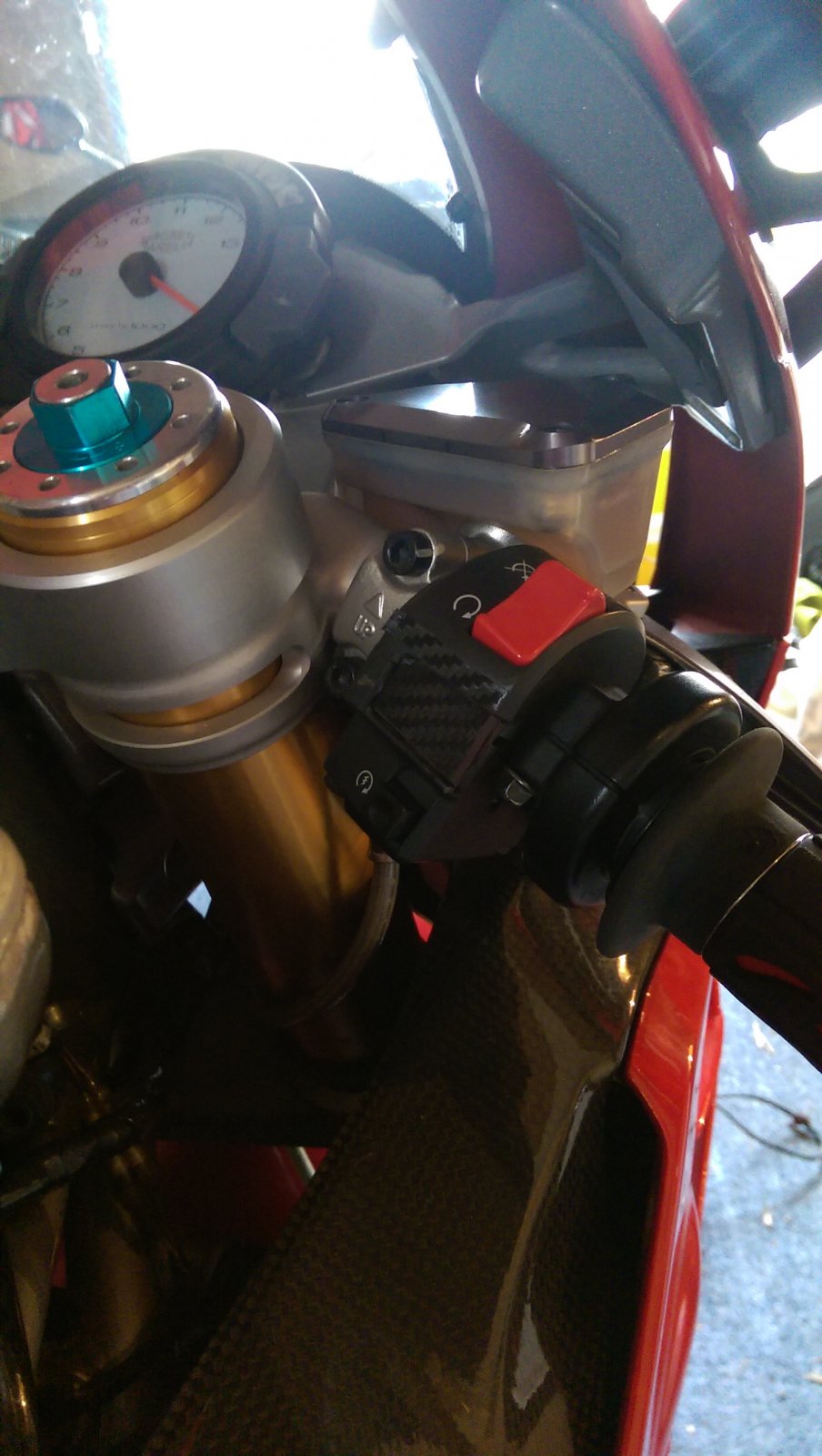

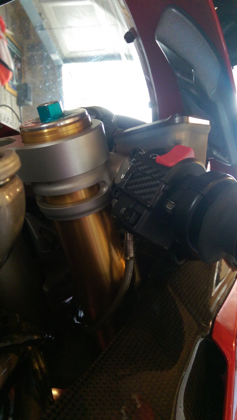

I dont know if any of you have run into this problem, but my 2003 999S has a Ducati Corse scree fitted which does not have the city running light fitted as standard. Until recently this posed no problem fo MOT's, however last time out I was told this was now no good as the light switch should be fully functioning if fitted. I looked at fitting a later model part where the headlight is hard wired on all the time, but did not find one. So came up with my own home solution. I took the switch apart, took off the rubber end, bent the metal pin (all whilst the switch is in the full headlight on position) put it back together, glued a nice piece of black plastic I found over the slot hole and then clad the plastic and face in carbon fibre sheet. I will post pictures but I think it looks good and solves the MOT problem as there is no switch anymore. A solution for anyone having a similar issue.

I know what you mean, my bike has had this screen since new and never been an issue, so when I had a problem I tried someone else and they said the same. I discussed it last year with some people a the Bristol Italian Fest, and they had oer come the issue with new switches. To be fair its better this way as its hard wired on now with no hint of the unit being a light switch, not even the markings are visible any more and it looks like the newer switch unit (but carbon fible). I just could not be bothererd to have to mess about trying different MOT testers.

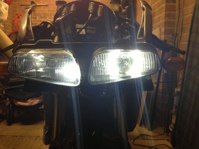

OR you could be fancy and retro-fit a running light into the headlight instead. I did something siimilar on my 748 headlights by adding LED rings around the main head light. As the 999 headlight can also be stripped down to remove the projector unit, you may be able to do the same. It cost about 99p from ebay and I wired it straight into the connector for the running light. HTH

Now as soon as the ignition goes on, so do the head and tail lights. No switch exists so should be no fail. For both of them it was all about the switch. However I could not remove the unit as the starter button and engine kill switch are part of the same unit. So now no middle bit is seen to indicate it was a ever a lights switch.
