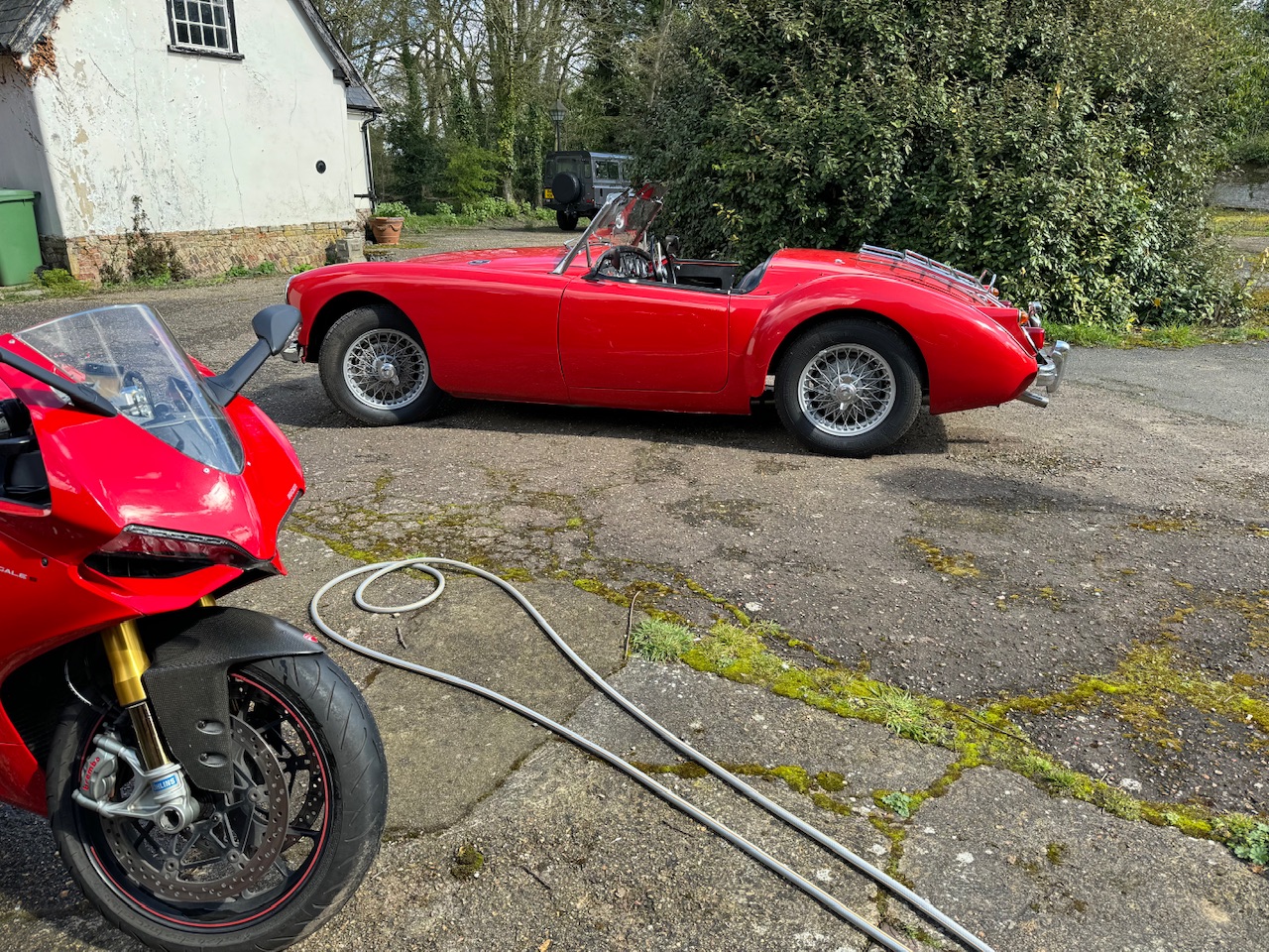

  7. I just took out 1956 MGA I have which didn’t turn the wheel all winter. Battery wasn’t disconnected. Battery is 8 years old. No problem there…
  8. Yes, but I did check it with a multimeter to confirm it was the battery that had died during hibernation.
  9. I’ve found car batteries to be more robust than is the case for motorcycles and AFAIK there will be no draw on the battery on your MG. Any chance of a picture of the MG?
