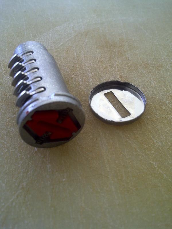

  9. There aint no lube inside the barrel, just little bits of metal....WD40 will do wonders to sticking tumblers and springs.....:upyeah:

  10. WD40 = no
    Please use this for rusty bolts.
    Always keep locks dry, use graphite lock lubricant.
    On switches use electrical contact cleaner.
    WD40= light oil and white spirit, save a fortune and make it yourself :biggrin:
  11. Aircon...youre far to clever for me....OK no WD40 lets use the graphite stuff! just wanted to point out that there was no built in lube!
  12. Graphite grease for locks yes, but the electrical contact cleaner should be used with caution. I used some on the switchgear of my old SACS GSXR and the buttons slowly turned from a nice satin black to a horrid powdery white. It was to agressive for the plastics used.
  13. Not graphite grease, use graphite powder for locks.
