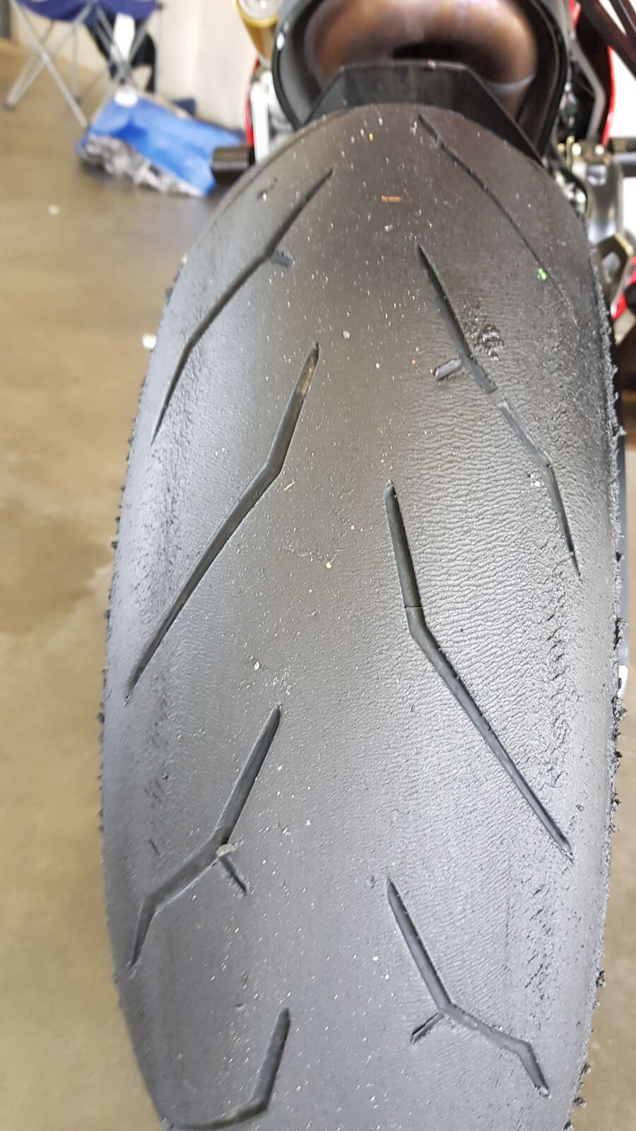

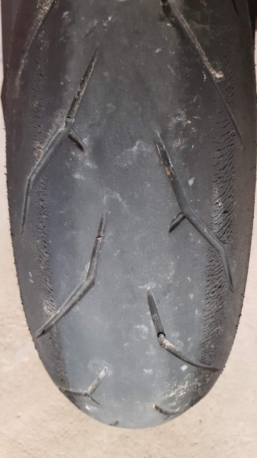

    I have just started track days on my 959 and following Silverstone the standard Diablo Corsa looked like this.
    I have seen a few threads saying that the new surface at Silverstone was particularly harsh on tyres and read the life at lean guide on tyres pressures but I’m still a little confused.
    The cold pressures were set to 31 front and 29 rear. - previously at Cadwell I had set them to 32, 30 on a very hot day and let a little air out when seeing the pressures hit 36 hot.
    At Cadwell I didn’t see the same tearing - is this down to the new surface or the cooler weather on the day? It looks like slight hot tearing to me indicating my pressures were too low but that contradicts the opinions on some of the other threads I have seen.
    On another note - I have another couple of track days coming up - is this tyre still ok for another couple of full days?
    I want to get the wear out of it as it hasn’t done many miles - once it’s done I’m thinking of moving to a Supercorsa SP - will this be ok to mix with a the standard Diablo Corsa front?
    Thanks - Steve
  2. Try dropping another psi or two and then (if that does t work) back off the rebound a click or two.

  4. Thanks guys - I just checked and 100% are at Donington on Tuesday so I’ll pay the £60 and see how it goes.

    I had a great day at Donington, the weather made it exhausting but the track is a blast - loved Craner curves - in fact pretty much every part of the track except Melbourne Hairpin which I never felt I nailed.
    Had my suspension setup by 100% - only a few small tweaks needed - backing off a little on the preload at both ends.
    Dropped the tyre pressures right down as the day went on and it cleaned up nicely - now debating whether I can get through Cadwell next week on the rear or to get it swapped out.
