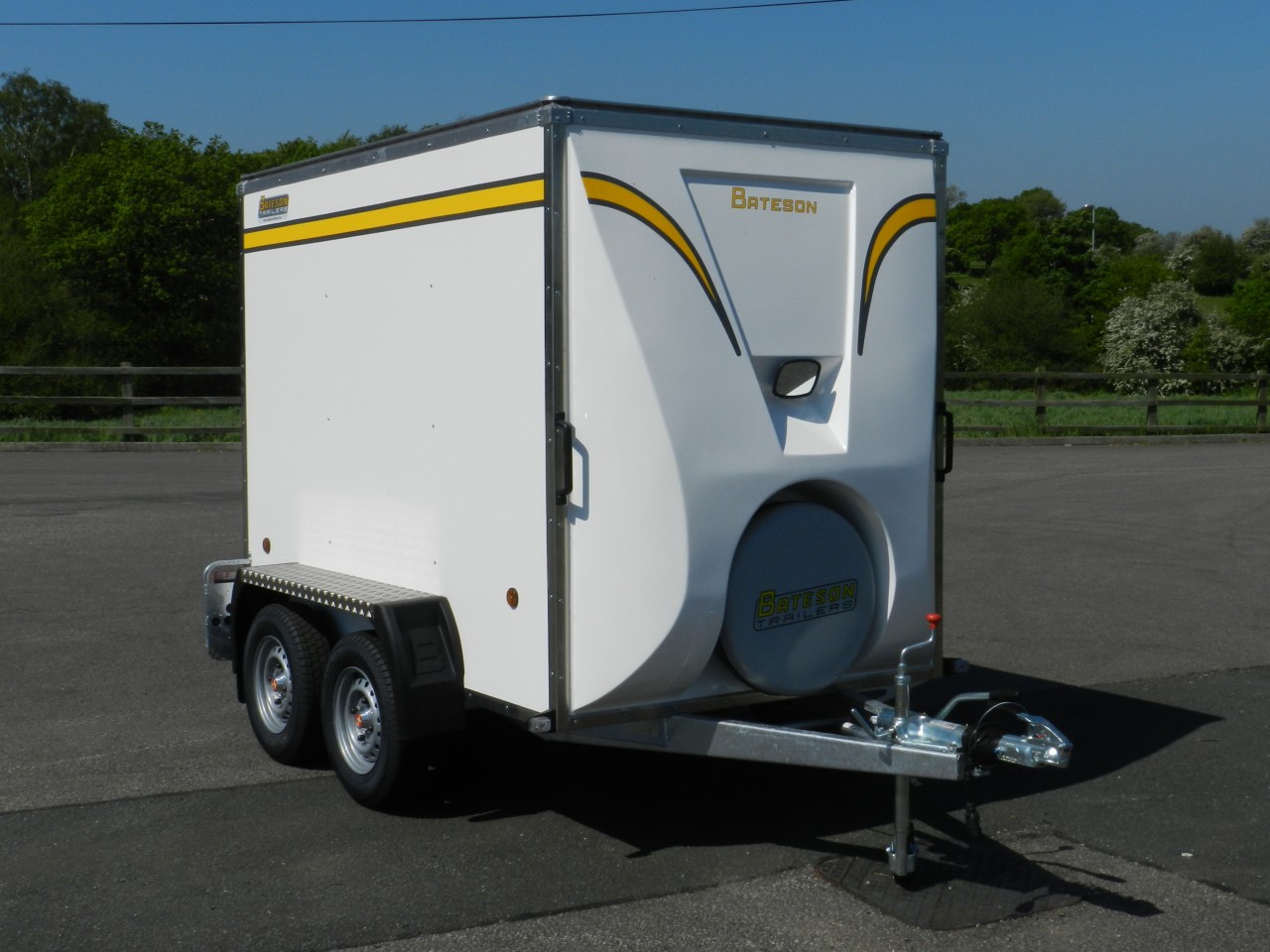

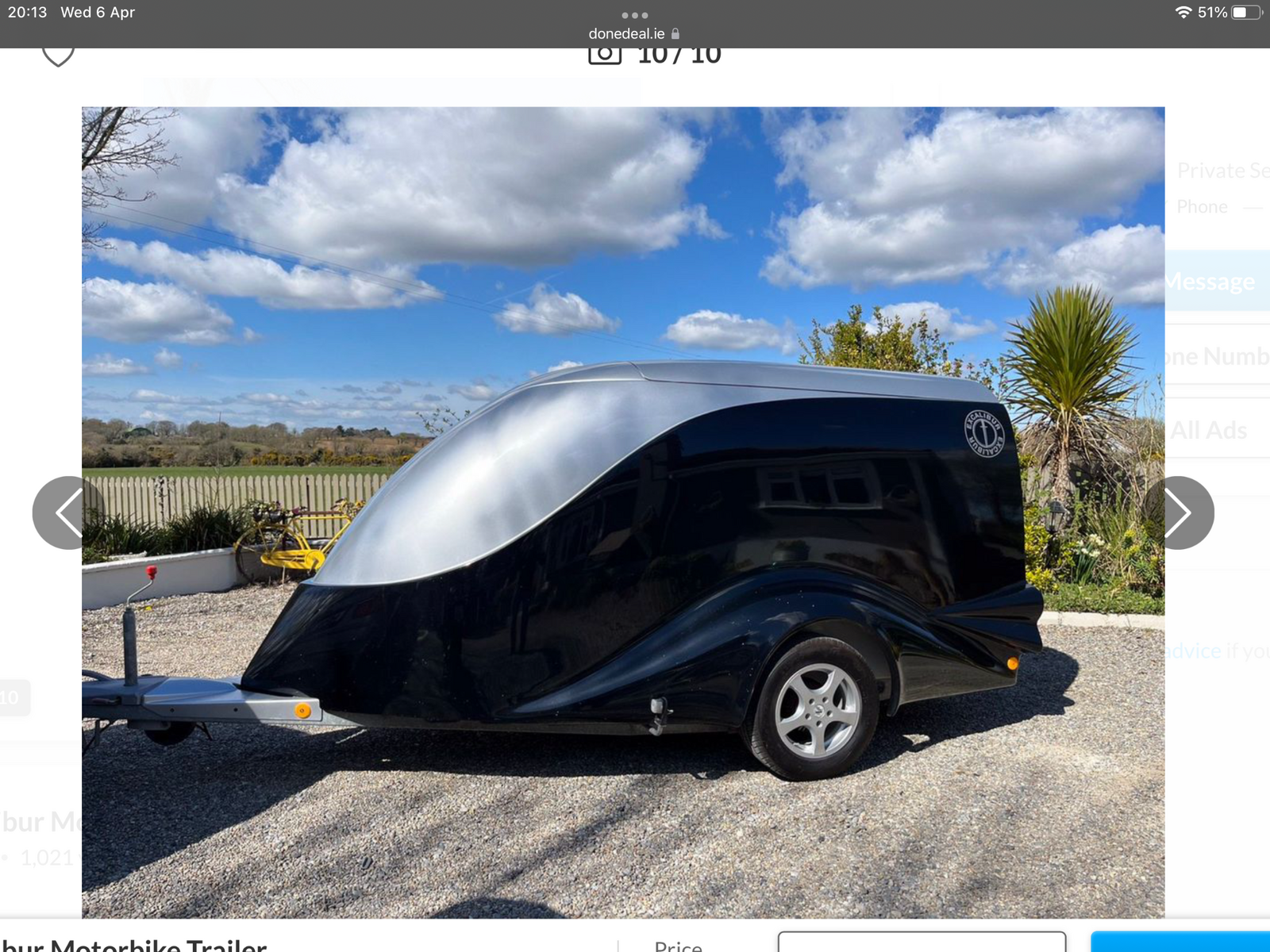

I have a Bateson 240V. It has been towed to France and other trips to Italy. Stable, secure and plenty of space for bike and spares. It can take 2 bikes too.Normal height people can stand upright, unlike some low roof vans. It is braked and has tie down points etc. New tyres. It is available for sale, if you decide to go the van route. Details of sizes here. https://www.ebay.co.uk/itm/184314866755 Mick

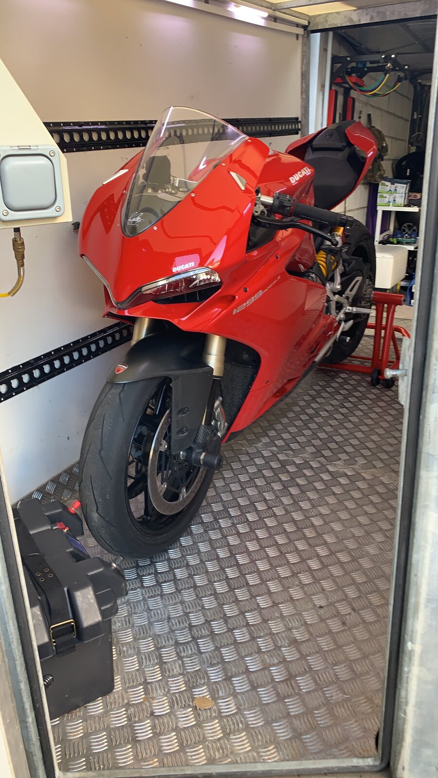

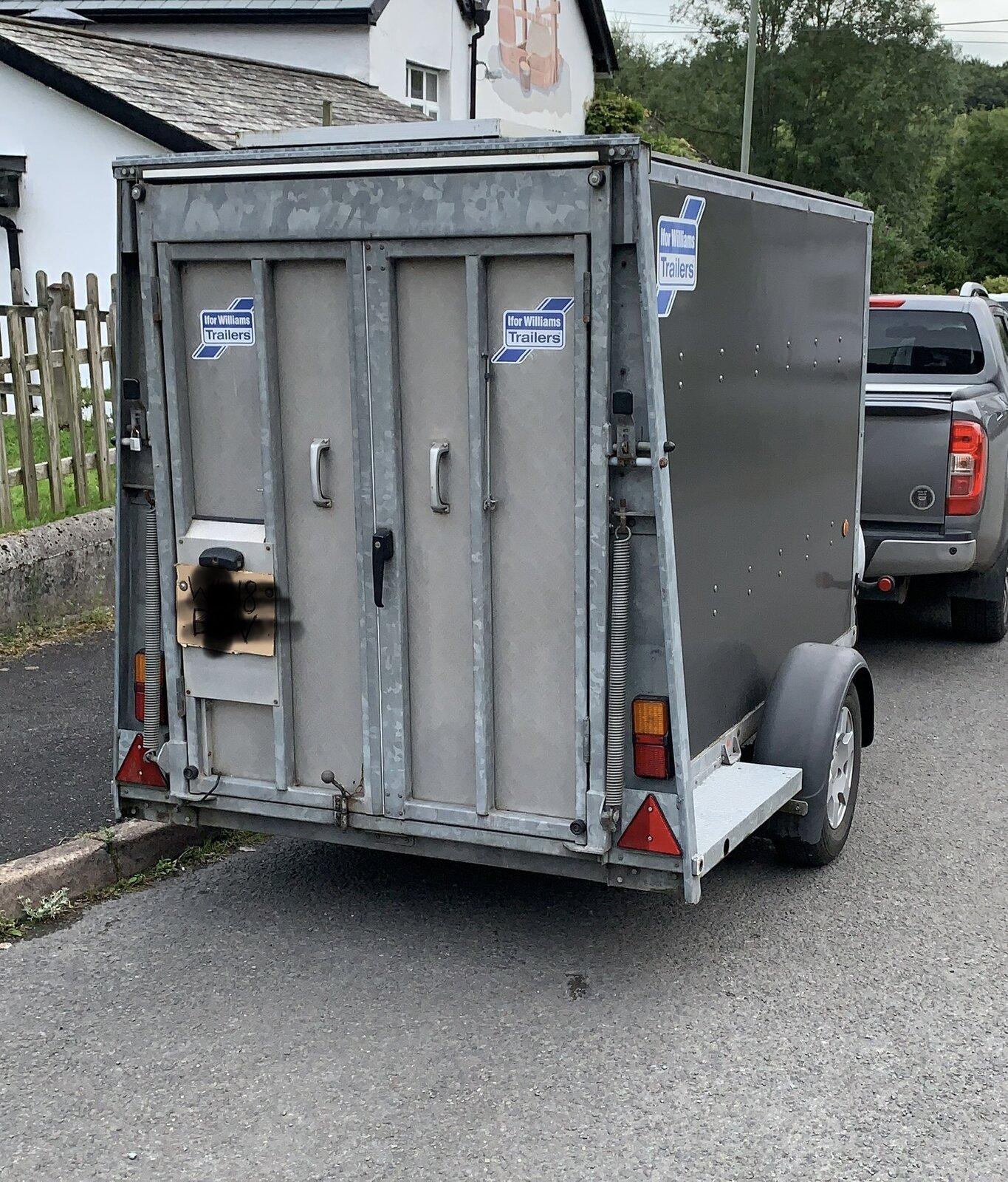

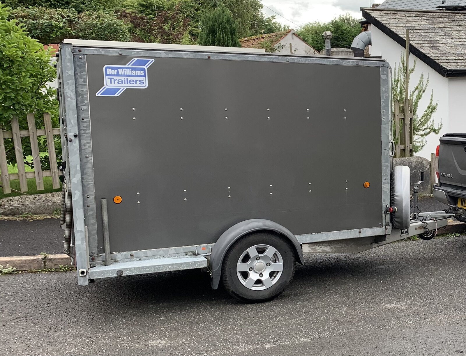

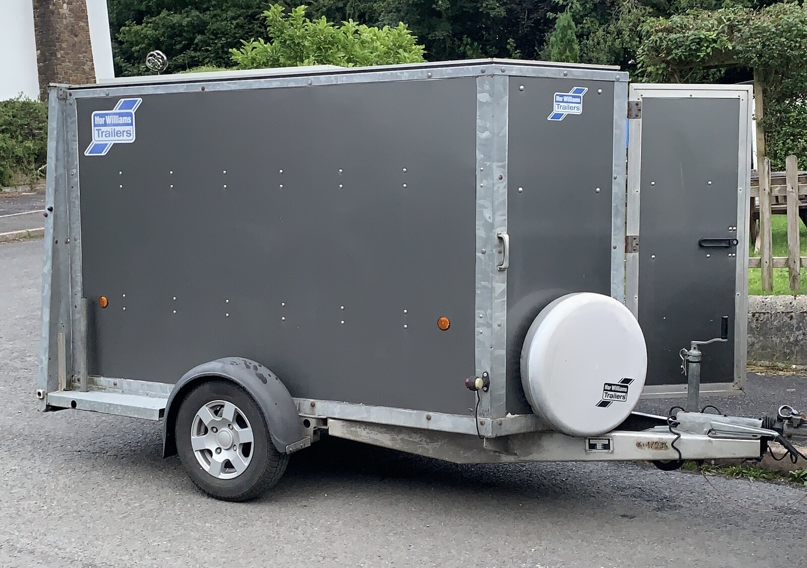

I’ve got a little Ifor Williams BV86? and it’s an ideal size for a single bike. It’s not super steady on the motorway when you get up to speed, but it’s not too bad. It has a solar panel on the roof that charges a battery to run LED lights and a little compressor. Would recommend one. There are very often various brands of covered trailer for sale on FB marketplace. Also the group ‘Trackday addicts’ sometimes has adverts for fully kitted trailers.

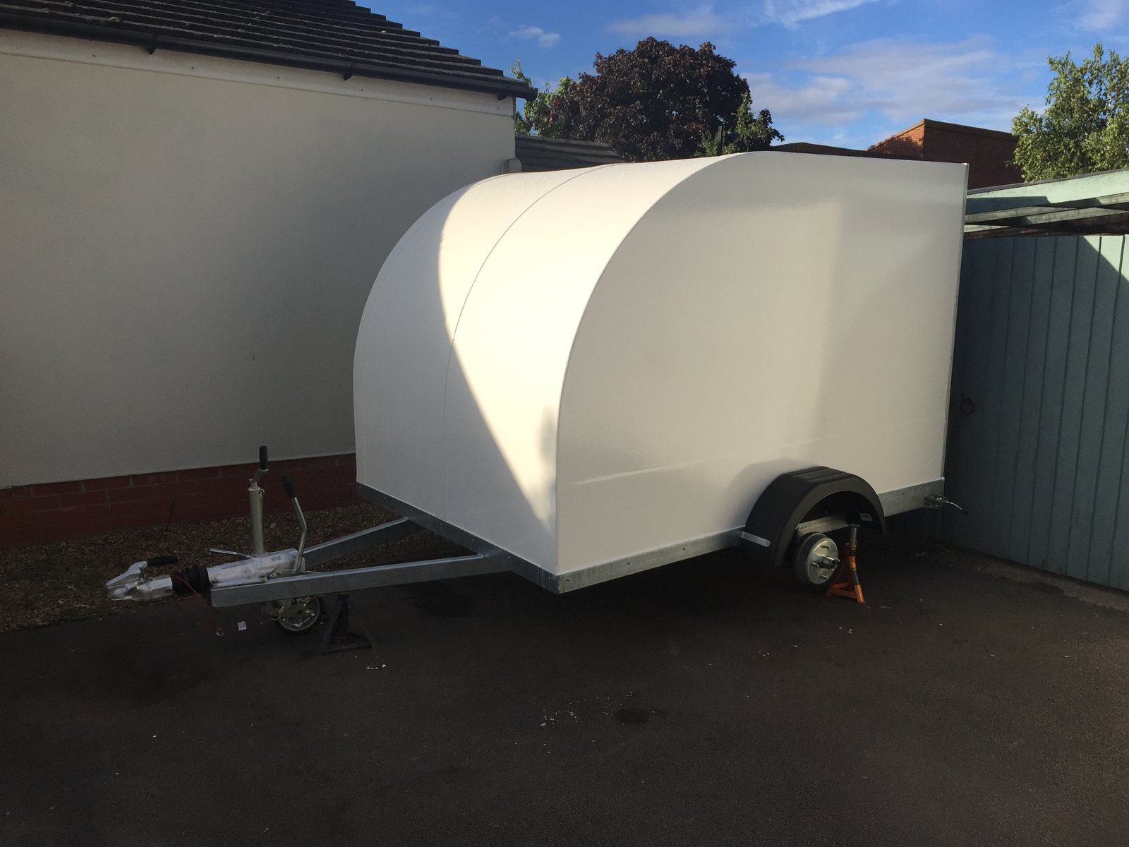

One of these. Make sure it’s twin wheel and braked. I bought one for 600, used for 3 season and sold for 600. Kitted it with some shelves and hooks and used it to sleep in trackside when racing. But be careful: pikeys love to nick them!
