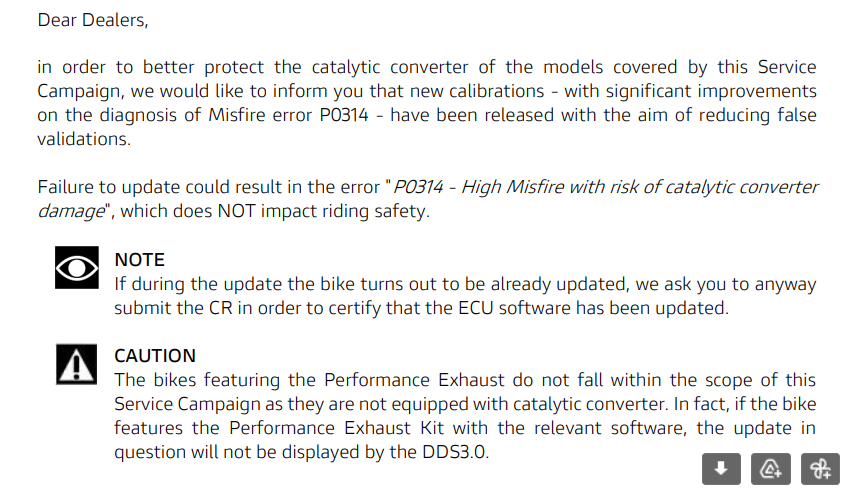

    Awesome! Count me in!
  7. This update is to better diagnose misfire which ultimately protect the catalytic converter and reduce false P0314 codes.
    I am hoping it improves the cold starts of the motorcycle as well as I have been having rough cold starts. Ironically when going to the dealer to upload the new CR239 update they cannot find it although the recall is active for my VIN number. So waiting to hear from Ducati as to what to do next.
