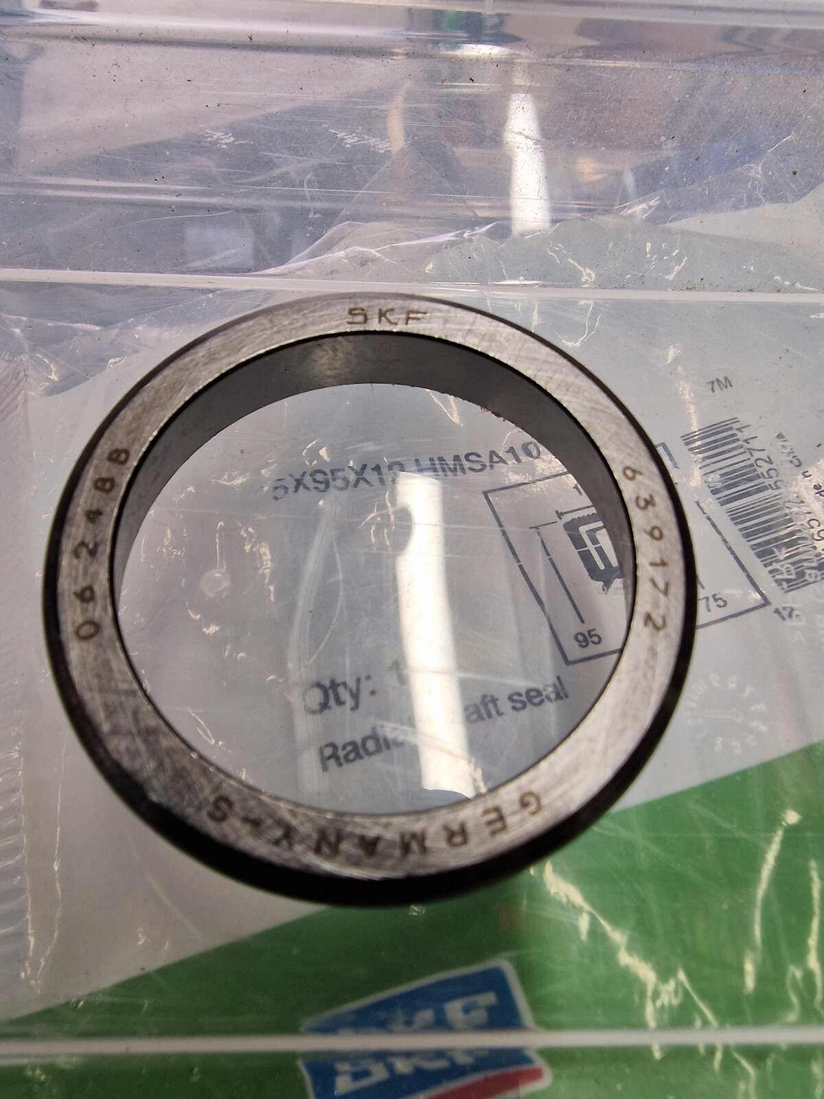

  14. So here's the SKF I had in my headstock 16856314661975196439046510511967.jpg
  15. Only the outer race shown here, obviously
