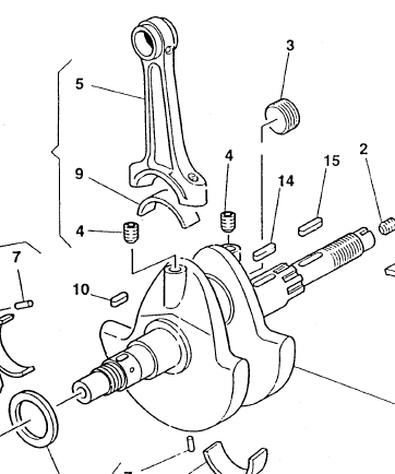

  16. I was advised by Ducati Italy that my bike was produced between 1996 and 1997 in a total of 510 units (60 units in 1996, 450 units in 1997)........they coudn't be more specific, but according to an HPI check and the DVLA, it was manufactured 1997 and first registered July 97............as to whether I have a steel or ally plug, I can't say, as the oil changes didn't produce anything significant other than little silver pieces of silicon sealant.
    I spoke to the PDI guy again and he is adamant the workshop where he worked used a small dentists mirror with an extended handle through the screen filter hole while shining a maglite type torch onto the mirror.........he said there was just enough room to see if it was backing out........I simply can't say if it is possible or not.......see pic below....is it No.3?
    If it is, I can see how some people dispute his claim.
  17. Yes, number three. I'm not sure it's quite the problem some claim it to be, yes, it does undoubtedly happen, but I'm sure people would have documented it more if it were very common as people love to bang on about reliability with ducatis, so if they self destructed every 20,000 miles we would hear about it all the time. Monsters sold well, and it's common to see them with 40,000 miles or more - I've heard of a few passing 100,000 miles.
