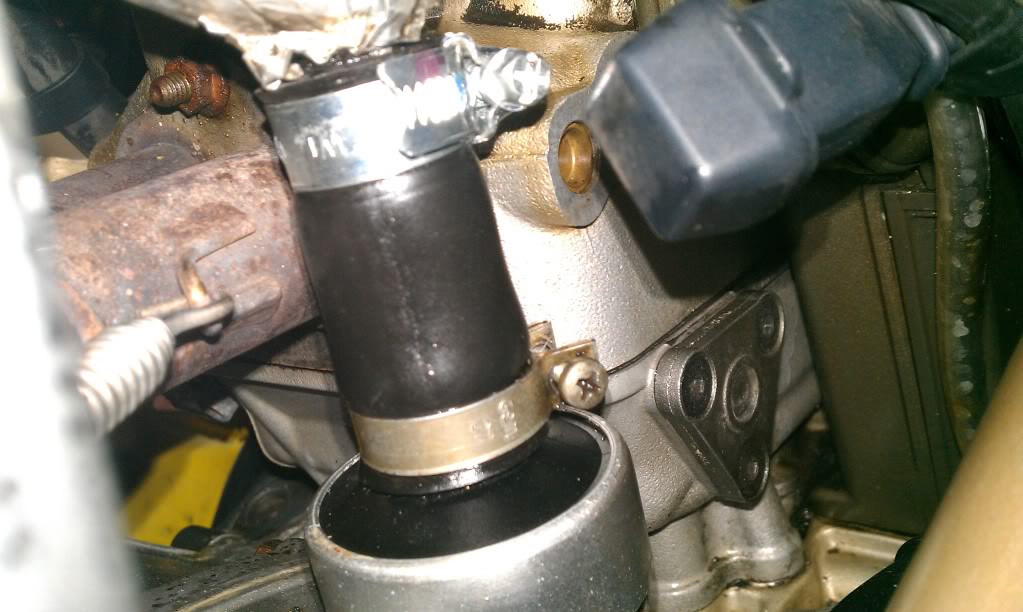

  1. I have just returned from a 2 hour trip on the 748 and noticed oil all over the back of theengine/gearbox, it looks like it is coming from the crank cases breather, isthis normal for a duke???
    If so is there anything I can do to rectify it. I’m guessingthe system may be blocked.

  5. I haven’t over filled it with oil. It does smoke very lightly when it’s cold and ticking over but I would say that it looks more like condensation than oil burning. Neither I nor my mates have noticed any smoke when its being ridden.
    I’ve just done a bit of research and found an article that was talking about the reed valves in the breather system and how they can get blocked with oil at high rpms and therefore can’t drain the oil back into the crank cases fast enough resulting in oil over the back of the engine.
    http://www.ducati-upnorth.com/tech/breather.php
    Considering that I have just been out for 2 hours ridding it hard trying to keep up with a mate who is on a zxr10 I thought this could soundplausible?
    I’ll havea look for a spilt pipe and oil in the airbox tomorrow.

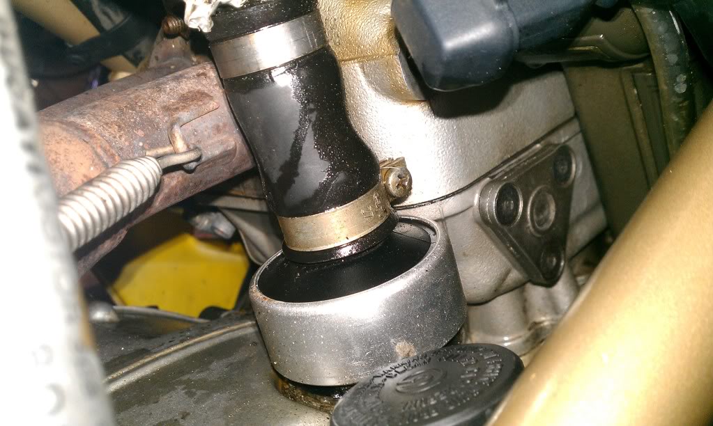

  13. I couldn’t do the compression test today as my tester only goes down to m14 but I had another look at the smoke on tick over and I’m convinced that it is just condensation as it looks white and you can see the droplets forming in the tail pipes, this clears after a few minutes of running.
    I also took the crank case vent pipe out, I could not see any signs of a split or cracks but I found that the top hose clip was loose so I replaced that with a jubilee clip. I’m pretty sure that the oil is coming from this loose clip and/or the holes or thread in the very base where it screws in to the engine case (as suggested by nelly) as I can see fresh oil in the small holes.
    When I took the tank off I checked for signs of oil deposits but the air box is spotless apart from a very small amount of residue on the underside of the tank. But I’m guessing that as the tank is yellow any amount of oil/ dust will show up easily.
  14. I think you've pretty much cracked it tbh. That's pretty normal looking and a new jubilee clip and a reseal of the breather into the cases cures it. Just an aside, have you tightened the lower clip since you took the photo :wink:
  15. Good news then. Just out of interest, your top breather picture shows what looks to be a split just below the top jubilee clip but it must be a thread of rubber or something instead?
  16. Nelly: the photo was taken just before I tightened everythingup. I never resealed the breather into the crank case as I could not move itand did not want to damage anything, I’ll try it like that and if it needsdoing I’ll take it apart again, does it just unscrew or pull out of the crankcase?
    Chris I see what you mean about the picture but It’s not asplit, it must just be oil or some sort of mark because everything was wipedclean and checked.
