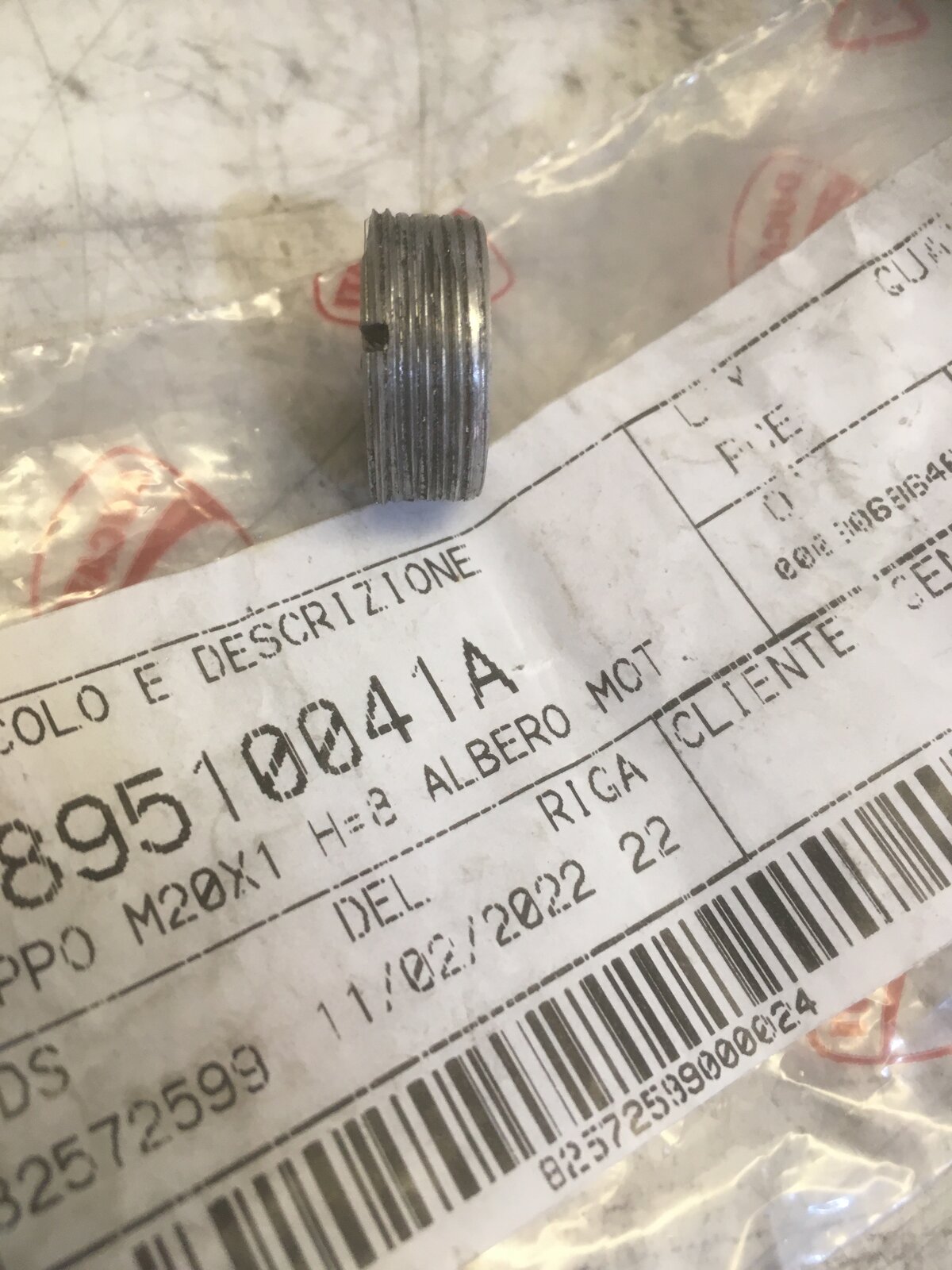

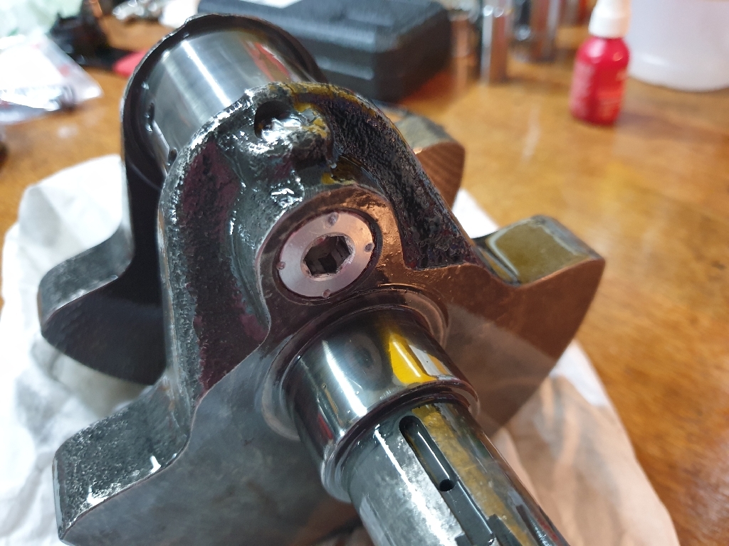

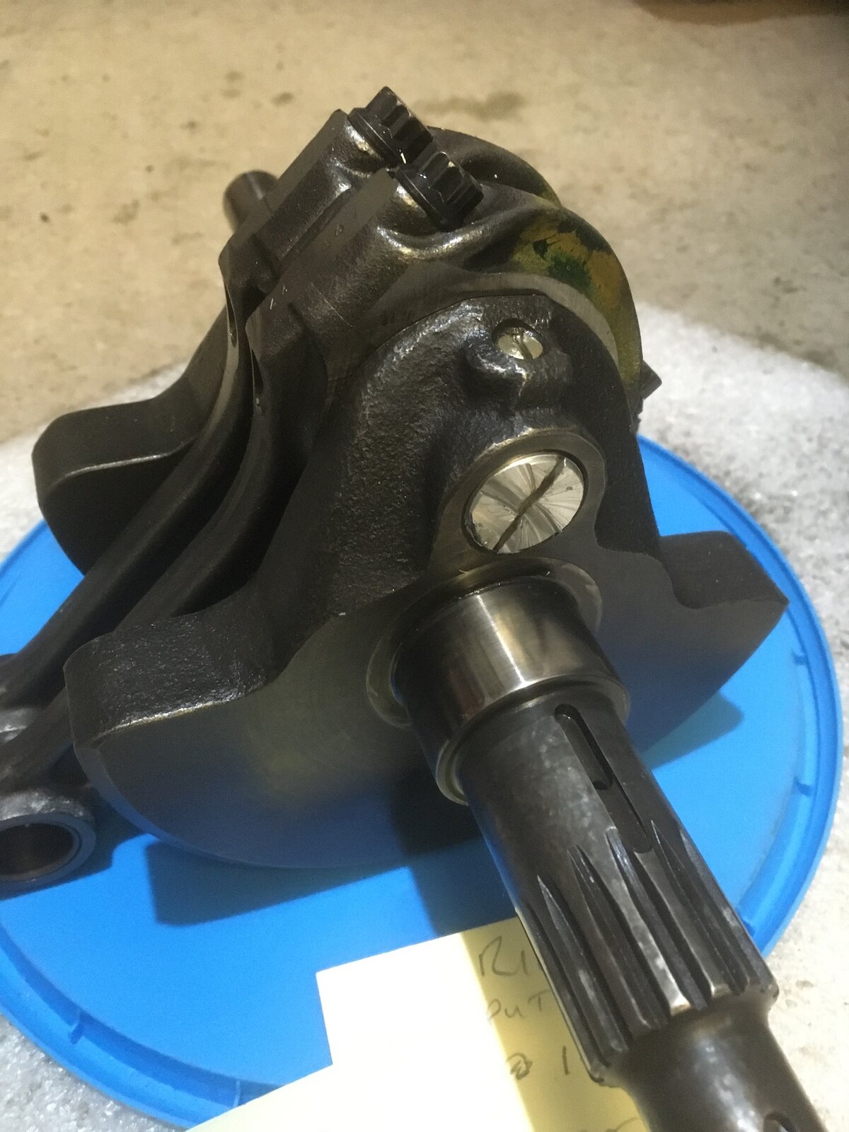

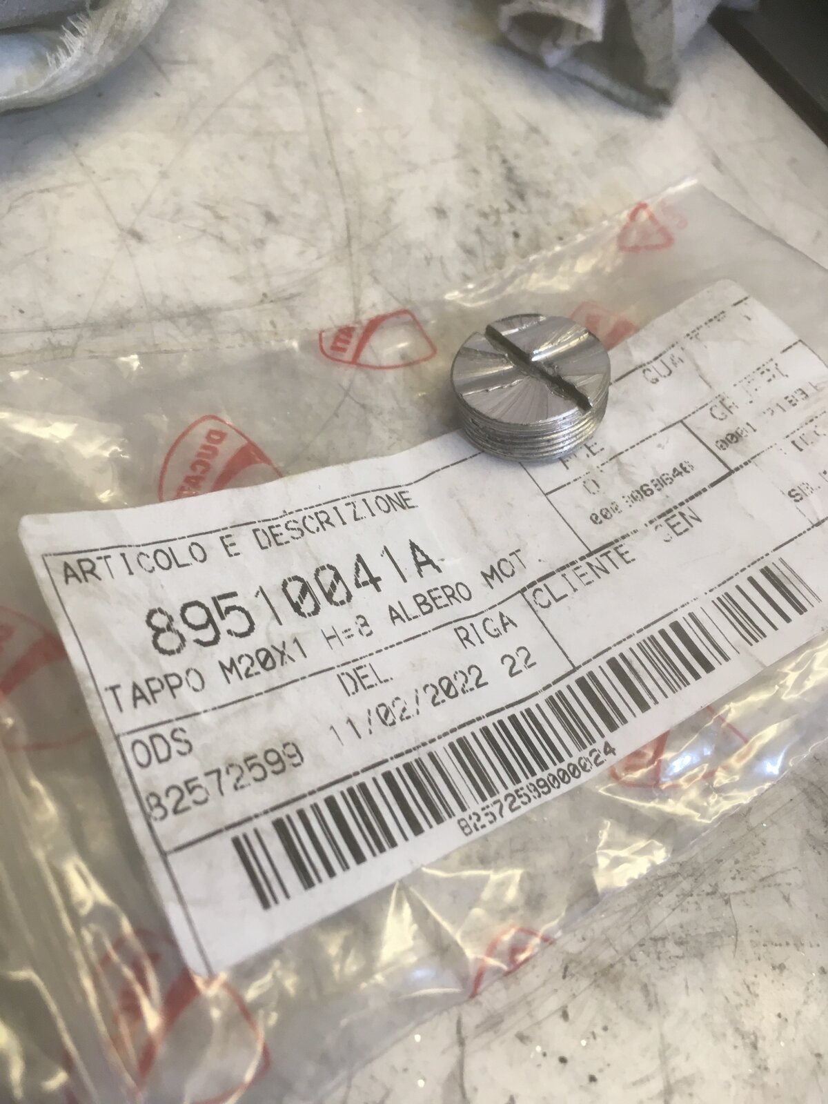

  8. If you’re splitting the cases don’t forget to carefully check the crank oil gallery blanking plug, on mine it was loose enough to rotate with a finger and the threads were worn down with the rotating forces. This was a 94 build engine and only a couple of shards had previously been found in the oil strainer
  9. Cheers, that was one of the reasons for stripping it down, it hadn't contacted anything but was loose.
    All nicely secured now.

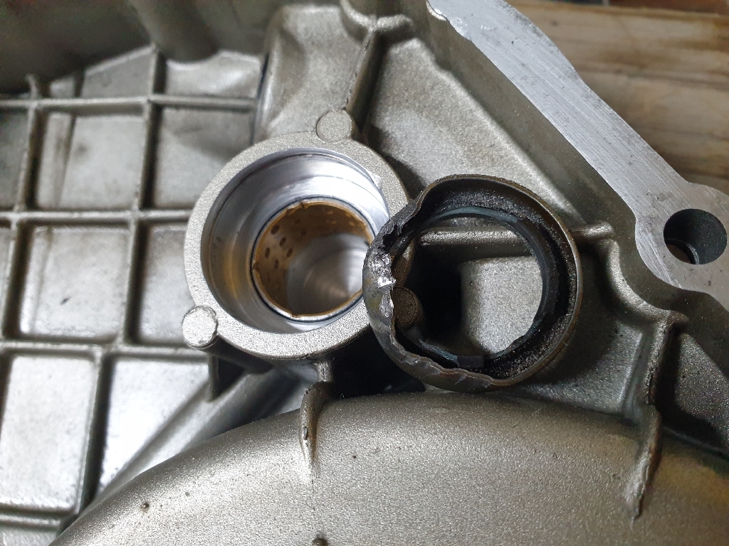

  10. Well I got it out, it wasn't easy though. It wouldn't budge so I ended up using a carbide burr to thin the steel ring then I was able to fold it in and eventually get some locking pliers on to lever it out.
  11. well done, it's not always plain sailing removing a blind oil seal or bearing.
  12. Well done. Remember to remove the burr where you have bruised the casing at about 2 o'clock trying to lever it out, before you refit a new seal.
