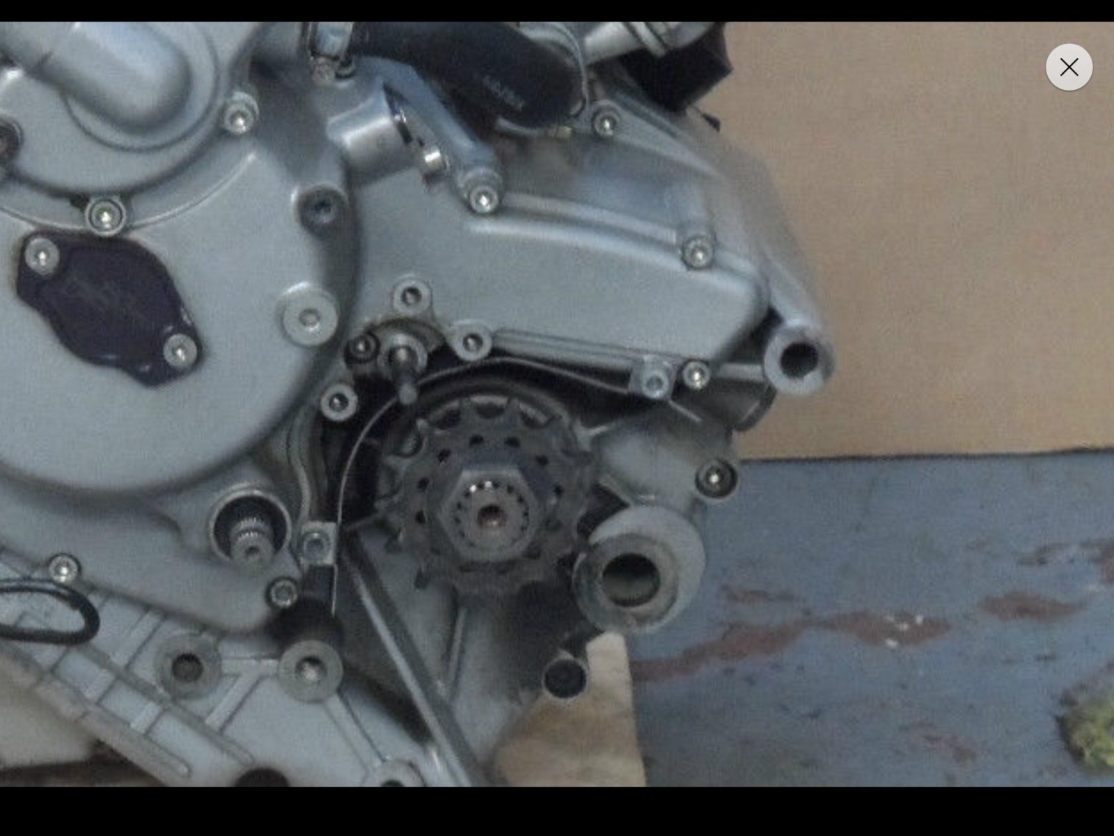

  1. image.jpg Anyone know where I can get a crankcase saver for my 999 ? Similar to one in the pic

  4. Thanks, ordered one from the ebay link. Seller says with small amount of filing it will fit the 999

  8. Prevents case damage from chain snapping as mentioned but also damage caused by a very slack chain. I have seen a 916 case worn away to the point where two grooves were cut into the case and oil had started to seep out, all caused by a aforementioned very slack chain. Up to that point I had never seen that happen.
