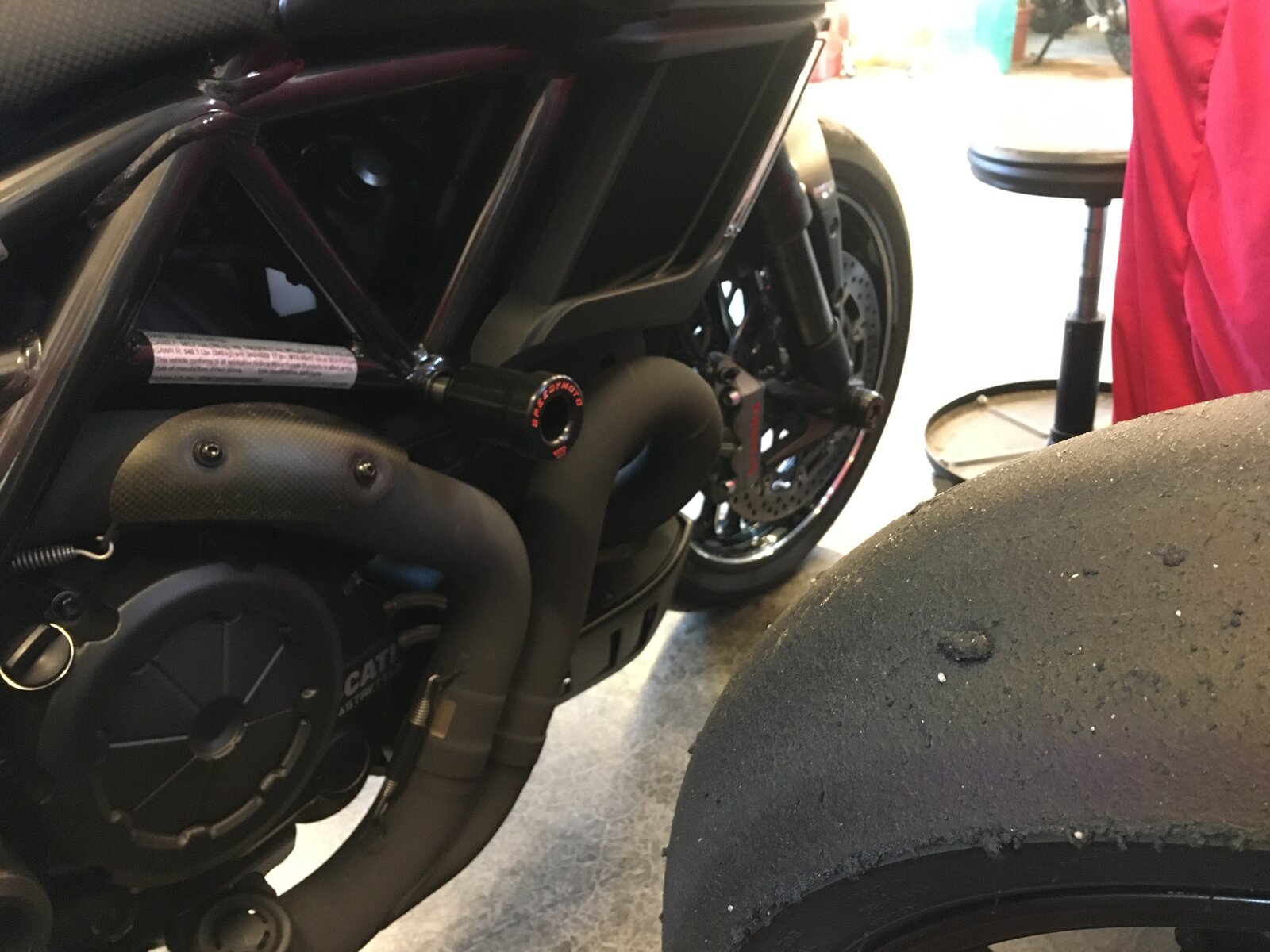

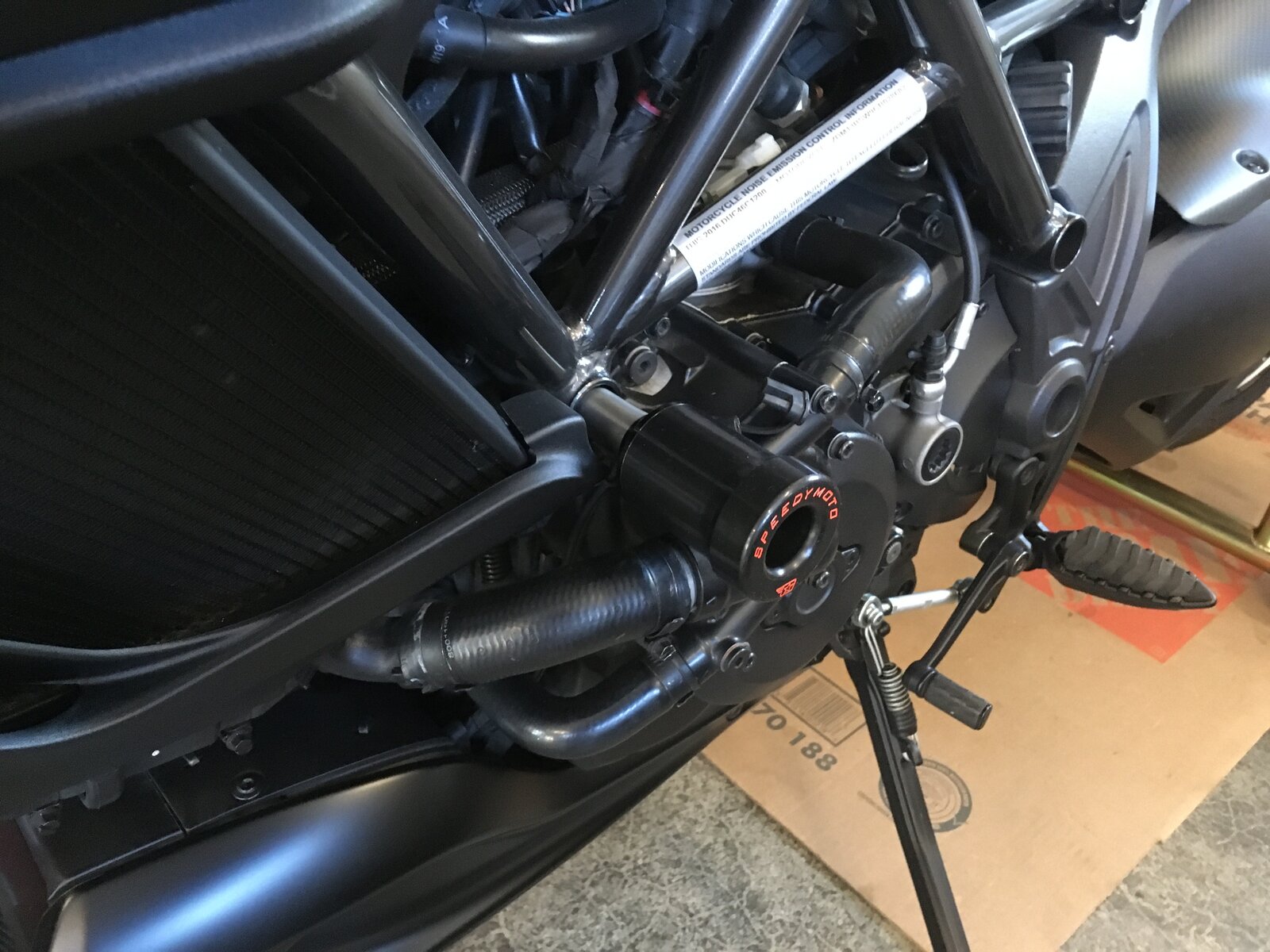

    I just put some SpeedyMoto frame sliders on a 2016 Diavel. I've had good luck with them on a couple other Ducati. They seem well made and install pretty easy. These came with no instructions so it took me a bit to figure out which one went on which side. After getting it wrong the first time, I swapped them. They seem to blend in pretty well, but still extend far enough out to protect the key engine parts.
    Will help to have bar end sliders and maybe front axle sliders. The rear axle sliders only protect the left side - the right side is well within the width of the wheel.
    r-
    Tom C.

  8. I think the Speedy Motos will provide some protection for the engine, frame, and other parts by giving the bike a little prop up while it's sliding. I expect that the side air intakes and possibly the tank would take some damage, depending on the accident. My intent was mainly to reduce the amount of damage to engine components. I haven't tested them yet (and would prefer not to).
    r-
    Tom C.
