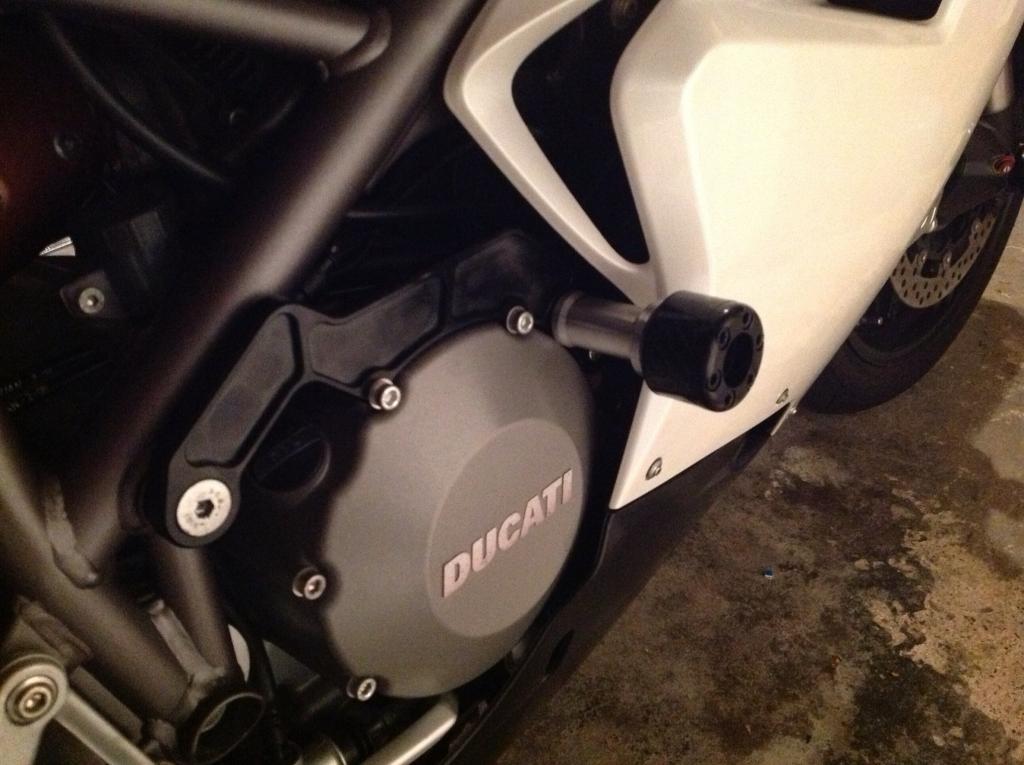

  14. image.jpg I went for a set that stick out from the fairing but don't require you to a cut a hole. They have bars running straight through the frame and have braces that also support. I haven't crashed with them yet but the year is still young!
