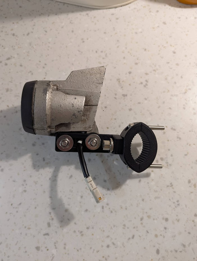

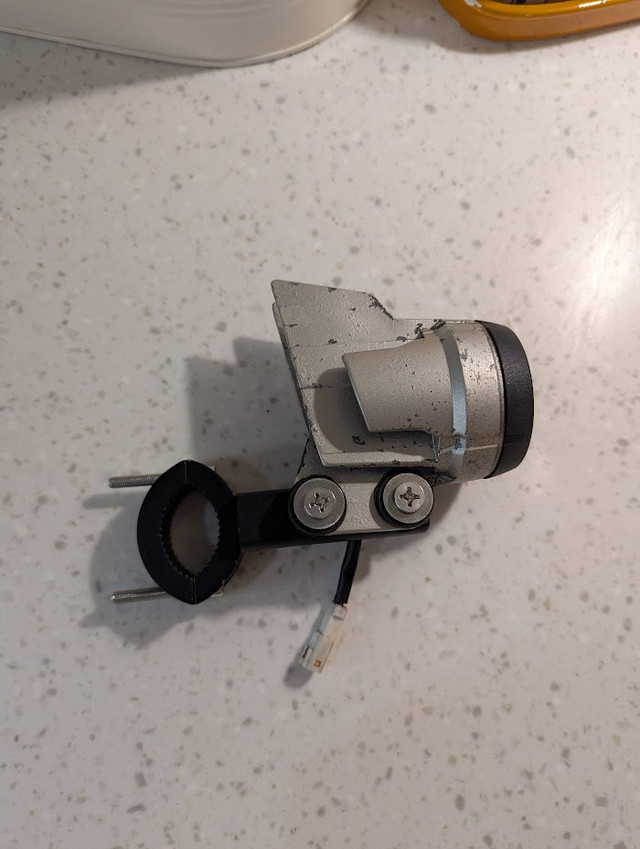

  8. So this is promising. I've got the lights attached to the bar mounts which should just go on the crash bar without too much issue. If it all fits as expected, I'll play around with spacers to make sure lights are facing the right way and then swap out the bolts for some nicer black ones. Just need some slightly warmer weather first!

  10. Yeah I imagine I will, got lots of spare 12v wiring so shouldn't be an issue. I'm hoping to mount it in a similar ish place to OEM so fingers crossed it'll just stretch.

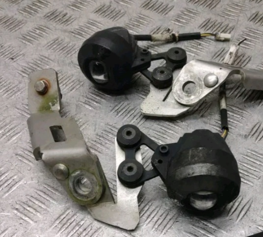

  11. If anyone has a set of OEM spot lights brackets for sale I might be in need of some If the brackets that come with the 2nd hand lights I've bought off ebay don't fit as they were originally on a 950.
    TIA
  12. For which model of aux lights? There are two versions for the Multi over the range.
  13. I've bought the smaller black version not the silver 1s
  14. Brackets look completely different to the silver mk1 version spotlights I fitted to my MTS 1260. Effective but something of a pain to fit as the bodywork needs to be removed.
