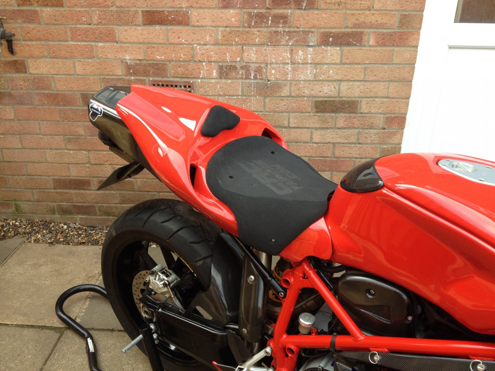

Finally got round to fitting the crc tail unit. Very lightweight and fits well, I would recommend this item, although it's not for everyone, I quite like it.
Looks good, slightly different from the norm but still in keeping with the bike,is the seat material suede/alcantera ? quite like the subtle logo on it as well ....just had a look on their website they are quite reasonably priced....hmmmmm.
The seat material is a suede finish and fits onto the tail by 4 dzus fastners, Im guessing its gel underneath and then that sits on polymer base. The actual tail unit is exactly the same as a mono apart from the sides sits slightly lower down the subframe, but not by much. Reasonably cheap, but then you have to get it colour-matched.
Nice . Do you think it's long enough to cover rear subframe on biposto ?? Different but I kind of like its sweeping lines
I don't think it will cover the biposto frame, as it only just covers the mono. Unless you get a mono subframe

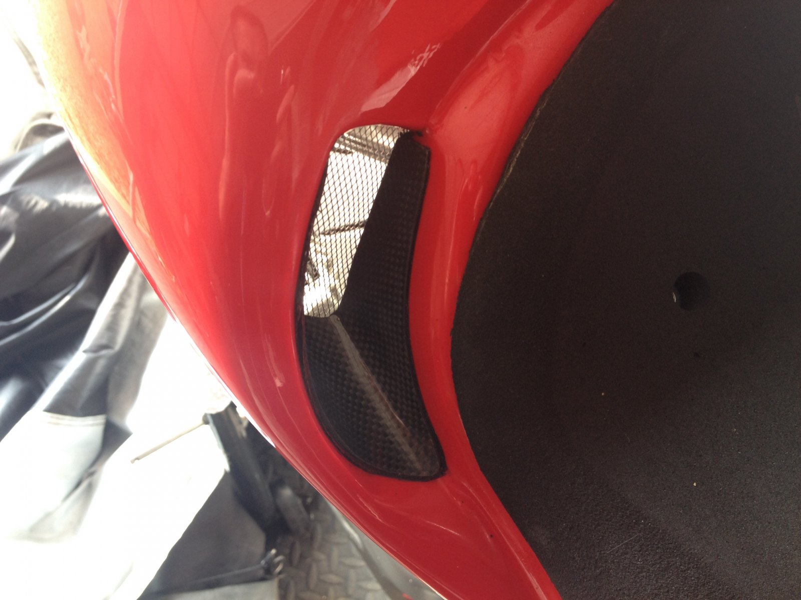

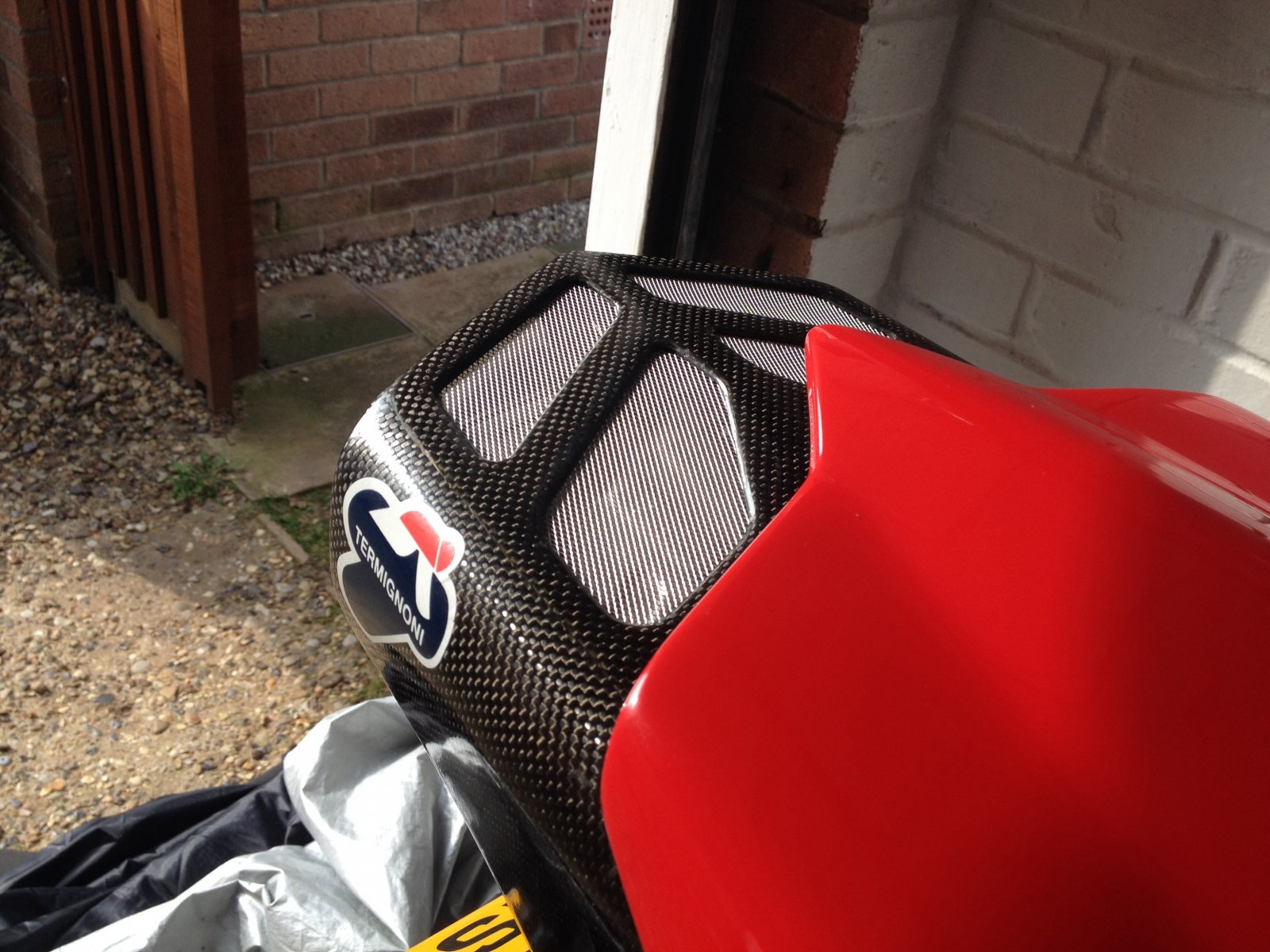

Just made some carbon inserts for mine a few weeks back on my night shift...also finally vented the carbon shroud...think that's it for the arse end.

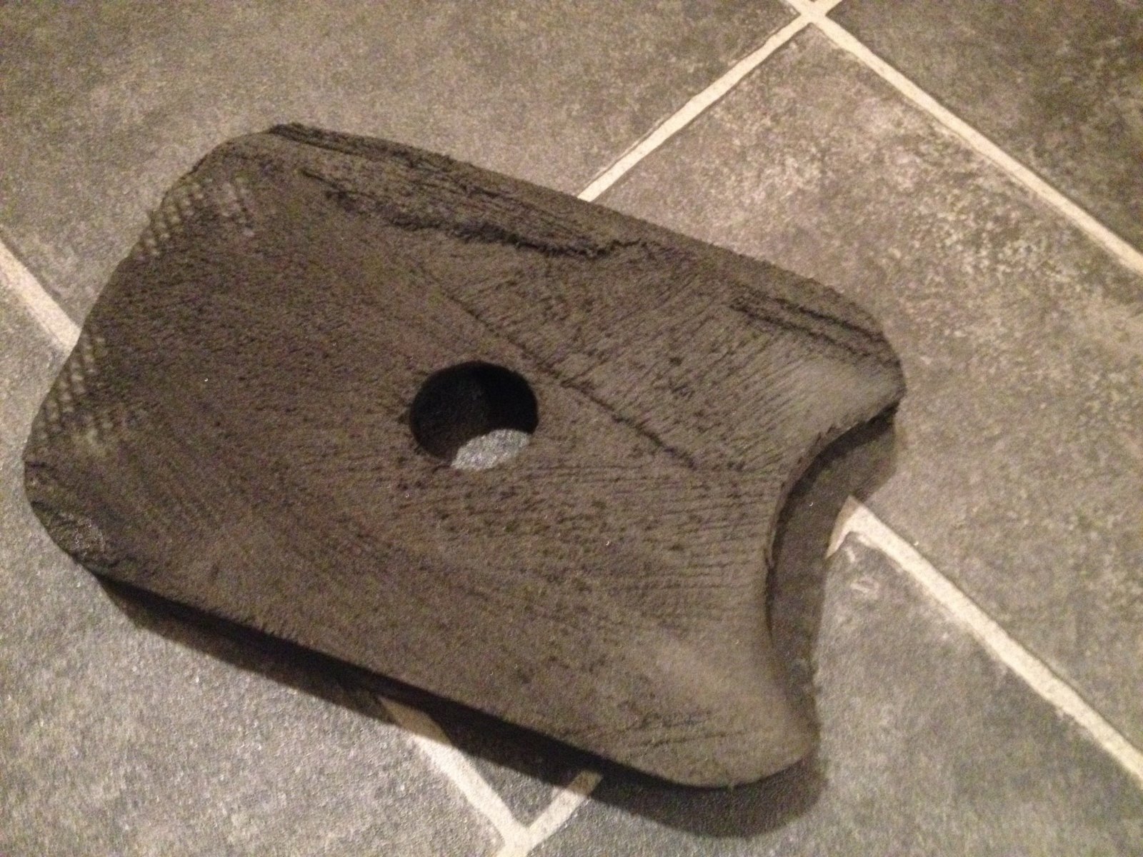

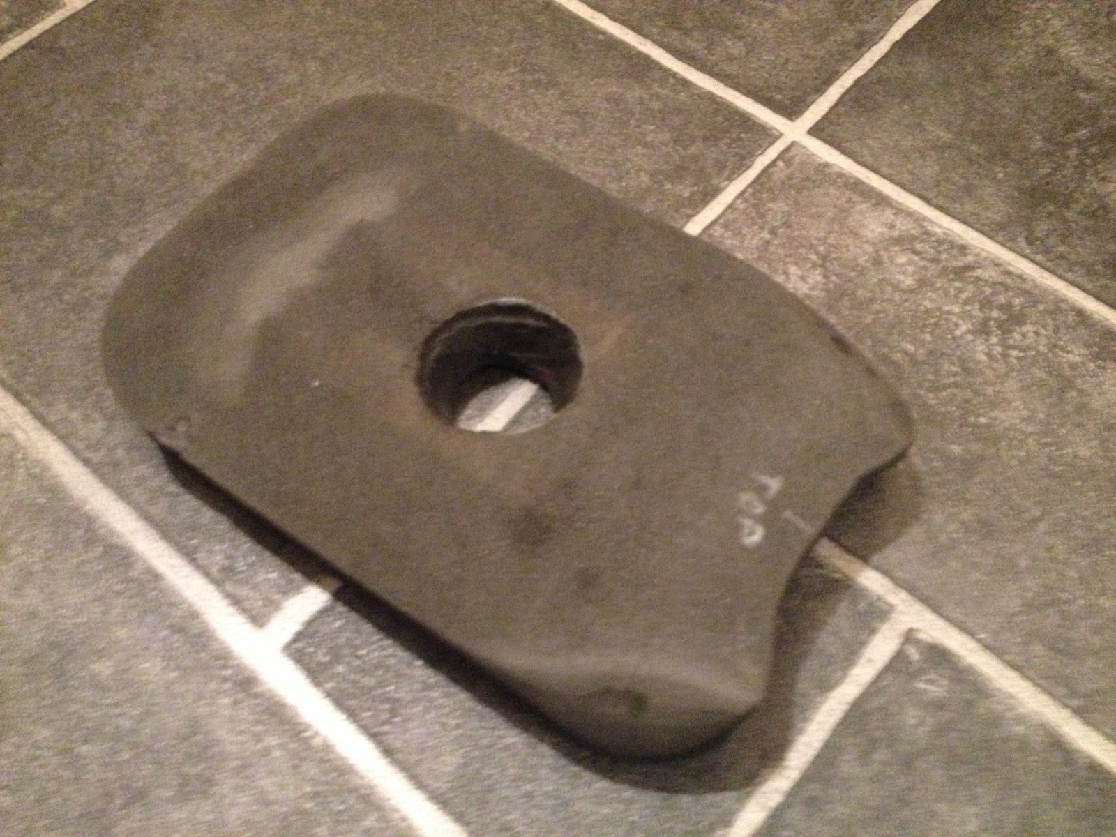

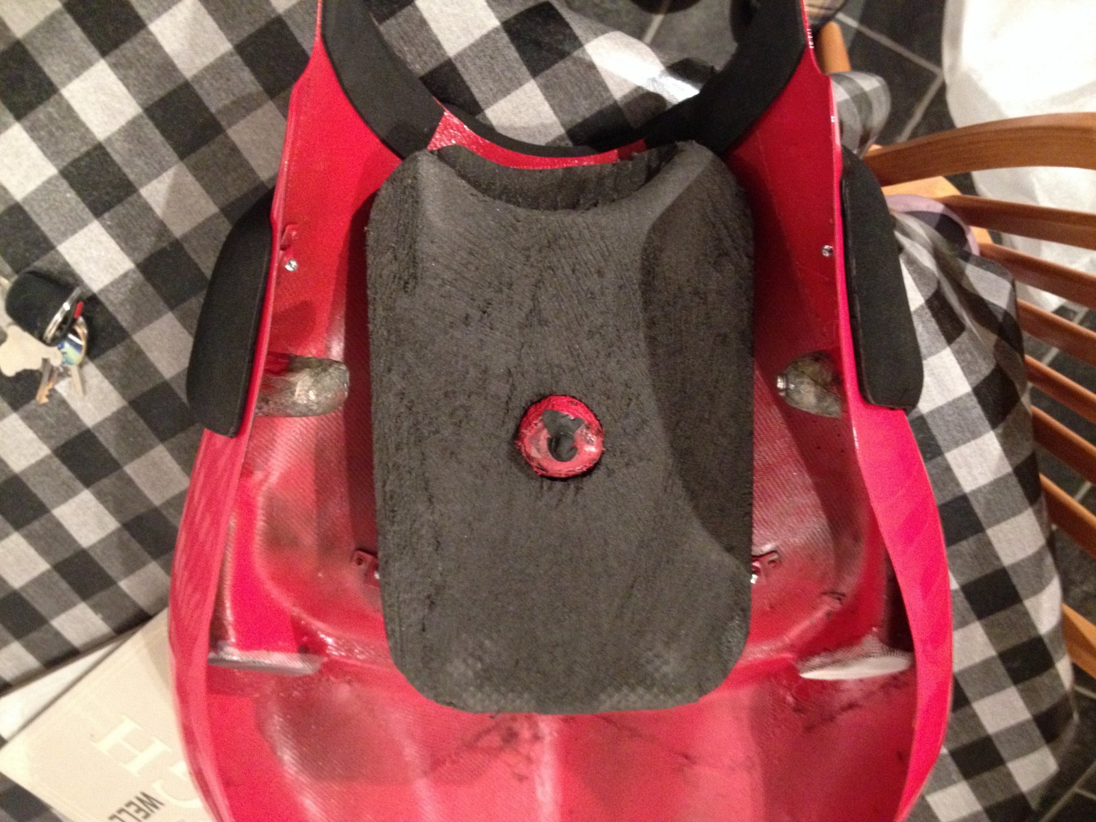

Sure...pic.1. Shows the top (circular edge is the bit that sits against the tank, or the front) pic.2. Shows the underneath and last pic sat under the tail unit. I bought buoyancy foam as it's very firm but has some give in it. Size of the foam block is L29cm x W19cm x D4cm. This block actually came in that size and I bought of ebay for under a tenner. Firstly I cut the hole in the foam where the large middle lug under the tail is. I then took a bit of the sides at the front areas on the topside as that is the curvature of the inside of the tail. Then I marked on the foam at the top front the curvature of the seat and cut that off. You will have to make a bit more of a recess on the underside for the tank. Then I began to shave off the bottom, more at the rear as the heat shield angles up and just kept test fitting until I didn't have to force the 2 side lugs to screw into subframe. Basically concentrate on the inside curvature of the tail unit so it sits reasonably snug and get the topside of the foam to mimic it. Then worry about shaving off at the bottom at the end. A bread knife is good to use to whack larger bits of and then you can wet sand to neaten up. Remember you can't see this foam so I wasn't too precise and the idea is to soak up your weight on the road, bit like a damper. By doing that it takes all the stress out of the side lugs. And it's way more comfy than OEM. Sounds like a lot of work but it isn't, just shape, test fit, shape, test fit and you will be fine. Don't be too precise...it's just meant to soak up a little weight and not to carry all your weight.
