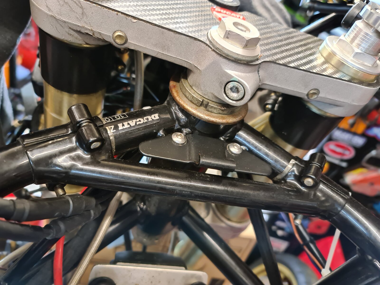

  6. Thanks for the pics .would you say these are necessary.

  9. I got one to fit to mine but it lands right on top of the two frame identification plates and their pop rivets so it hasn't been fitted yet, any one else had the same issues.?
  10. Not the same, but similar - the upper rear corners of the clamping screw bosses caught on the front edge of the tank. Moved tank back as far as possible (even elongated slots in the hinge base plate), but could never get clearance.
    Also, despite having tried 3 braces, was never impressed with the fit between clamp and frame tube - angle was never quite right.
    Brace now lying in a corner somewhere.
  11. Yes, see my pic above. I put some clear plastic in-between, which probably takes a little away from the strength, but stops the plate getting worn. Its not been a problem till last MOT where the guy pointed it out but passed me anyway
